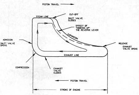

Here is Figure 4: Idealized indicator diagram, from the article linked in the last post.
Illustration by Bruce E. Babcock
Dan

Indicator Diagrams
Thanks to Dan and Derek for interesting and informative posts.  I will follow up on testing along the lines of Derek's post when we look at the whole plant.  In the meantime, please collect lots of data in preparation.
Dan's post of an indicator diagram is right on cue and right on topic, so I will use that to round out this initial discussion.  For those unfamiliar with this diagram I will try and talk you through it as an indicator diagram provides a pictorial representation of what actually happens in the engine as opposed to prediction by theory, that necessary empirical data.
So we are all on the same page I will assume we are talking about the top face of the piston in a vertical engine, cylinder above the crankshaft.  The indicator diagram is a graphical representation of the variation of pressure within the engine throughout the cycle.  Like Dan, I am not able to tell whether a real diagram is good or bad, but I will try and talk us through what it tells us.
The horizontal scale is the volume of the cylinder.  The right hand side is bottom dead centre, and the left side is top dead centre.  The part of the scale to the left of the diagram to the zero on the volume scale is the clearance volume when the piston is at top dead centre.
The vertical axis is the pressure measurement.  The cycle progresses in the direction of the arrows on the loop on the inside of the actual diagram, clockwise.  When the inlet valve opens, the pressure rapidly rises to the steam supply pressure.  The top boundary of the diagram is the power stroke.  The pressure is roughly constant while the piston moves down with the inlet valve still open.  For this part of the cycle, work done by the gas is simply pressure times volume change, regardless of the gas used.
Note where the inlet valve closes.  After this is the expansion period.  With the inlet valve closed, our inlet pressure gauge no longer tells us anything useful about the pressure in the cylinder.  The curve then shows how the pressure might fall as the expansion proceeds.  Again the work done by the gas is the pressure times volume change, but as the pressure is changing, we have to break up the volume change into bits so small that we can consider the pressure constant during each small volume change.  We then add up all work done by the gas during each bit of volume change for the total.  This process is called integration.  Simple when it is said quickly, but we don't actually know the pressure at any point on the curve once the inlet valve is closed, so we can't do the sums.  The shape of the curve as mentioned in earlier posts, depends on the gas composition.  The indicator diagram actually measures the pressure, so solves the problem.
The indicator diagram is produced by an instrument that gets the piston position from the cross head, and has a pressure tapping into the cylinder, and prints out the graph.  This diagram was described as idealised, meaning the instrument was imaginary, and the diagram is to show the concepts.  In Dan's case, the instrument was real and actually measured the pressure throughout the stroke.  The instrument is delicate, expensive and not many of us have access to one.  For various practical reasons, they are only available for slow speed machines.  I know of ones that were made for 400 rpm machines but I do not know the current state of the technology.
The diagram shown is typical of the pressure path for an ideal gas, and the shape is also similar for steam, as enough indicator diagrams have been made on real machines for us to know the general shape.  If we had a diagram for air drawn on top of the steam diagram, we would find that the diagram for steam shows higher pressure than the air diagram throughout the stroke, so that the area under the steam curve is greater than the area under the air curve, meaning more work done by the gas.
What can we learn from the diagram?  First, we can see the work done during expansion is always less than if the inlet valve remained open.  Second, we use less steam and fuel if we have some expansion.  Third, while steam does more work during expansion than air, how big a proportion of the total work for the stroke depends on just where the valve closes, later closing, less proportional difference.  Finally, we need to look at the exhaust stroke before we can understand the lower boundary of the curve.
Looking at the curves, while the calculated end pressure for steam was about 15% higher than the end pressure for air, it is hard to conceive a reasonable pressure curve for steam that would support a large difference in work done, but no doubt that steam would produce more work than air during expansion.  It is likely that the adiabatic process assumption, no heat gain or loss, is responsible for reducing the difference. There is little doubt that the steam engine looses heat to the atmosphere.  This reduces the pressure and hence the work done by steam.  So yes, steam produces more work than air, but the size of the difference is not yet determined.

Good explanation.
Looking at the diagram begs the question: If the inlet stayed open longer, keeping the pressure in the cylinder higher for longer, wouldn't there be more work (power) produced during the stroke. I'm sure it has something to do with reaching a "point of diminishing returns", but not sure where that would be.

« Reply #36 on: May 15, 2017, 04:12:51 PM »
Jim,
The term used for the point in the stroke that the valve gear closes the inlet valve in a steam engine is known as cut off.
This is expressed as a percent of piston stroke, so 100% cut off means that the valve stays open the full length of the stroke and is the max power for a given cylinder.
Looking at the diagram in post 32 by eye the cut off point is less that 50% of the stroke it is about 30% of the stroke which gives good economy.
Steam locomotives have a cut off of around 85% for full gear. The dotted line in figure 4 shows the effect of hooking up or notching back the valve gear. The cut off is chosen by the designer for the type of work the steam engine will be doing.
Further reading:
https://en.wikipedia.org/wiki/Cutoff_(steam_engine)
Dan

The Exhaust Stroke
Thank you for more great contributions, and to everyone else who is sticking with it.  Jim, there are not really diminishing returns, keeping the valve open to the end of the stroke results in the maximum work for a given size of cylinder.  This is not the same as maximum work from a given quantity of steam.  Cutting off early saves steam, so reduces fuel costs, when you don't need the maximum output.  Think of a locomotive going over a hill.  Going up, maximum effort is required.  Then, much less is required when going down the other side, so fuel can be saved by cutting off early.
Glad to have you with us, Paul.  There is a very large torque fluctuation through out each revolution, it even goes negative for a single cylinder engine.  We will be exploring that in the near future.
Thanks Dan for your help in explaining the indicator diagram, it helps me keep these posts a little shorter.
To continue our look at the cylinder, we now need to look at the exhaust stroke.  When the exhaust valve opens, the release point on the diagram, there is no more expansion, and the pressure in the cylinder goes into pushing steam into the exhaust system, where the remaining energy is essentially lost.  At least as far as this cylinder is concerned.
At the bottom dead centre (still thinking in terms of a vertical engine) another very significant change occurs, the piston starts to move upwards.  Why is this so important?  It is because in calculating work done, the two quantities, force and displacement, are vectors.  This means that these quantities have both magnitude and direction.  The cylinder constrains the piston to move only up and down, but opposite directions have opposite sign.  We unconsciously defined down as positive when we multiplied pressure times area to give force then by the piston displacement to give work done by the gas which we assumed was positive.  On the return stroke, the force on the piston is still down, but the piston is moving upwards which must then be negative.  So the work done by the gas in the exhaust stroke is negative.  Alternatively, we can consider that the piston is now doing work on the gas, in pushing the steam out of the cylinder.  This is shown on the diagram as the lower boundary of the diagram until the exhaust valve closes.  Continuing movement (with the inlet valve still closed) results in compression of the remaining gas shown by the upward curve on the left hand boundary of the diagram.  In a well timed engine, the compression achieves close to steam inlet pressure just as the inlet valve opens and the cycle repeats.
So we now see that the work done by the gas during the complete cycle is the work done during the down stroke minus the work done by the piston during the upwards or exhaust stroke.
