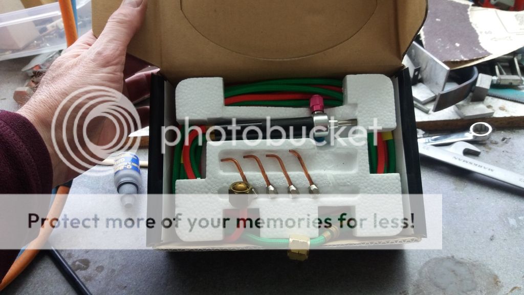

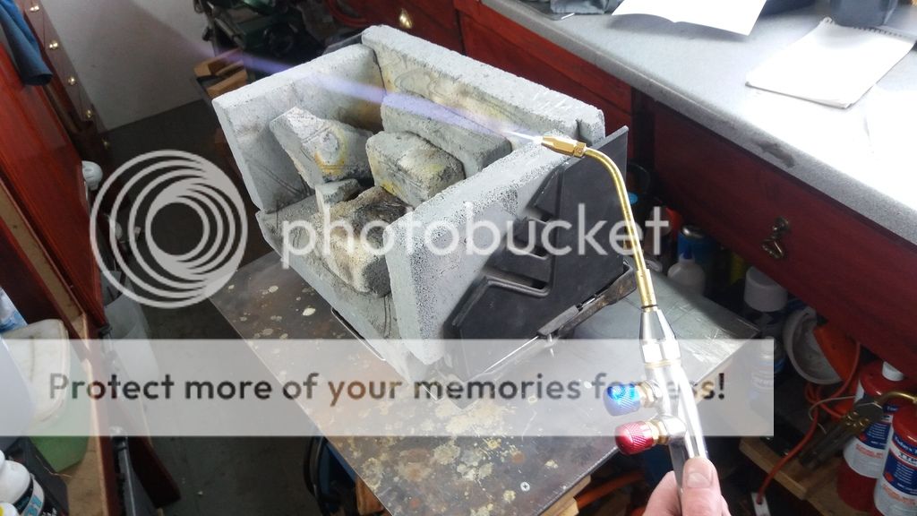

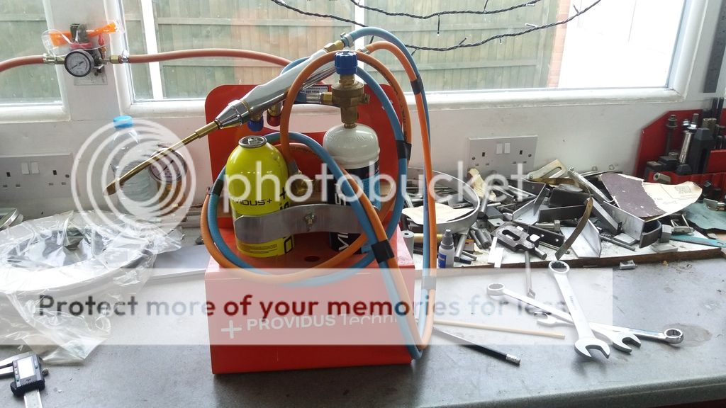

I was brought up with oxy/acetylene, 40 years or so, so I'm used to handling the high temperatures available. For many years I had a BOC portapak in my home workshop. While propane is perfectly alright for most of the tasks in model engineering the pinpoint flame of oxy/acet is really usefull. You can get into a tight space to silver solder a bush without heating up the whole boiler again. Recently though the cost of keeping oxy/acet at home has rocketed out of all proportion. The rental on the bottles is astronomical let alone the cost of the gas. So it was I gave up my portapak outfit and sold it on ebay. With the cash generated I bought one of these.
Great bit of kit. Not quite upto the high temps of oxy/acet but it is possible to weld thin sheet steel. For silver soldering jobs its brilliant, insant heat right where its needed. Ok thats the pros now the cons. The disposable bottles don,t last too long and are not that cheap. I buy 2 x oxygen bottles and 1 x gas for around £45.00. You need 2 oxygen bottles to every gas bottle.

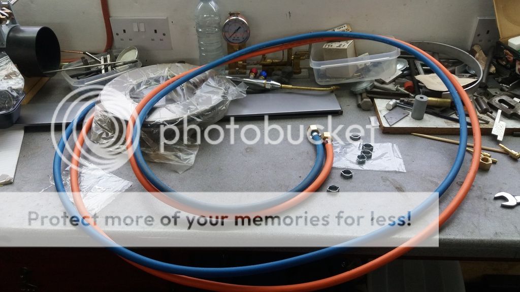

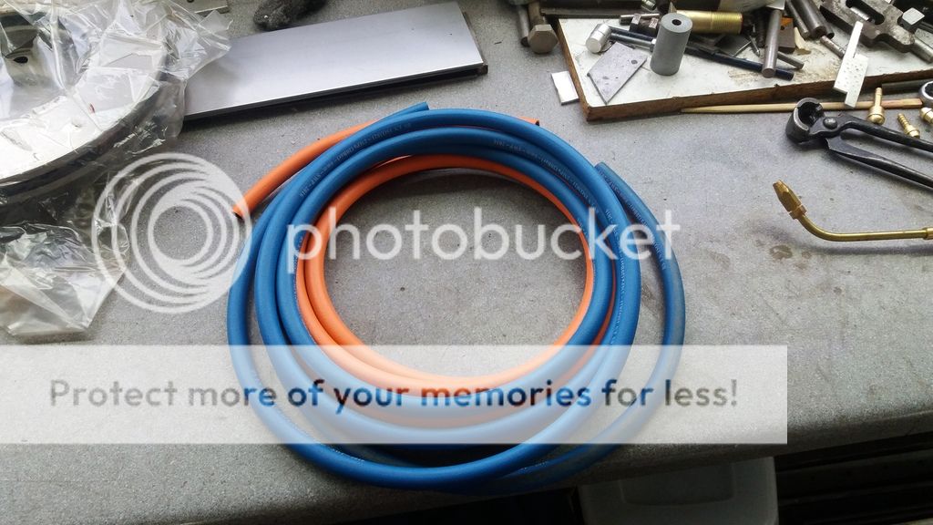

Afew bits ordered off ebay.  2 x  3mtr lengths of gas hose, red for propane and blue for oxygen £11.00

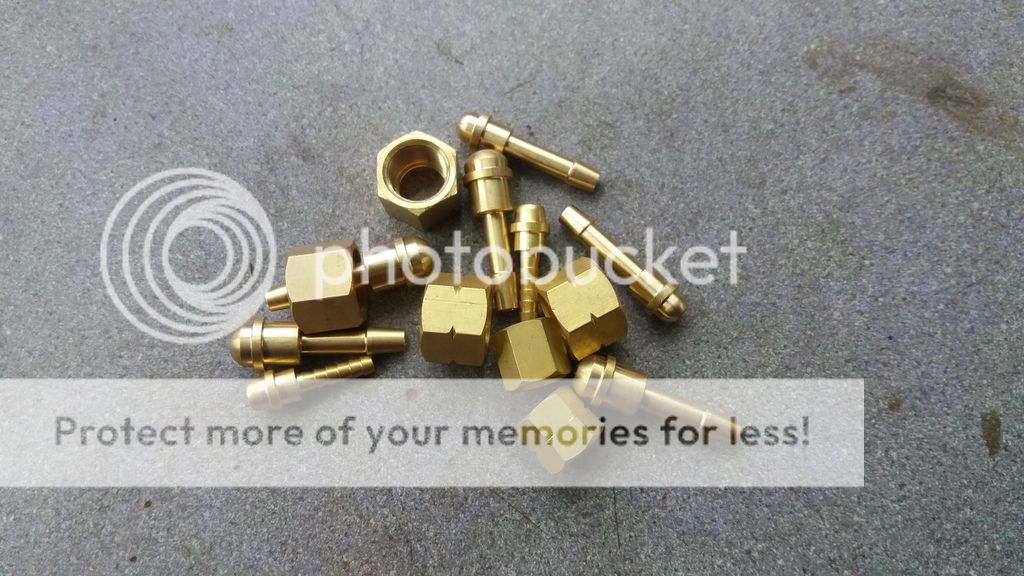

A few 3/8 BSP and 1/4 BSP fittings £10.00

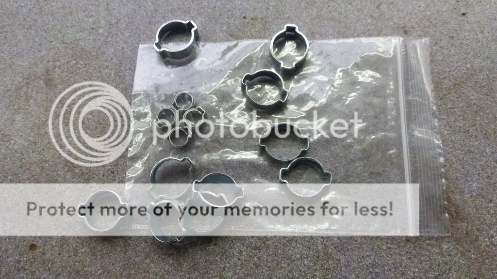

Some crimp type hose clips £6.00
Make up the hoses

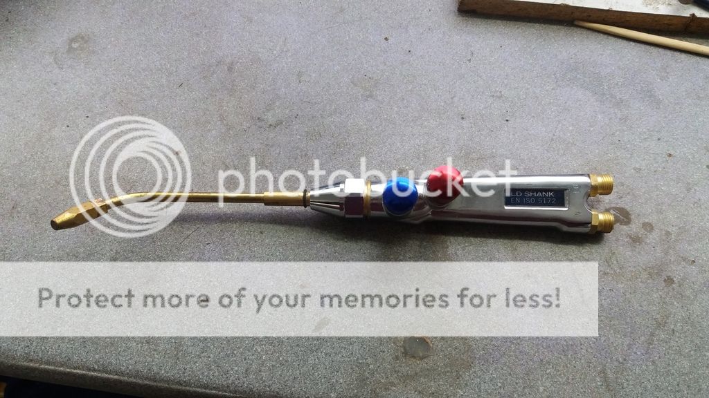

Take the gun off the small kit
Connect up
Works great.

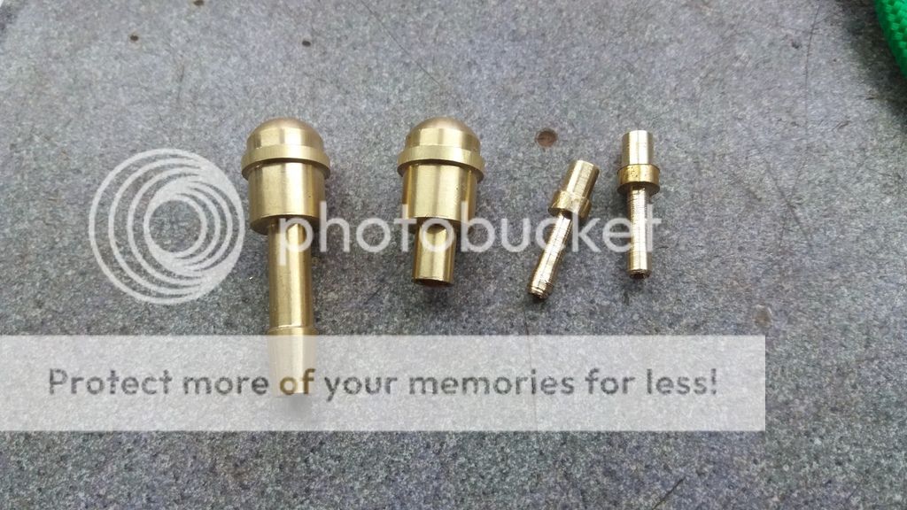

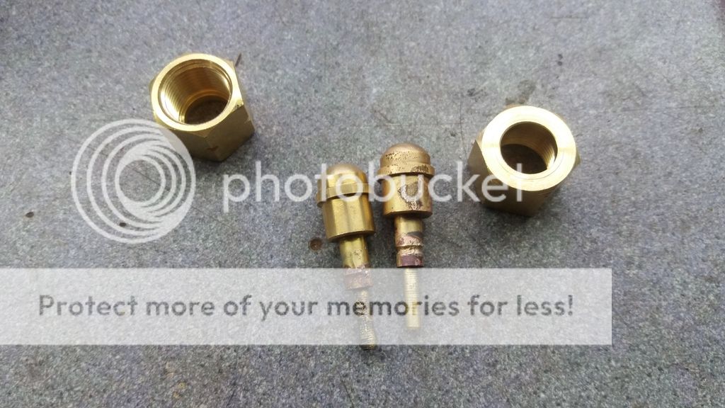

While cruising ebay I came across a small torch called the Little Smith. Quite expensive but searching a little further I came across what appears to be the identical thing from our friends in China
The connections are 9/16" UNF????? Possibly american standard???? Any the have to be chopped off and some 1/4 BSP fitted. I had to chop down some tails, make up some brass tails and silver solder them in.
The little torch is really good with a very fine pinpoint flame. Once again very high temps are achievable, enough to melt brass easily.
Hope you find this usefull

Hi Jo
Yes thats the one, looks the same as mine. I ordered 2, one for Julian as well. They were delivered no problem.
I paid £33.00 each for ours!!!!!  :'( So less than £20.00 is a real bargain, go for it. The tails and connections look the same as well 9/16" UNF LHT & RHT which might be the standard in Japan/China? so you will have to change them. I chopped mine off and made new ones, see above post, but it has just occurred to me you might be able to use the existing tails and just change the nuts to 3/8 BSP
