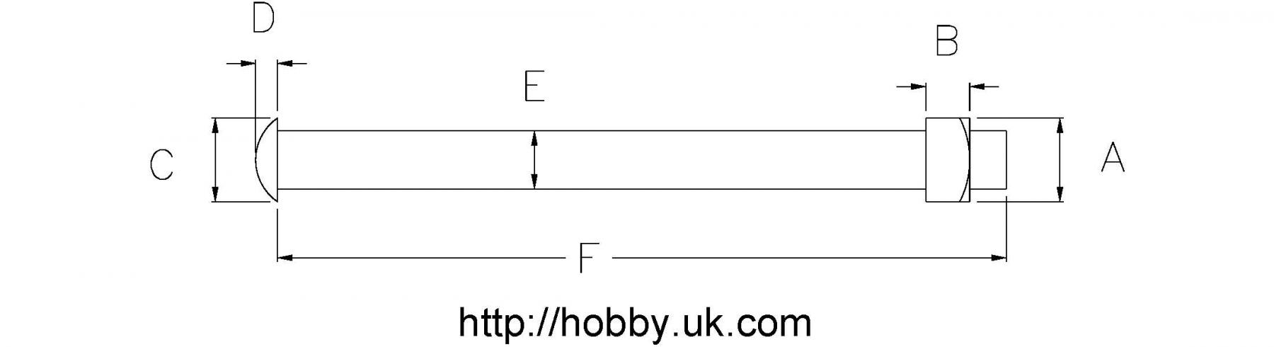

Small pattern UNC-UNF square nuts 0-80 to 10-32
http://hobby.uk.com/catalogsearch/result/index/?mode=list&q=coachbolts&x=0&y=0
Small coachbolts 1.6mm to 3mm with square nuts.
