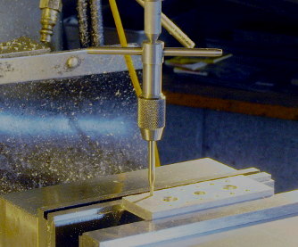

Reading this I just came up with an idea. How about taking a tap wrench like this one (from MSC) or similar.
Then pull the handle out and press fit it into a sliding sleeve, like a tail stock die holder, similar to this (from Little Machine Shop).
The trick being to start with a tap wrench giving the ability to hold a range of taps. I should try that, if I can only come up with the time.
Or, one could use a spring center in the tail stock with a stock tap wrench as above. Here I'm using a spring center for tapping in the mill.
You can only see the bottom tip of it here. I'd be using this in the lathe but the spring center I have is too large to fit into my tail stock chuck (3/4" to fit a Tormach collet). I should build a smaller one of these too.
Wow, you can even buy these from Little Machine Shop in 1/2" shank, $13.50. I'll have to order one upon my next order.
Hope this is of interest, and maybe helpful.
