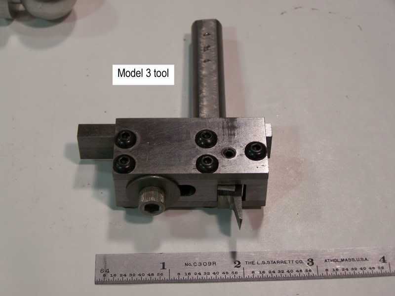

We use one at school for one of the projects. I did a little work with one to make some balls for repair of an antique transit. Had to "invent"
a new tool bit to make the required shape.  If any one wants more details I'll be happy to try and help.

Lew
I was wondering how one got the toolbit in the rear undercut. Nicely done!
