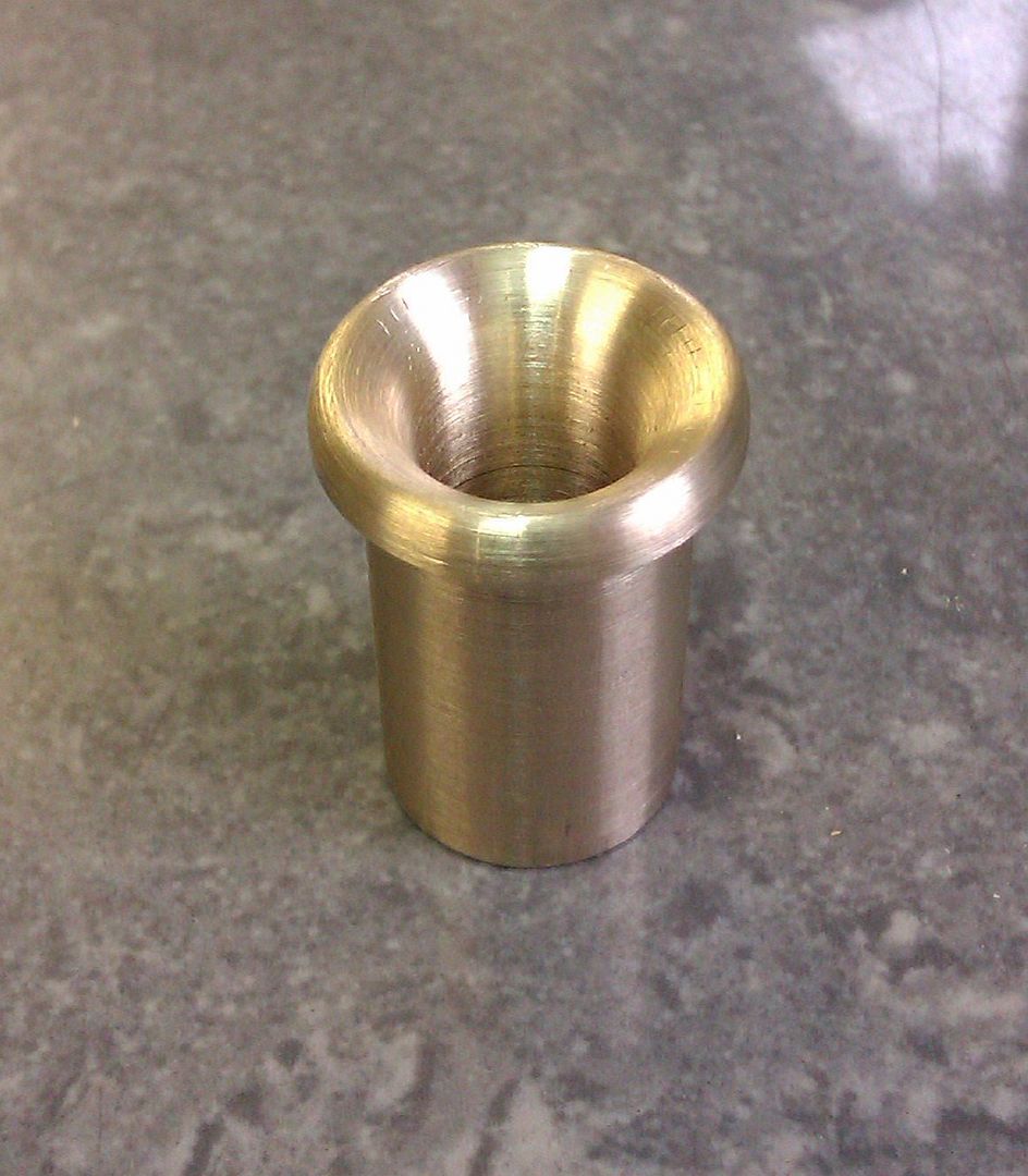

As I wanted to drill through the nose and venturi sleeve in one go the sleeve needed making first. This was turned down to a nice fit into the hole and then drilled through 7.8mm. Rather than faff about making tapered D bits or reamers I just used a very small boring bar to taper the inside from the 7.8 where the spray bar goes out to 11.5mm before parting off.
The other side had a steeper taper cut as the spray bar is nearer to that end and then the edge was rounded by hand turning.

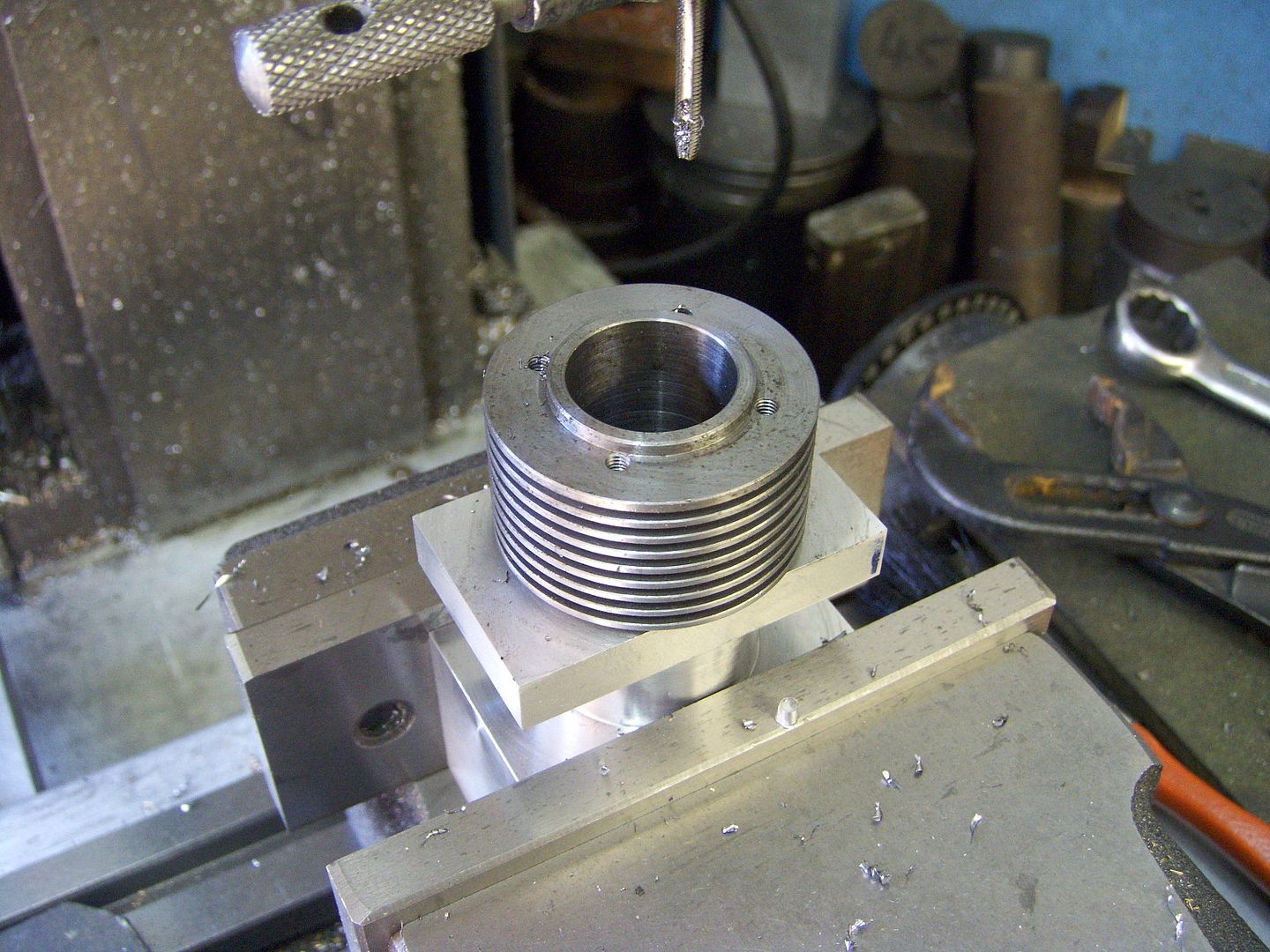

The cylinder was fairly straight forward turning from free machining mild steel (EN1A), I tweaked the size of the fins slightly to suit my cheap far eastern parting tool which made a good job of doing all the grooves in one hit.
Next the 1.0mm pitch thread was cut, as there was not a lot of runout room I decided to use the internal indexable tool at the rear of the work and running the lathe backwards, that way it would move left to right and I could stop the lathe at my leasure and run at a decent speed for the carbide tip. Straight in method rather than bothering to angle the topslide.
It was the first time I had used these indexable tools and they seemed to work well giving a nice clean cut.
The cylinder was screwed into the crankcase nice and tight and then the 4 holes to retain the head drilled and tapped M3
The four passages for the air/fuel mixture were plunge cut into the cylinder using a 7.0mm endmill, the actual scaled size was 7.2 but its easier to get hold of 7mm cutters.
I made a jig so I could hold the cylinder and clock it true to the bolt hole pattern to make sure the exhaust ports lined up with the openings in each side of the crankcase, also made a plug for the bottom so I could use some tailstock support.
When I bored the cylinder I was getting a good finish with the indexable boring bar so carried on and did the final cuts to size with that too. Now I usually switch to a HSS bit in a thick bar for the last couple of fine passes as I find there is less tool deflection and should have stuck with that. The bore had a slight taper which I thought I could lap out but that did not work too well, the passages inside the cylinder took metal off the lap rather than the other way round.
This is the expanding lap I used which has worked in the past. Also some members have said that holding a finned cylinder hurts/dirties their hand and they use gloves with the associated safety issues. This is a good alternative, take a MTB innertube cut a slice off and then stretch it over the fins, makes it painless to hold and won't get caught on anything.
Quite a nice finish just a shame its slightly tapered - more on that later.
