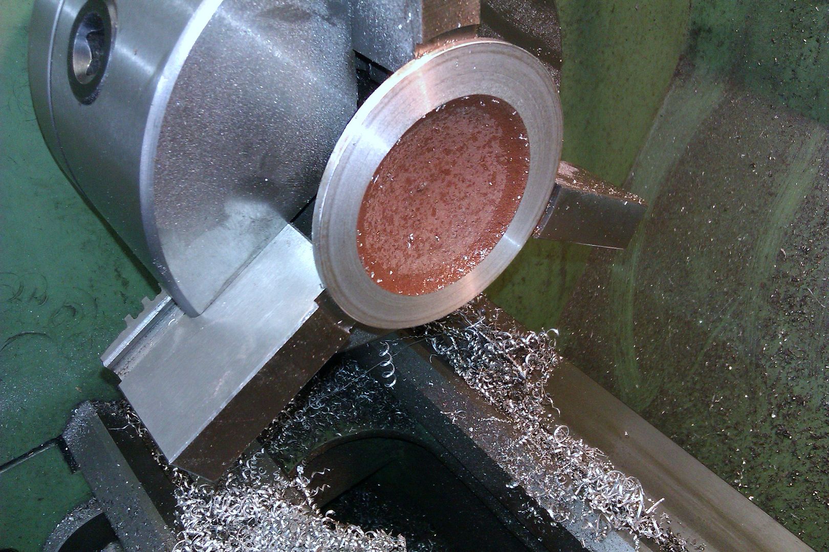

I'll cover a few of the odd remaining castings in this update.
First off is the silencer (muffler) which comes as two aluminium castings. The top one was lightly held in the softjaws while the edge and outer face was turned. I just did the curve freehand and finished with files then a Roloc disc in a cordless drill.
It could then be turned around and the inner face brought back to give a 1/8" thickness.
The other half was tackled in the same way and a 3/8" BSP thread cut for the exhaust pipe. Three small spacers and some nuts and bolts complete the silencer.

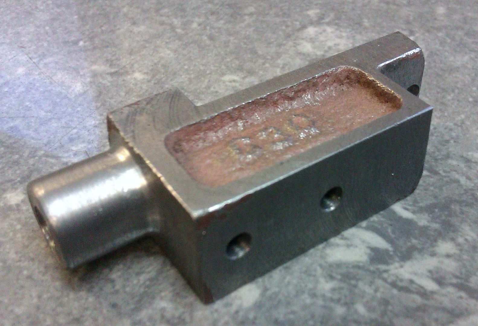

I had a bit of a heart stopping moment when I compared the push rod carrier to the drawing as it seemed to be a bit on the short side :-[
Luckily it seems to be a drawing error and the supplied contact spring that mounts on the end was also shorter than shown.
This was a bit of a job to hold but with a few bits of packing here and there I got it done.
The contact has to be isolated from the bracket so a piece of Corian was machined up. I did a spare while I was at it.
Then cut them off from the block. A small top hat bush is also needed to insulate the screw that passes through all these parts.
The Governor arm was another of those hard to hold items, just a few shrfaces to be machines and a couple of holes drilled.
A small piece of gauge plate (ground flat stock) is supplied for the two halves of the latch, one is drilled and CSK the other slotted to give some adjustment.
The pushrod that activates the exhaust valve screws into this casting
And the slotted half of the latch into these holes.

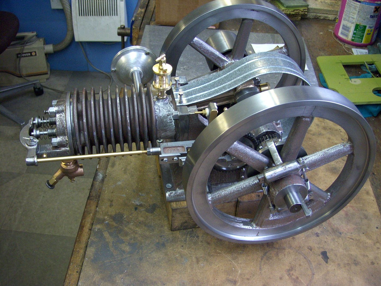

Finally for today a few shots of things going together.
With it all in one piece it would be rude of me not to give it a little fuel and see what happens when its wired upto one of S/S's ignitions
[youtube1]https://www.youtube.com/watch?v=W6YUMtlPc6M[/youtube1]
And another showing how the engine will bounce back against the compressing, starting with a quick flick of teh starting handle and a bit more of it running. Also better focus  :)
[youtube1]https://www.youtube.com/watch?v=o6675ykoGLE[/youtube1]

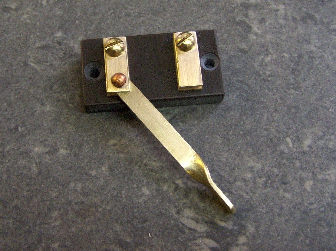

One of the features of the Gade is the knife switch that is on the side of the battery box.
I did quite a bit of searching to try and find something suitable with no joy so decided to see what I could come up with. A few bits and bobs were assembled - 3/16 and 20swg brass, 5BA roundhead and No 4 CSk woodscrews and a sample piece of Corian, I thought the coffee bean colour was a good match to Bakalite.
A piece of Corian was cut off with the woodcutting bandsaw, the 4tpi blade making light work of it.
The sawn face was then finished with a flycutter which gave a very good finish
The only downside being the fine swarf that is attracted to anything

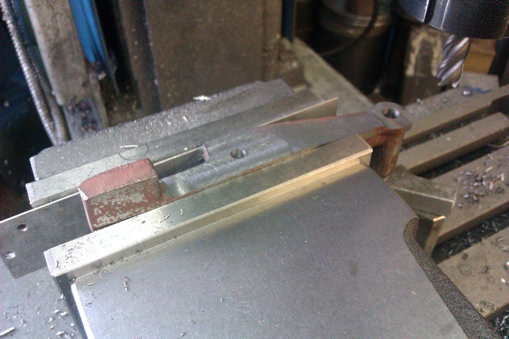

Being plastic my usual electronic edge finder would not work but it was easy enough to hold a 10-20-40 block against the side and use that to touch against.
A couple of pockets were then milled to locate the brass contact blocks into.
Followed by a pair of CSK mounting holes, two clearance holes for the wire screws and a dimple to clear a rivit.
The back face was counterbored to take some splined nuts for the wire connecting screws.
The splined nuts were just a piece of 1/4" brass with a straight knurl that were then drilled and tapped 5BA before being parted off.
These were then just pressed into the counterbored holes using the vice.
A strip of 3/16" square brass was machined up from the larger flat bar that I had and a couple of steps machined so they would sit in the pockets.
Then drilled clearance for the screws and one for the pivot rivit.
The final thing before cutting off from the parent bar was to cut slots for the knife to fit into.
Talking of which, the knife was just a strip of brass cut from a scrap of 20swg sheet which was held in a small vice while the other end was held in a toolmakers clamp and a 90degree twist added
The final job was to fit the knife to the contact block with a copper rivit as the pivot, the inside is hidden so did not need a full snap head forming, just enough to stop the rivit falling out and to make the knife firm enough to stay in the closed position while the engine is running.
A couple of shots of the finished parts.

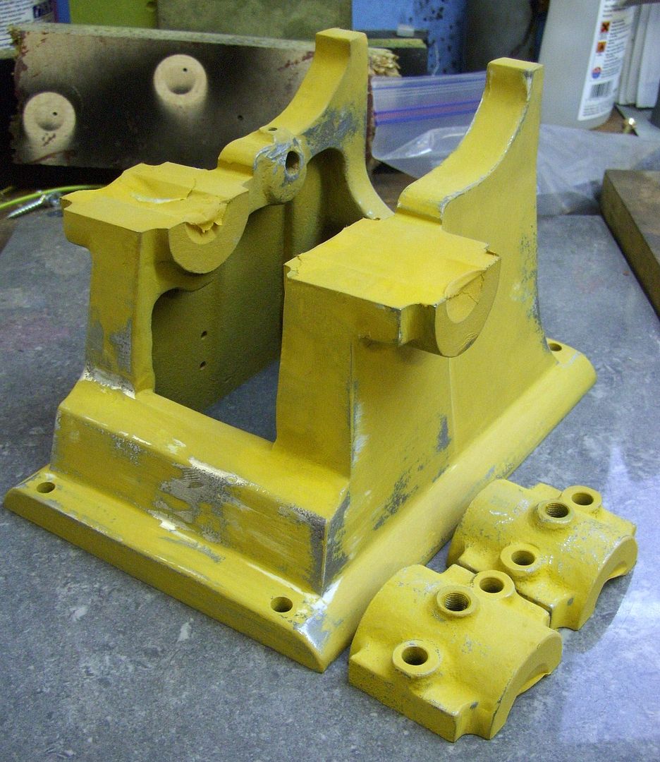

Before talking about prep and paint I'll repost a couple of the photos of the castings.
The main base casting has some pitting and also those nasty Dymo lables where the pattern number has reproduced on the finished casting.
Flywheels had pitting to the side of the rims and counterweight
And the cylinder had some really bad mould shift
The first thing I do is take a Dremel with a grinding bit and run that over the whole surface  which removes any raised "grains" from the casting sand, I also take off parting lines and excess metal where the sand mould has been damaged and the resulting hole filled with metal.
The governor bracket shows the resulting surface quite well, the "bright" rectangle in the foreground was a Dymo lable imprint
Here you can see on the flywheel and main base casting how all the high spots have been removed, what is left of the red primer is in the dips and hollows.
The cylinder fins needed a bit more than the Dremel could muster so I used a 4.5" angle grinder and grinding disk to remove half the high area from each side of the fin, any more and they would be too thin

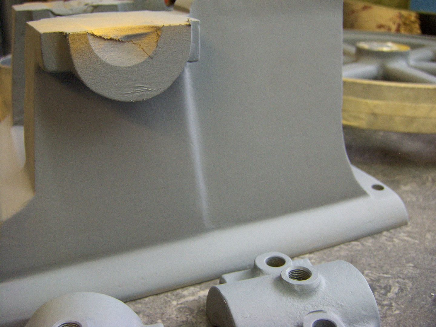

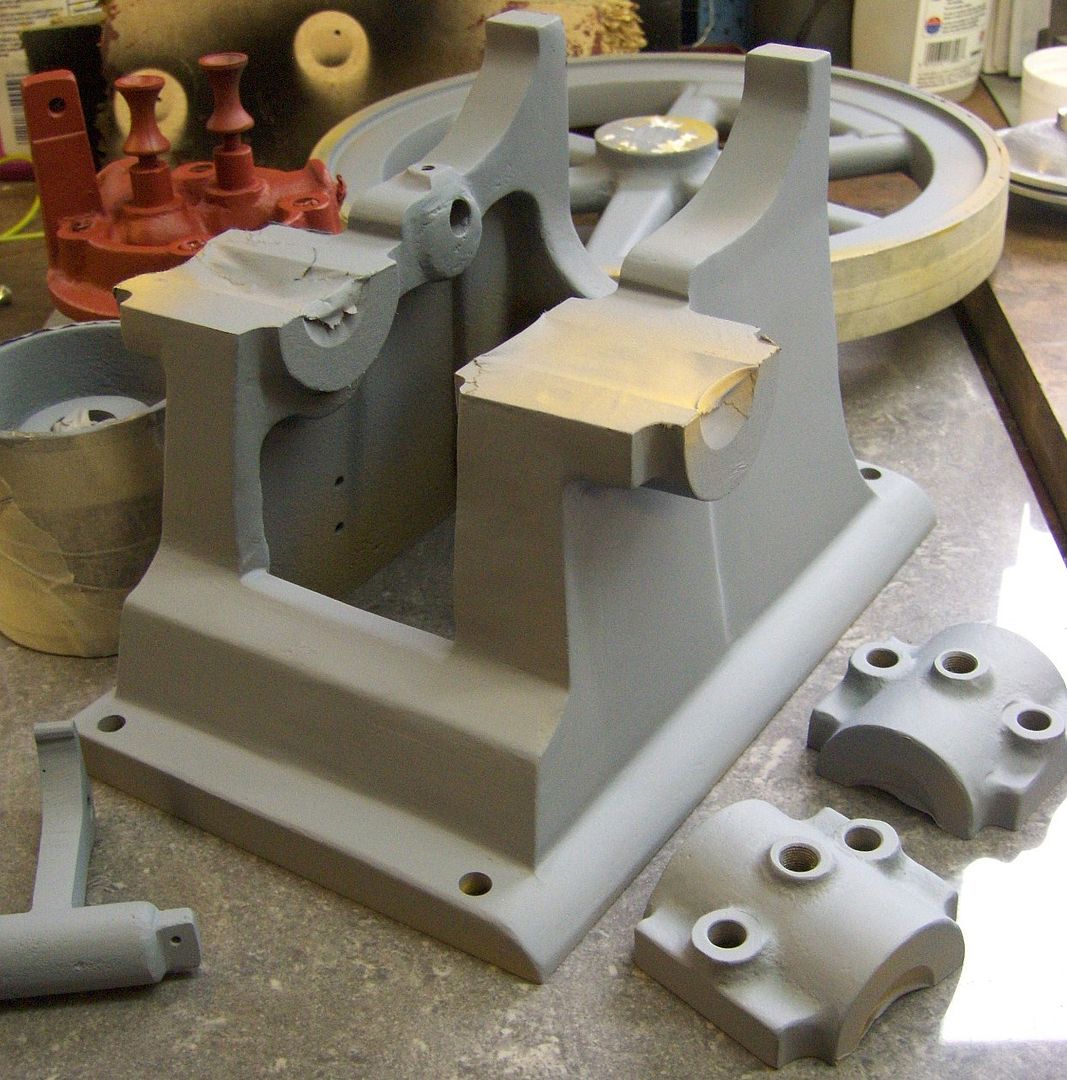

After a wipe down with acetone I applied some Upol body filler (Bondo) to the main parts, on the cylinder fins I use JB Weld as it can take a bit more heat than the bondo.
After an hour or so to harden it was out with the 120grit to remove all the excess filler, a couple of areas showed as needing a second application which they got before a second rub down.
After another wipe with acetone I applied a "filler primer" this showed up a couple of minor blemishes which were filled with knifing putty
When that had set it was all rubbed down with 180 grit
I then applied a couple of coats of grey primer with a quick rub with 320g between coats, as you can see things are looking a lot smoother than the original cast surface but there are still a few undulations which I think you want with a casting otherwise it starts to look like a barstock engine.
Once happy with the primer the colour coats can be applied and finally finished with a clear gloss fuelproof lacquer.
