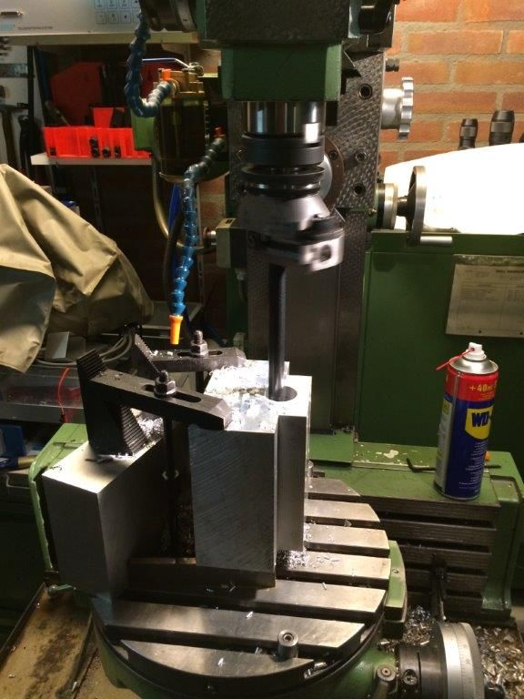

Initially I planned to make the central bearing bore with a between the centres boring bar in the lathe. However on the Harrison lathe there a very limited possibilities to mount clamps, it does not have T-slots in the cross slide and I refuse to drill additional holes in the machine. Alternately I could make the boring in the mill with a boring bar, I just have enough height in the Z to make the set-up
I will go this way, the mill is rigid enough to make this boring. Advantage is that I can pre-drill the hole with a 32mm drill, the biggest one I have, and the set-up on the milling table is much more easy then to set it exactly on centre height on the lathe.

I managed to make the 42mm boring. Set the block on a parallel set and clamped it to the table. Took my time to check the set-up so that I was sure if was perpendicular to the milling table
Predrilled the bore with a 32mm drill, the biggest drill I have. It’s a Chinese quality drill and it made quite some noise so I switched on the coolant. It has been sitting for some years without use and it looked like it was sucked from the local swamp, all dirty and brown..... Time to clean the coolant reservoir and change the coolant. For now it helped to reduce the noise during drilling.
Mounted the boring head and start rough cutting until I reached 41mm. Then in 5 steps of 0.2mm I finished the bore to 42.00mm.
Next I drilled the 8mm holes for the water cooling channels. The need to be more then 150mm deep, I will drill them to final depth with a hand drill later, too much work on the mill where my Pinole has a travel of 50mm only.
To check the parallelism between bottom and cylinder block I made a small dial indicator holder from a piece of brass. It worked quite well, from front to back and left to right the reading are within 0.01mm.
Regards Jeroen

Hi Jeroen, looking good so far. If I look at your first posting http://www.modelenginemaker.com/index.php?topic=4398.0, there is some machining visable in the middel of the Vee of the your engine block. I am afraid, this will cause some deformation due to the internel stress of the material. This could have an effect on your crank shaft bore.

I am not quite sure what you mean Achim. I have chosen to make the boring first to not have interrupted cuts during the boring. Due to the flex of the relatively thin boring bar (16mm) I was afraid for that. If you have a in-between-the-centres boring bar of 30 to 35mm flexing is less an issue. They are 2 quite big pieces of aluminium, I do not expect them to deform when milling some pockets and hole drilling. I normally take several light cuts instead of few deep cuts. If I am missing your point let me know please.

....... They are 2 quite big pieces of aluminium, I do not expect them to deform when milling some pockets and hole drilling. I normally take several light cuts instead of few deep cuts. If I am missing your point let me know please.
Regards Jeroen
Hi Jeroen, in your CAD model is a big pocket in the Vee of your engine block. This machining process could have an influence to the main bearing bore , but if you do it as mentioned above,  with several light cuts it could be without any effect to the bore.
I have learned, that some times these aluminum blocks are doing strange things after cutting big holes in it.

Ok Achim, get the picture now. The V will be milled with the CNC mill, 1mm deep cuts, no heat generation at all. But thanks for the warning, nice to have some one looking over your sholder and tap my fingers when needed.  :ThumbsUp:

Mike, the milling machine is a German Thiel140, 1979. It came from a sort of school andit is practically new. Power feed on all axis, hydraulic locking, SK40. As far as I know Thiel was bought by Deckel and after Deckel. The boringhead is a eastern European make but simular to a Wolhaupter. It has the possibility of auto feed to make pockets etc. New very pricy, best to look for a good used one. Most of my tools I get second hand.
