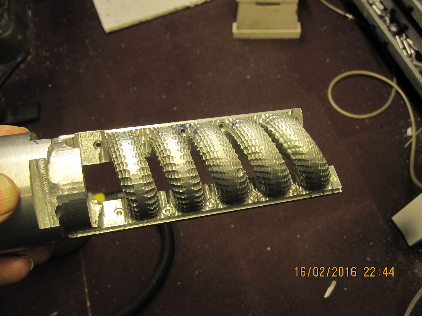

I spent a while getting the anodising right on the cam covers, then I had to do some decorating, and then I tried making one of the inlet manifolds. These are more complex than the V8 ones as each pipe is at a different angle.
Anyway, this one took about 35 hours. Hopefully the other side will go a bit faster.
I only made 2 boo boos on this one. I've shown how I fixed these as well.

Another fantastic piece of metal sculpture. Beautiful machined and finished.
Isn't it strange the way a CNC will always give you an extra feature for free, just where and when you don't want it.
An excellent, invisible repair. You would never know it had happened.

Hi Mike, don't know about cnc, this was all done on a manual Bridgeport.

That makes it even more impressive.
It also shows that there is nothing a CNC can do that a manual machine can't do as well.

why is there pictures with no holes in between ports and in between ports on others????
I was also trying to figure out valve configuration " intake ,spark plug and heather "they match
for number one and then  1/4 of the manifold is missing ???
is it camera angle ???
