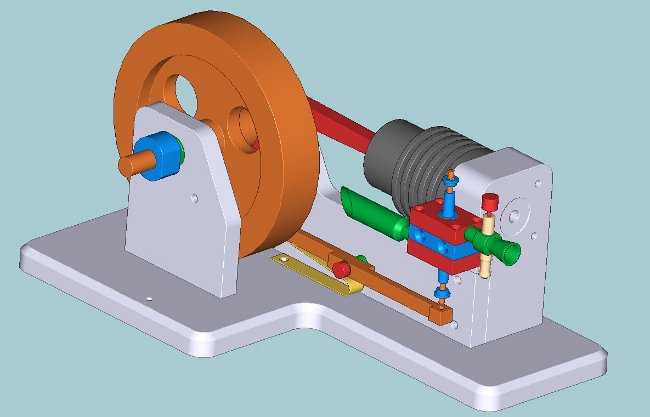

Over the last month or so I took the plans and modelled them in CAD. It does look like all the parts will fit together.

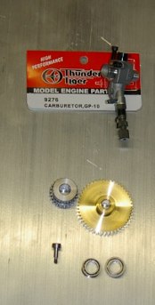

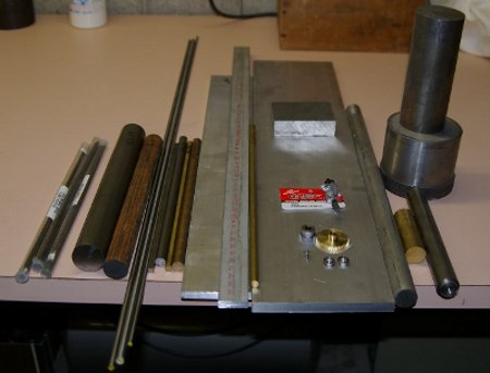

I ordered most of the materials and parts around Dec. 20. Metal Stock from Speedy Metals, spring wire from McMaster Carr, gears and bearings from SDP, and a carburetor from Omni Models (Ebay). I like OnLine Metals but I couldn't find cast iron from them. With these and stock on hand I have most of the needed supplies. I forget how long the least expensive shipping method can take. The last order, from SDP arrived today. I still need to obtain a spark plug and points but can likely get these locally.
I ordered the ball bearings suggested in the plans and was surprised they are sealed on one side only. It'll run infrequently (the optimistic view) but dirt and grit may cause problems down the road, time will tell. The plans give a carburetor design but suggest an RC carburetor will work better. I decided to go this route, at least till it's running.
