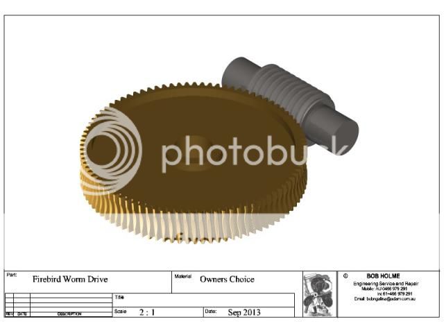

Hi Rich,
Let helix angle = A
Tan A = Pitch/(EffectiveDiaxPI)
Tan A = 0.1/(0.686xPI)
A = 2.650
Best Regards

The helix angle you have calculated is certainly correct, however, it may not be clear to some viewers, whom may not be so well versed in trig, exactly how you arrived at it...
If I may be permitted to elaborate a little on your posted formula…
Let helix angle = A
A = arctangent (Tan A)
Tan A = Pitch/(Effective Dia x PI)
Tan A = 0.0464
A = arctangent (0.0464)
A = 2.650
NOTE… on a calculator the arctangent key is usually marked as   tan-1
The Effective Dia is found from OD – (0.64 x pitch) for a Whitworth thread form.
In the case of the Whitworth thread form this is also the PITCH DIA.
Hope this clears up any possible confussion.

The formula you used for the OD of your blank
OD = (Number of teeth x pitch) / Pi
This will give you the PITCH DIA… not the true OD
For Whitworth thread form… you need to add the thread depth to this to obtain the true OD
Thread depth for a Whitworth thread being (0.64 x pitch)… in your case this will be 0.064”.
If you use OD= ((number of teeth + 2) x pitch) / Pi
This will give you a very close approximation.
If you use the pitch dia for your OD... then you can only cut to a depth of 0.032” before you begin to damage the thread form by thinning it too much… you also run the risk of reducing the actual number of teeth by cutting beyond this depth.
Have you counted the actual number of teeth on your last finished worm wheel?
Hope this helps a bit and does not add to any confussion.

Now Sandy lets move on to the diametre of the blank I need.
90 + 2  X  .1  ÷  3.1428  =  2.9273   :thinking:
Why do I have to add 2  :noidea:
I haven't counted the actual number of teeth, never thought to do that  :facepalm:
Thankyou all for patience.
Rich

Hi Rich,
I thought that lot would get you going  :mischief: :naughty:
In your original calculation you had...
OD = 90 x 0.1 / pi which gave you 2.864"
This would be the Pitch dia of the gear wheel... for WHITWORTH threads this would be the diameter at half the thread height... therefore, you need to add the other half to both sides of the circle.
You do this, for WHITWORTH thread form by adding the thread depth to the PITCH dia... this takes care of both sides of the circle.
For WHITWORTH threads the thread depth is calculated as follows: -
Depth = 0.64 x pitch... = 0.64 x 0.1... = 0.064"
The true OD would thus be 2.864 + 0.064 = 2.928"
The OD for a spur gear is...
OD = ((N+2) x pitch) / pi... where N is the number of teeth required.
So ((90 + 2) x 0.1) / pi ... = 9.2/pi... = 2.928"
So.. by adding 2 to the tooth count the calculation takes care of adding the tooth depth for you.
 You would still need to find, or calculate, the tooth depth though... so you know how deep to cut.
Strictly speaking, there is still a small error using either method since both of the above methods are for STRAIGHT cut spur gear teeth.
A worm wheel has helical cut teeth and therefore the PITCH of the teeth is increased, over that of a corresponding spur gear,  due to the angle... which in turn increases the OD... but for this excercise the above calcs will be adequate... unless you want to get into Cosines as well as all the others :censored:
I hope this all makes sense.
Keep happy.
Sandy. :cheers:
« Last Edit: September 02, 2013, 11:15:58 PM by SandCam »

Hi Rich,
Bloody gears.........one more thing and that is the width of the wheel blank.
Axial width = (2.38 x Pitch) + 0.25
                 = (2.38 x 0.1")+0.25
                 = 0.488"
Hope this helps
Best Regards
PS Hi Sandy, The spring is on us in down underland after a very wet winter. And I have no objections to your expanding the formula. It's good somebody looks over my shoulder, preferably with a can of WD 40 at the ready to loosen up my gears.
« Last Edit: September 03, 2013, 02:03:16 AM by Maryak »

I took the liberty of running this through my CAD and worm spreadsheet which I have attached.
Oh and Pete in my case when it comes to maths:
Expert =  X,spurt................X, (the unknown factor) and spurt............a drip under pressure.
As Sandy alluded to; there are some minor differences between actual worm calculations and those using a tap as the hob. e.g. helix angles. In a practical sense the gashing angle does not have to be all that accurate just good enough and with the correct number of teeth to give the tap a reasonable start.
I hope it's of some use.

I got a 3/4" 10tpi spiral flute tap today, I'll get a photo posted soon. It may work without gashing the blank, I'll give it a go next time I get out in the shop.
Pete the xspurt tag I could wear easily  :lolb:
Bob, if I can cut a gear as good as your drawing I will be a happy man, and thanks for gear blank width formulae.
Sandy, cosines  :facepalm2: now why didn't I think of those
Rich
Me too, the real world is far more demanding than cyberspace but it does give an idea of what things should look like.
