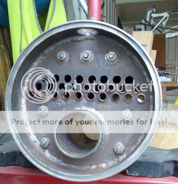

« Reply #125 on: August 16, 2013, 11:48:24 pm »
Well, its been a while since I posted but progress is being made.
I am now half way fitting the tubes. The slow progress was due mostly to developing a successful method of not only rolling the tubes into the plate but of actually getting the tubes through both plates. Not to mention the 3 tubes I buggered before the learning process was complete. Of course if I had a spare $400 I would buy a tube roller but it's a tad difficult to justify the expense.
Believe it or not the photo was taken with my mobile. This particular Nokia 6233 is my 5th................1 in the river, 1 in Yelta's bilge and 2 in the washing machine. It was given to me by a Russian friend of Galina's after I translated and wrote his CV in English English. I am amazed at the quality just point and press and no enhancements with Photo Impact.
Best Regards

« Reply #126 on: August 17, 2013, 01:03:11 am »
Those are indeed some beautiful welds Bob. My Father was a welder all of his life and I know he would be thrilled at the sight of your work, well executed indeed.  :ThumbsUp:  As a young lad of about 7 or eight years of age, I  assisted my grandfather with the task of re-tubing this huge boiler on a New Huber traction engine. It was in the middle of August out in the middle of an empty lot. I would have to crawl into the firebox and use a metal rod to capture and guide the new tubes into place and then I remember having to use the curling chisel and a heavy hammer to turn over the ends before rolling. I don't remember exactly how many tubes were in that thing but it took almost a week to finish the job. Sweated my privates off but it was with/for Grandpa and I would do it all again in a heartbeat. I still see that engine at one of the regional shows and it always brings back the good memories.

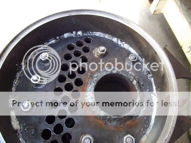

« Reply #128 on: August 17, 2013, 03:35:29 am »
Thanks for the Support Jim and Don  :praise2: :praise2:
BC1
Yes they are............I didn't do them.
This is my effort
When I took it to the shipyard for NDT of my welds, the boss looked at me, went Xeyed, burst out laughing and when he'd picked himself up of the floor very gently said, " Bob"....(giggle giggle), "How about we weld it for you." Note the absence of a question mark. It's nice to have friends like that.
