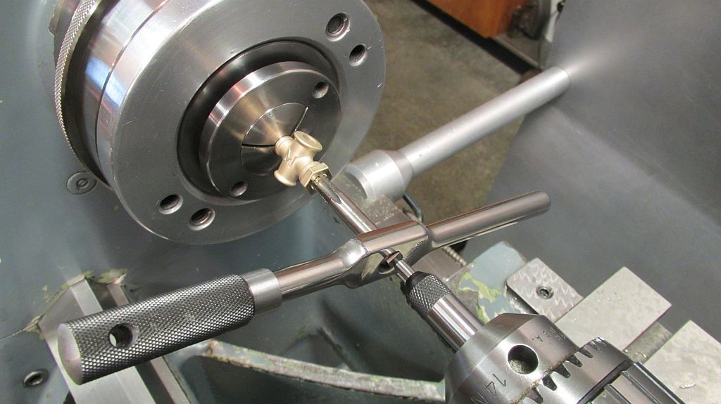

The 1/16” NPT or 5/16”MTP is taped using a guide in the tailstock.
