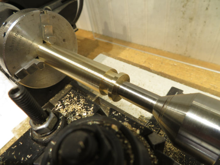

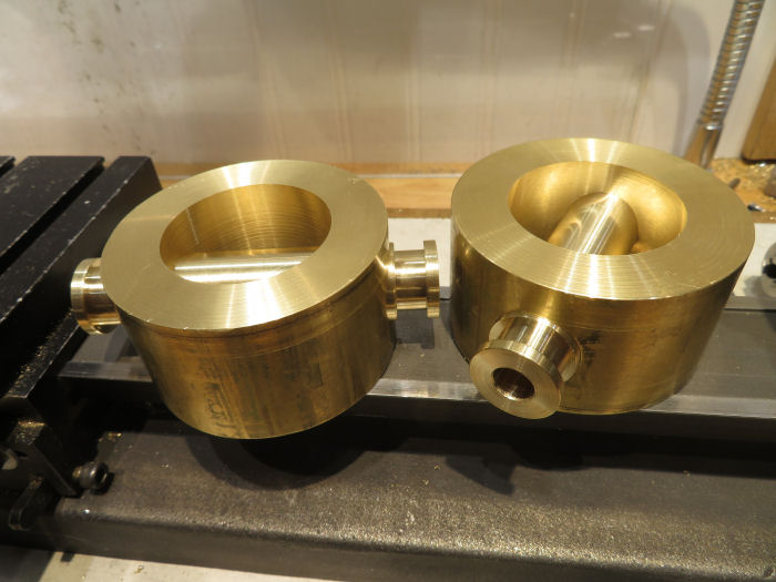

« Reply #18 on: May 20, 2026, 03:16:13 pm »
This morning I turned/bored the trunnion bars. The ends are drilled/bored to take the o-ring steam/exhaust fittings later on. The grooves near the end will sit in the bearings on the lower frame.
Here they are, test fit in the ring blocks, ready to be silver soldered in place:
After soldering, I can start milling in the passages for the steam and exhaust, the flats for the steam chests, and get the centers bored out to final size so they will fit over the cylinders.

Will you drill the trunions through before soldering? That would also decrease mass to be heated.  But it might make them more prone to warping.  Just a thought.
  • Posts: 23224
« Reply #21 on: May 20, 2026, 07:06:02 pm »
The cylinders and trunions are coming along nicely.  :ThumbsUp: :popcorn: :popcorn:
Hi Kim,
The trunnions are drilled in from either end to the inside edge of the ring - didn't bother past that since it will get trimmed out anyway. Shouldn't warp since it is down the center of the trunnion. I'm going to bore the inside of the ring to final size last, in case the milling of the passages and the flat for the steam chest causes any stress-relief type warping of the ring.

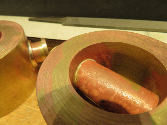

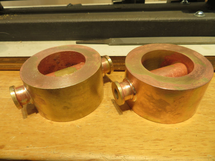

  • Posts: 23224
« Reply #22 on: May 20, 2026, 08:59:47 pm »
I just finished silver soldering the trunnions to the rings, appears to have gone well - had to use my second-largest torch nozzle even with cutting the center out of the rings, its still a lot of mass to heat up. The solder penetrated right through to the inside of the ring, could see the shiny solder against the brass. Its outside still, cooling off, and will take a swim in the pickle solution once its cool.
In the meantime, the 4 chime whistle that I ordered off fleabay arrived today!   :whoohoo:   I've gotten it added to the row of single chime ones that I made last year - quite a different sound given that its about the same size as the others. Going to have to lock up the compressor tonight or the elves will not let me get any sleep...
<a href="https://www.youtube.com/watch?v=T_e49CvdaGI" target="_blank">http://www.youtube.com/watch?v=T_e49CvdaGI</a>
  • Posts: 23224
« Reply #23 on: May 20, 2026, 10:13:30 pm »
Here are the trunnions/ring blocks after silver soldering and a soak in the pickling solution, the wire brushing:
The solder was only applied on the outer ends of the trunnion joints, and I know the joints got filled all the way through since the solder shows up on the insides too:
So, next time I can start in on milling the steam passages...

Yup, I  used the nozzle one step smaller than the monster that I  use on copper boilers. This time I  used the Easy grade solder, which flows at a slightly  lower  temperature and  flows very well into joints. Don't  recall its exact temperature  range, think its around 1150F, give or take 100 degrees. At the lower end of red heat. I judge the heat more by when the flux goes clear than metal color, also I start with a short bit of the solder laying on the joint so I  can see it soften and start to flow, then add more from a long piece of the solder wire as needed, all with hold8ng the flame around and on the opposite side of the  parts rather than letting the flame be directly  on the solder, which would melt the solder and have it ball up and run off before the metal is hot enough. Key is to get the metal to melt the solder so it flows into the joint. Just weighed one of the blocks, its 2.2 pounds, quite a bit to heat up!
