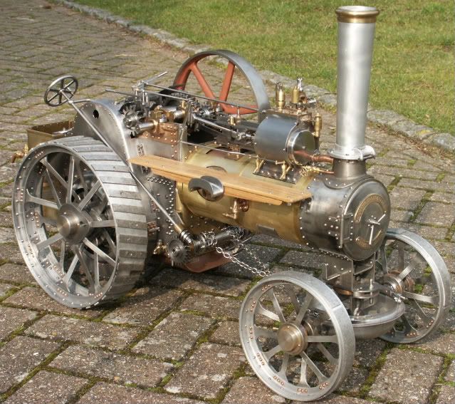

  • Posts: 11263
Re: Help finding the original dimensions for the Fowler BB1
« Reply #5 on: May 04, 2026, 01:15:11 PM »
I mentioned the shortcomings of the Haining Darwings as the OP said he specifically wanted original sizes and should therefore be wary of the Haining drawings he says he has.
Compared to the A7 Fowler that I built which is very true to the original Hainings engines are a long way off . I do have a set of Superba castings aging and having started to look at the front end and redrawing it as I not finding a single part that did not need alteration lost some interest.
I suppose it depends what the individual wants, myself I like a bit of correct detal where possible. These days with most of us having far better equipped workshops and research just a click away you don't have to settle for building to a 60yr old desing.

Just to say, I'm much admiring Mike's impressive and purposeful Fowler ploughing engine model, and also the beautiful A7 engine shown by Jason.  Lovely examples of model engineering. Dave
