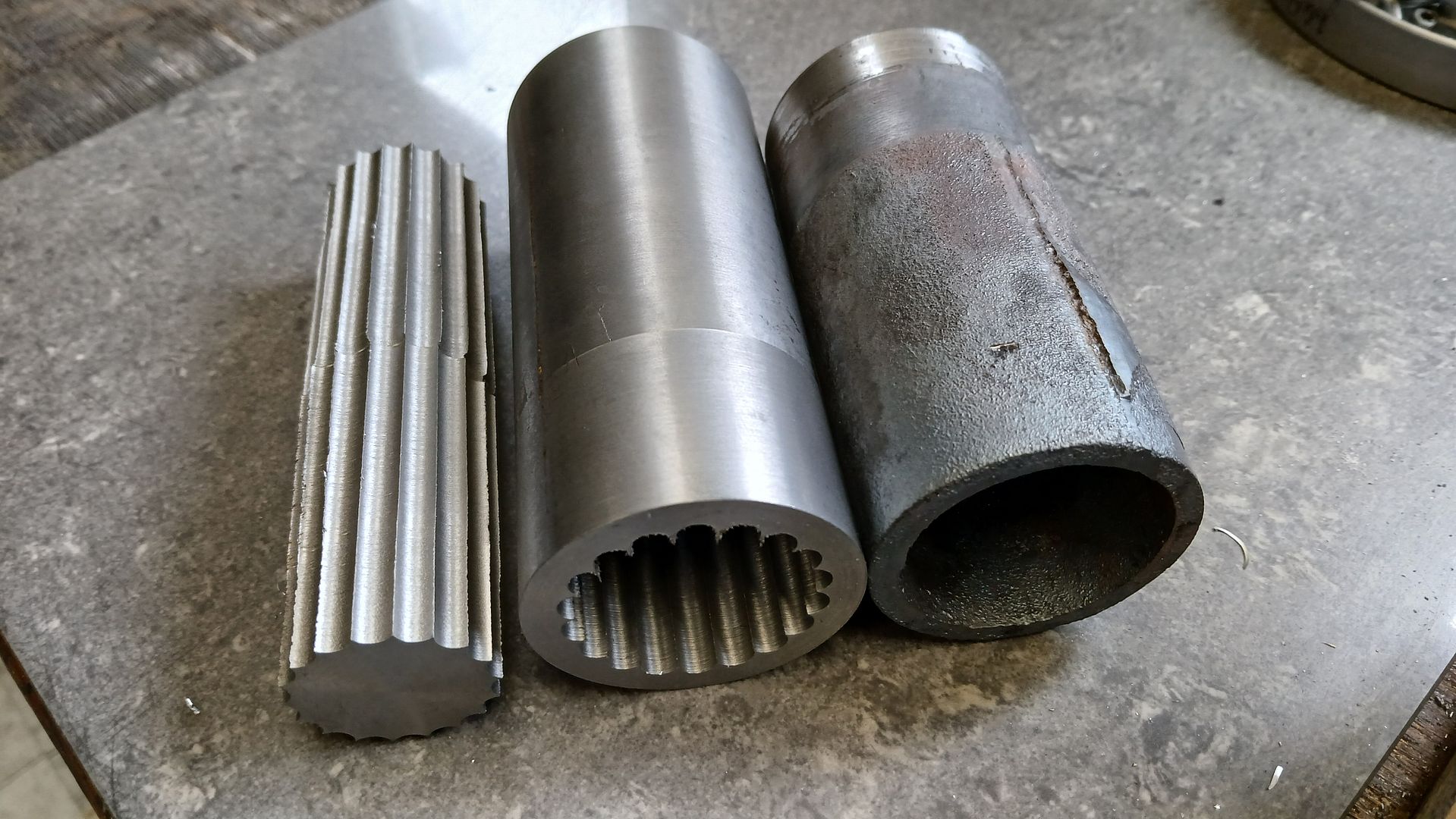

For 1/4" holes I just space them at 1/4", or 6mm spacing for  a6mm drill. If you use a split point stub drill it does not need a spot drill to start and is less likely to wander. The waste material usually just drops out.
Put a 1/4" milling cutter in the mill and plunge down one side of each hole about 40thou offset from the drilled holes ctr and that will do the job. No need for a 2 flute as 3 or 4 will do.

For the hole in the baseplate I don't think I would have bothered with chain drilling. I find it tedious, and unnecessary for most jobs, Jason's examples being exceptions because of the depth. I see it as mostly being a way of reducing hand work with a saw. I would have used a slot drill, probably in several passes, leaving a few thou all round for a final pass at full depth.
And you get some nice fluted columns as a bonus if the material is thick enough  :Lol:

Those pictures look great and one for the future for sure. I've just Googled split point stub drill as I had never heard of them before and haven't got any.
