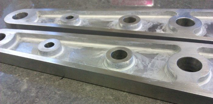

And for pads that have other parts on top of them, the countersunk screws could be hidden under the parts, no need for filling/blending them in.
Online Sanjay F
  • Posts: 2287
Re: Project Vulcan
« Reply #16 on: April 11, 2026, 03:40:49 pm »
Ah yes good points on using CSK and not being seen as they are covered as well as using the JB for the fillets  :ThumbsUp:
"Should the CL of teh flywheel be above the plate? I would have thought you need it to clear the flywheel and have it's side close to the "pit"
Yes, thanks for spotting that, what I have drawn clearly wouldn't have worked!!  :facepalm2: :facepalm: Now where's that eraser gone........
Then onto ordering some metal:
1/8" plate - What is an nice size for the bigger bottom ? 5mm larger all round from my drawing dimensions
1/4" plate - To the measurements I have on the drawings
1/8" pieces  - To make the pads (probably have most of that)

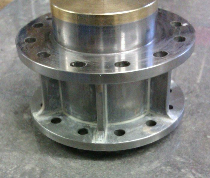

The tear down started and everything is bagged and tagged. There are a lot of dome headed bolts used and some made of brass which were tricky to remove witout breaking. The cylinder/piston was covered with grit which has now been cleaned out. The painted items are being bathed overnight and it'll be interesting to see what they look like without there garish colour.
I'm thinking the cylinder would look nice with some wooden lagging and brass banding, I'll have to see whether this can be accomodated

The one with the hold down bosses along the sides was 1/8" overhang at the ends and 5/16" at the sides to accommodate the bosses. The simpler one where the hold downs go through the thicker plate were 1/8" all round.
You could use car body filler or Miliput for the fillets as both are easier to shape than hardened JBW
Online Sanjay F
  • Posts: 2287
Re: Project Vulcan
« Reply #19 on: April 12, 2026, 07:08:35 pm »
Thanks I'm going simple, I think I ordered 5mm all round so not a lot in it.
Miliput, now there's a name I've not heard of before - I did an experiment with JB Weld and as my wife's a bit of a dab hand with silicone on tiles, she gave it a go, she did a pretty good job! (see photo)  - however she's not over keen on the smell so maybe Miliput has a sweeter fragrance  :Lol:
« Last Edit: April 12, 2026, 11:32:43 pm by Sanjay F »
  • Posts: 11312
Re: Project Vulcan
« Reply #20 on: April 12, 2026, 08:42:12 pm »
She has done well
Milliput is a much thicker putty. You can roughly apply it to an internal corner and then run a ball ended tool that has been dipped in water along the corner nuch like your wife may do with a wet finger to smooth silicon. The excess can then just be scraped off before a final wipe with a wet artists paintbrush. I use the Superfine White
Online Sanjay F
  • Posts: 2287
Re: Project Vulcan
« Reply #21 on: April 12, 2026, 08:59:13 pm »
That's looks like a very neat job indeed; I did wonder about getting a smooth finish around corners, ball ended tool! :ThumbsUp:
I've ordered some on Amazon, cheap enough too  :D

A day off work and steady progress on the new base. Started by making the bosses and ensuring they fitted each part which they will be mounted onto, followed by squaring up the base and marking it up. The bosses were then super glued to the base and drilled and tapped straight through.
Once this was done the bosses were fixed to the base plate using M3 csk bolts, the base plate holes for the crank and the eccentric will be next .......but that's it for today
« Last Edit: April 27, 2026, 09:16:58 pm by Sanjay F »
Online Sanjay F
  • Posts: 2287
Re: Project Vulcan
« Reply #28 on: April 27, 2026, 07:20:31 pm »
After all that I was pondering if the parts would fit so did a quick test fit and atm, it's looking ok  :)
