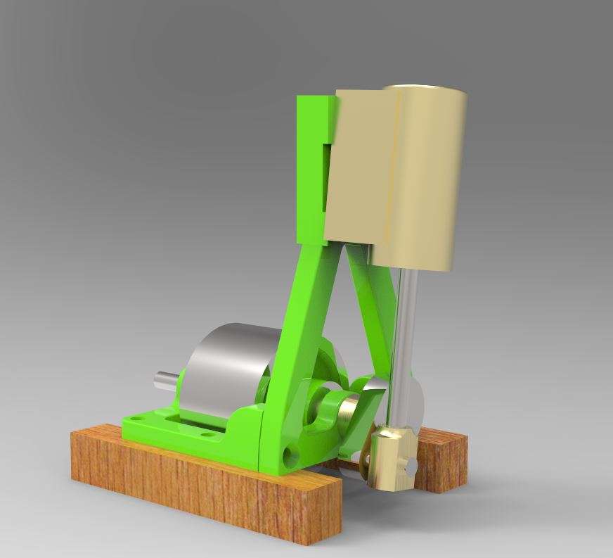

Another Little one completed. This time it's a replica of the SEL "Steam Launch Unit" Actually made by Midland Models in the 1950s.
As usual redrawn in metric using Alibre with a bor eof 11mm and stroke of 13mm.

I wear glasses, but I still have to look three times to distinguish the real object from the CAD simulation.

Is there a grub screw through one of those bosses on the flywheel or are they just decorative/filling up the space within the frame?
  • Posts: 11282
Re: SEL Steam Launch Unit
« Reply #5 on: March 27, 2026, 11:44:47 AM »
Yes, the boss nearest the crank is a larger diameter and drilled for an M3 grubscrew. The original had a slotted grub screw in the same location.
That same boss locates on the back of the bearing that the crank arm is against so stops the crankshaft moving lengthways. Th eother does not really do anything but was a feature on the original.
