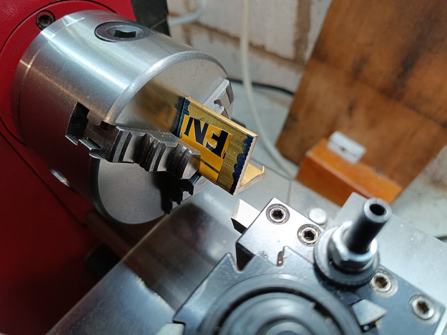

Facing the angle (there's something strangely satisfying about holding angle in a 3 jaw chuck!)

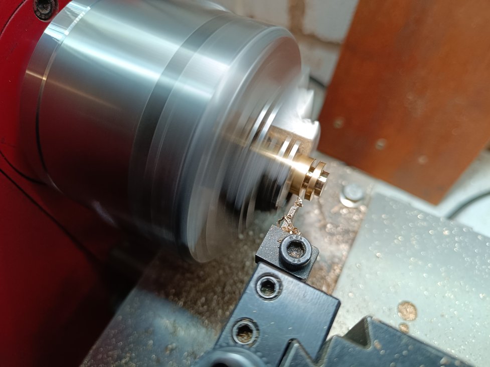

Parting off one of the end caps. Had some nasty squealing when I started but it disappeared after regrinding the tool

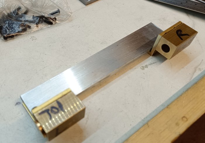

The parts so far. The angle will fit on top of the base, just arranged like this for a blurry photo!

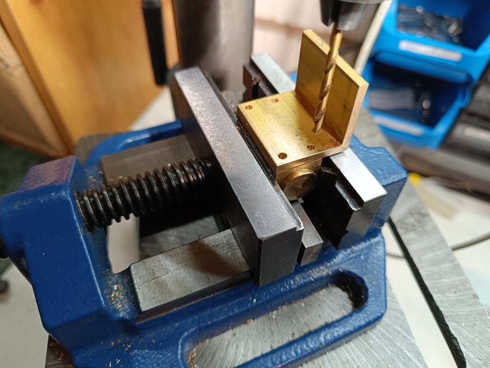

Today was just a case of marking out, drilling and threading holes. I've ordered some copper tube to connect things up, in the meantime I can start on the pistons and rods and try to figure out what to do in the middle bit!
