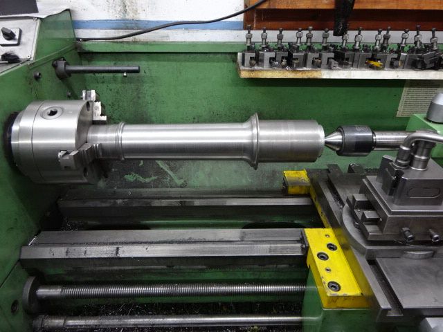

Online Sanjay F
  • Posts: 1985
Re: How to make a form tool?
« Reply #20 on: January 29, 2026, 07:28:41 AM »
I was looking at this picture on MEM from a previous build and it looks like both ends have been supported with wooden plugs; looks a good way of holding and machining the beads.
I'm not sure how they are physical attached to column or what is happening at the tailstock end? Is it a live centre?
  • Posts: 11120
« Reply #21 on: January 29, 2026, 07:52:22 AM »
It may be possible to simply expand the chuck jaws inside the base of the casting (might need the 4-jaw to true it)
Rough shaped (turned) hardwood bung with a bit of taper can be driven into the casting and won't move
Looks like a revolving ctr that can take different "points"
Online Sanjay F
