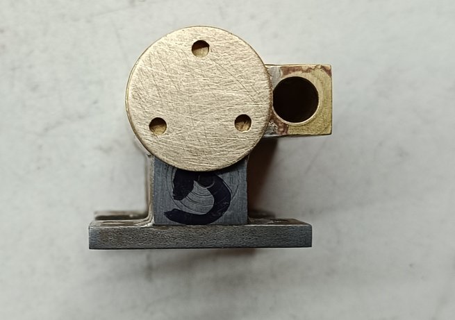

Taking the advice of forum experts I decided to screw the two parts together to eliminate any movement during soldering. Slight issue, I didn't have any small brass screws or a die for anything less than 3mm so I made some grossly-oversized-for-the-job screws which will be chopped off and made to disappear later. There will also be plugged holes just to the outside of them where the ports will be drilled at each end of the cylinder. Second photo shows where the cylinder support will go. If I've done it right, the complete circle of the cylinder covers will just miss the valve bore.

After making parts for two different designs of cylinder support and changing my mind I settled on this one which, it turns out, is probably just as bad if not worse :Lol: The steel parts were screwed then soft soldered together and the whole thing soft soldered to the bottom of the cylinder. Getting it all lined up for soldering (and not having room for screws into the cylinder) was a royal pain in the a**e. Of the dubious designs I've come up with over the last year this set of parts is undoubtedly the worst. Anyway, it's done now and should be ok as longs as it holds together!

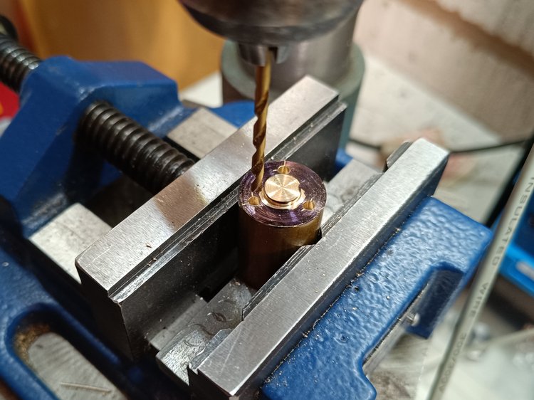

In another short session in the cold workshop I made the simple outboard end cover for the cylinder. Turned the spigot and used the home made detent to mark off the holes. Switched to the drill to make the holes then back in the lathe to part off. I'd previously slimmed down the parting blade and didn't realise until I was nearing the end that the original fatter part would need to enter the cut  :Doh:  :Lol: No biggie, I just sawed off the pip and filed/sanded it away.

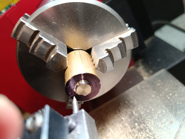

Made the cover with the guide and the gland nut but need to undercut the thread on the latter a little more and maybe shorten it a fraction. Slightly blurry photo attached. Next up, the 2.5mm threaded holes in the cylinder for the securing screws. apart from the piston, I've pretty much caught up with my plan now so I better get stuck in and draw up some more parts!
