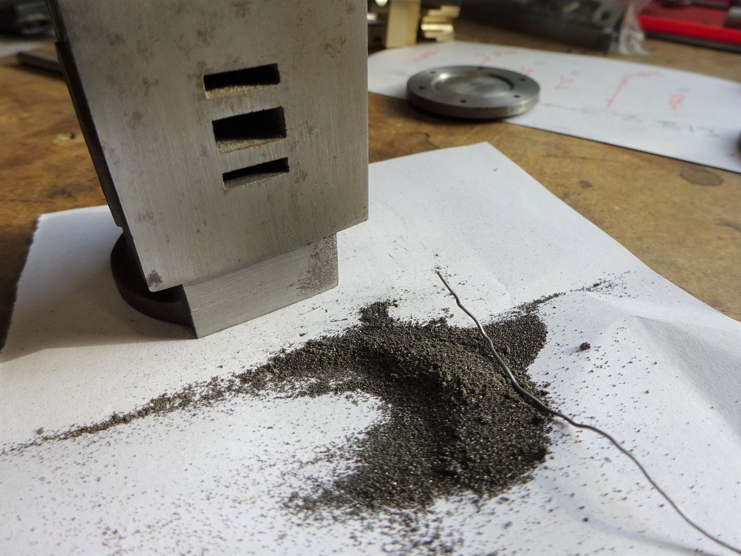

I got everything I could think of looking right, port openings equal either side, loosened the valve nut in the valve, got the timing worked out, no resistance anyway and guess what .......................dead as a Dodo. 2hrs later and having played about some more, still nothing until the airline popped off and nearly hit me in the face ....... again!
The air wasn't even getting into the cylinder so I started having a poke around and couldn't believe what came out.......black sand, the sand you get with new castings, both ports were blocked solid with it (see picture). This was definitely sand not the oily gunky residue you get with old engines (I know that too well). It took ages to get it out I had to clean everything as it was everywhere. I'm so confused how can both ports still be full of the original casting sand?
Anyway, here she is running, still needs the the link arms shaping and an oiler for the beam; I must admit its very hypnotic to watch and I've been doing that for quite a while!!  ;D

Quite common and I often mention it to people building from castings with cored passages. The core sand has stronger binding agents added so does not come out easily and not being seen has to be dug out. Falls out easier if it has not been soaked in oil and rust remover :lolb:

So Sanjay, do you think the engine had been run before?  :headscratch:

That's what crossed my mind too, I honestly don't know; it came in an odd condition with most of it machined and the rods missing having snapped off in the clevises. Maybe someone put it together and never got round to finishing it or running it, hence the ports still being full of sand?

The sand can help with running in as it helps get rid of any tight spots :LittleDevil:
I suspect the previous builder got it all made and then threw it across the workshop in frustration of not being able to get it running due to the blocked ports and that broke the links as it hit the workshop wall :lolb:
