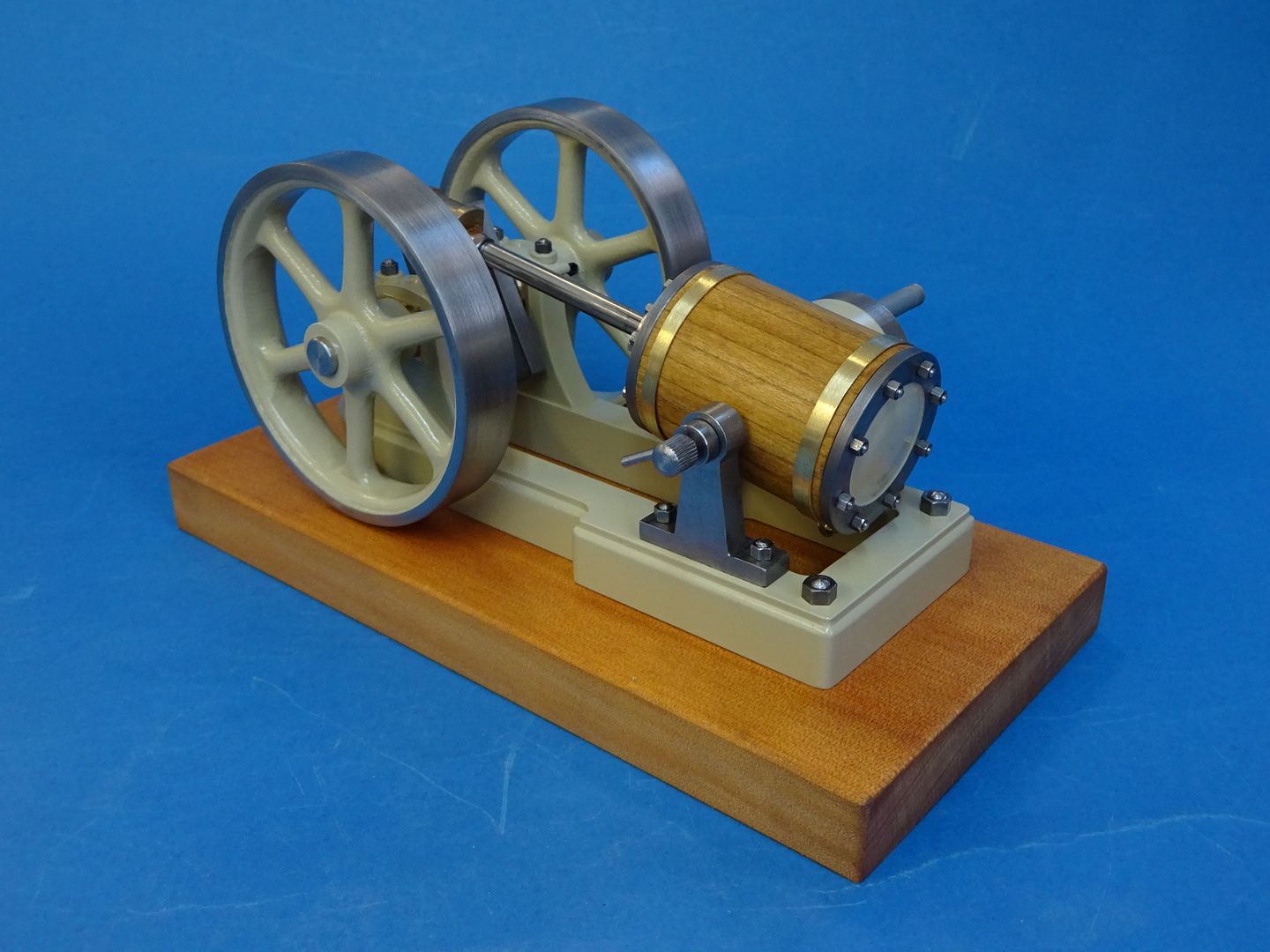

Progressing Well but never too late to go with a vertical, this popped up last night and I thought of your cylinder. I think it mast have a form or rocking or rotary valve on the trunion but a nice looking engine.
That is VERY very tempting, Jason. What a great looking engine! I would love to try making those castings. But for now I think I'll stick with the horizontal, just because I've always wanted to build one. But I might circle back to that vertical some day!

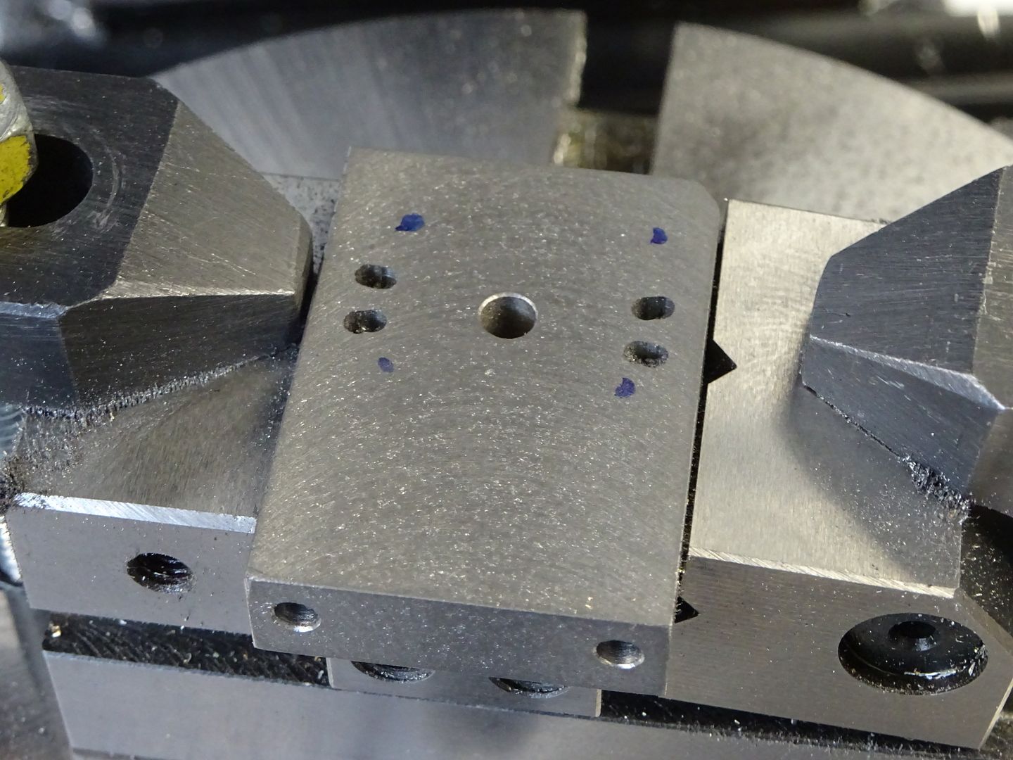

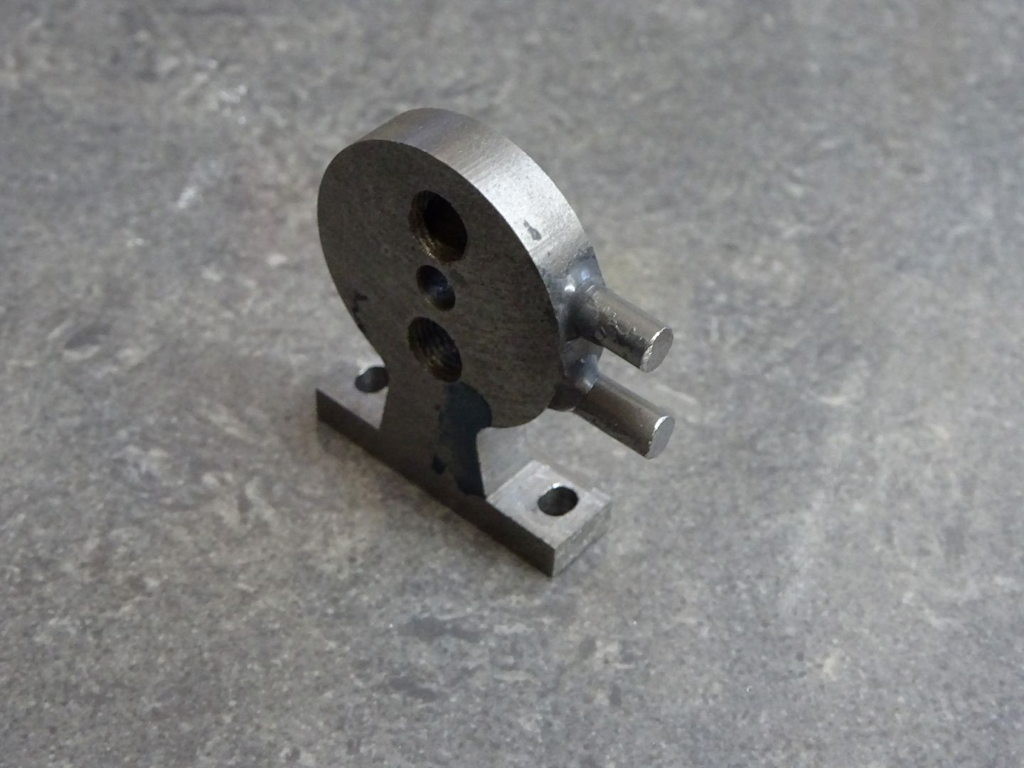

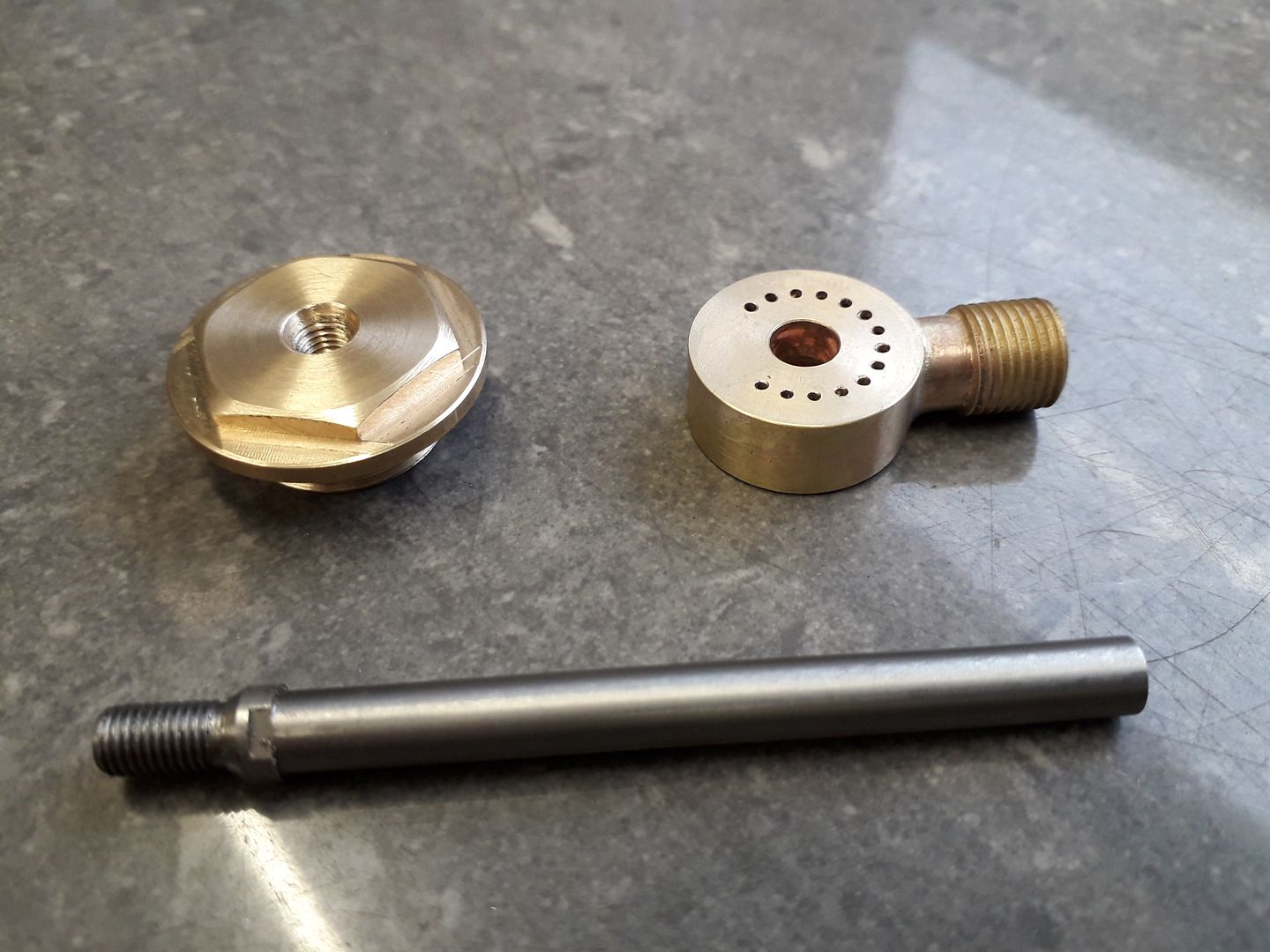

The horizontal one has drilled and plugged passages but uses the screw on the other trunion to hold the cylinder against the port face not a spring

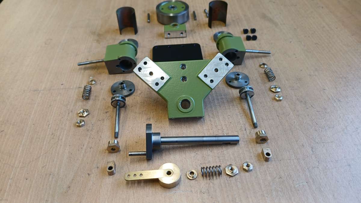

I have similar springs on the Vee twin I did a couple of weeks ago, similar drilled passages but no relief of the port face. They are closed up by a similar amount to the single.
Another one with plugged drilled passages and unrelieved portface

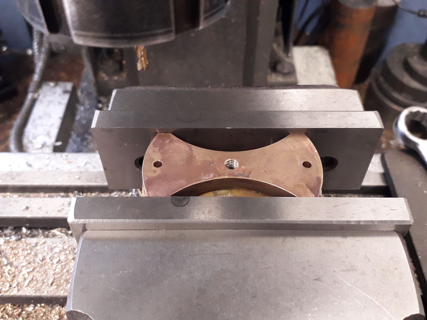

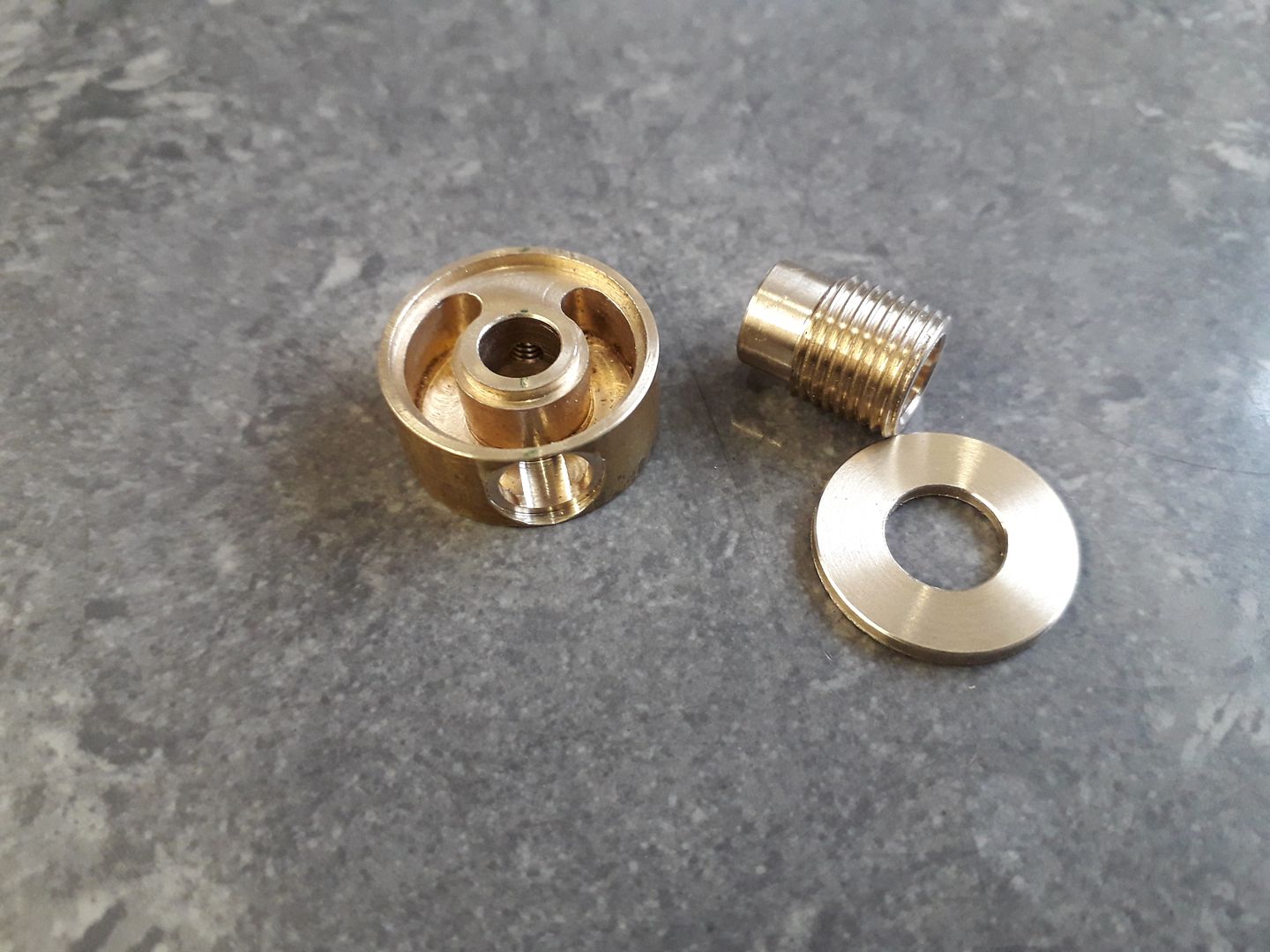

If you are worried about the half moon shaped ports as well a sthe drill and plug method you can also make the port with a separate face. Mill or cast the half moons into the trunion bracket then fit a separate disc to the front say 1/16" thick that just has the four holes/slots. If you machined a recess in the trunion blocks face say 0.055" deep then it would hardly show on the outside that you have a two piece assembly.
Similar idea to this where I wante dto get gas all around

Thanks Jason, that's a wealth of helpful photos. I was also thinking about the plate and channel idea, and it might have an advantage in that you could experiment with timing by how you milled the ports. It would be easy to change the plates to a slightly different configuration from the starting symmetrical timing. I don't know if I'll actually do that, but I might when I get to that stage.
I do kinda like the screw instead of spring loaded trunnion, even though CI was mentioning the change in clearance from heating up. I think if it's a stationary work engine running at steady speed it could be okay if there was a little more clearance when starting than when running. I guess you could add a spring if you didn't like the screw method after trying out anyway. Not a big change.
