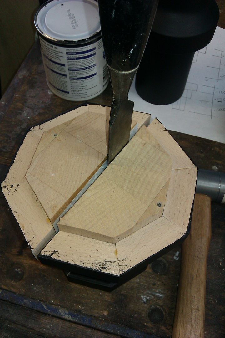

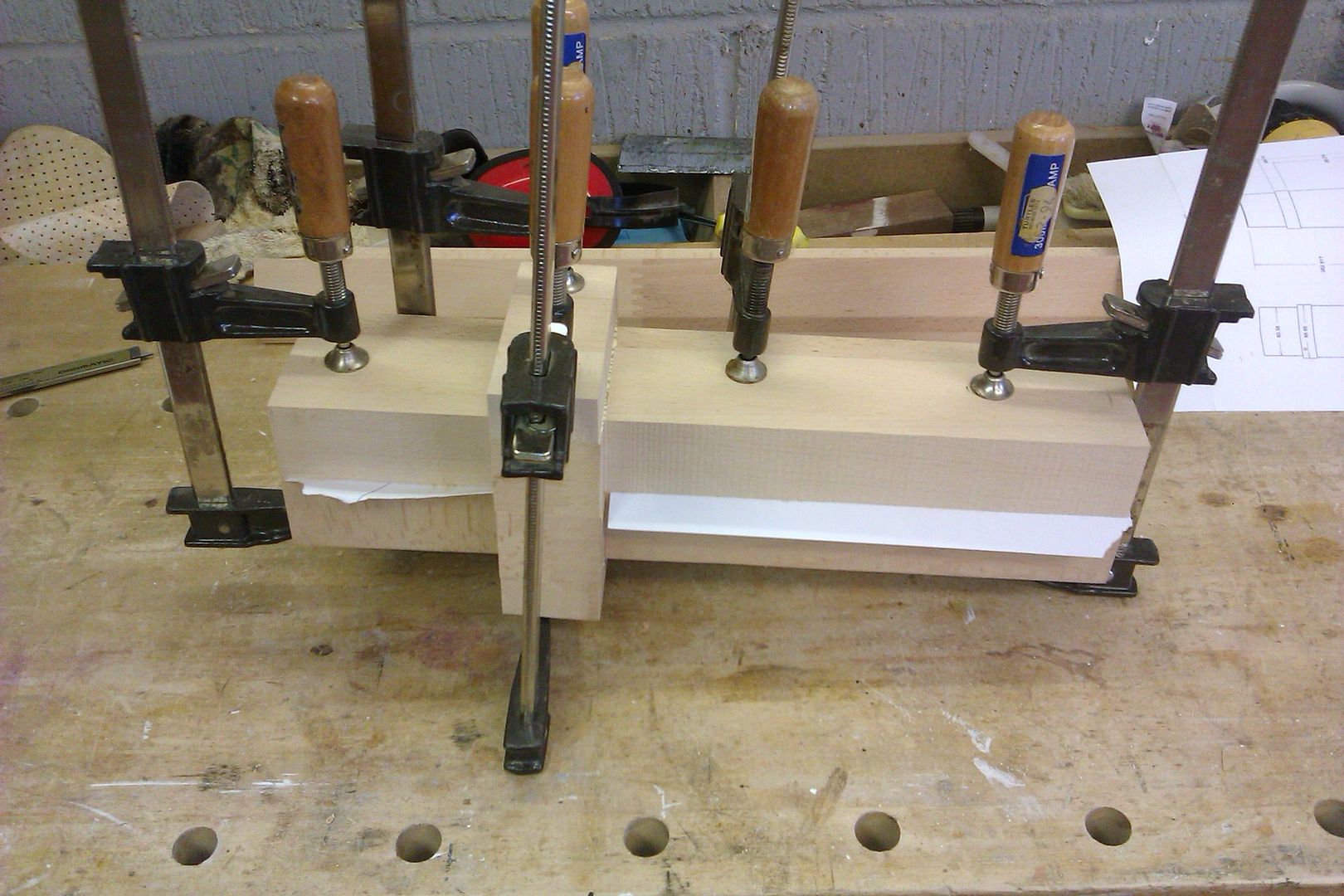

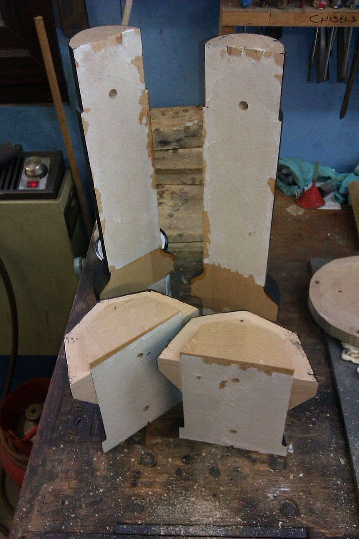

You could glue the edges of two pieces of wood together with a sheet of paper sandwiched in the middle. Then cut with your holesaws and provided you lined the paper joints up as you assembled the discs the pattern would then split apart at the paper joint. For the thin discs I would just put a clamp on them while sawing as you don't have such a large glue area and the hole saws are not the most delicate cutters.
I use this method to glue blanks together before turning or machining and also to hold blanks to sacrificial boards so I have something to hold.
Before splitting apart drill right through for dowel holes then they are sure to line up. Just needs a chisel to start the splt and they all come apart easily.
