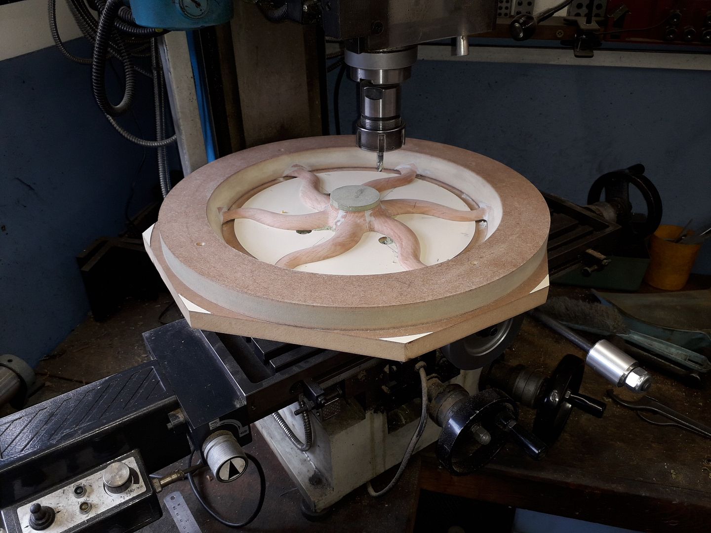

Thanks for the ideas, Jason. I looked into it further last evening. I have only used the SketchuCam add-on with SketchUp 8 (the old Google free version) That's only a 2.5D cam addon. I do have an STL output addon for that old SketchUp version, and did a couple times successfully run its STL file output through Cura slicer, to produce a 3dprint.
I use Linux, and run LinuxCNC (old version) to work with the router.
I watched this and this guy's related flwheel videos last night.
 <a href="https://www.youtube.com/watch?v=31pdXyVm3hg" target="_blank">http://www.youtube.com/watch?v=31pdXyVm3hg</a>
And gave a lot of thought to whether I want to go this route rather than simply carve out a pattern. The running of a machine in an unheated shed for 2-1/2 hours in below freezing weather while standing around watching it is not something I want to do, and I'm not comfortable just leaving it on its own, if past experience with issues is any guide. And that 2-1/2 hours is only half the pattern. The location of the shed where the router is located is 300 feet down hill from my house over what is presently ice covered dirt drive. I can't just look in every 10 minutes.
What I'm favoring now is a hybrid route -- have the machine make a kit of parts that I can assemble into the flywheel: a hub, a rim, and spokes (all in halves for a split pattern). This would cut the jobs down to reasonable chunks of time, and I believe the toolpaths could be optimized better for each shape, and with less waste cutout time. I also favor doing fillets by hand on the pattern, rather than trying to program my limited CAD 3d program to do that in the most complex areas -- though I won't know until I try how far I can get, with those -- we'll see.
I did find a free version CAM program that works in Linux and accepts STL files that I think I'll try called DeskProto. In fact I did try it at home, manipulating an object for cutting on a quickly drawn spoke to see how it works, and I think it will be adequate for doing what I want with this flywheel.
So that's the tentative plan, a half cnc, half human job of it which suits my quirks, and shop situation, in the cold.

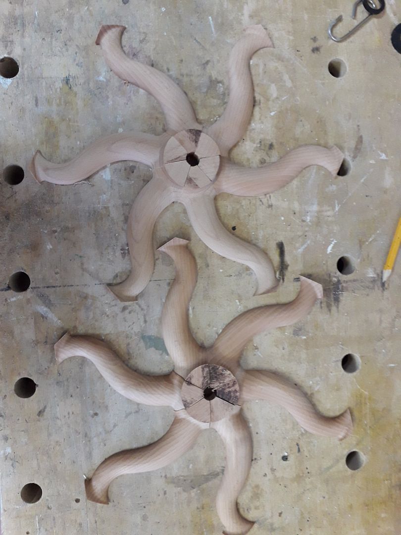

I have done similar on larger flywheels doing the spoke and a segment of the hub as one part cut multiple times. Hopefully if you watch the first one and it runs OK you are less likely to need to watch the remaining ones.
Rim could be done on the lathe or a rotary table on the mill and then just glue it all together.
I include all the fillets as the CAM works out all the paths whether it's a curved spoke or curved fillet does not matter to the software.
Don't forget if doing curved spokes you need a right and left hand set!

Wow success on all fronts!
When the deliveries hadn't arrived this afternoon, I got tired of waiting, and decided to just try a CNC cut with what I had on hand, which meant a 1/8 square nosed cutter used for aluminum, an old discolored piece of 1/4" birch plywood for material, and a CNC file of the spoke generated by DeskProto at a low resolution. I didn't expect much. Maybe a ball of fuzzy plywood splinters from the core or a burning smell, and at best a rough approximation my oval spoke
As a second thought after Deskproto had created the cut file, I went into the G-code and changed the default feed rate from 40 IPM (the default) to 20 IPM with a text editor. I didn't want to break the bit -- an Amana single flute up cut. I ran my spindle at it's highest speed and just figured I'd check for burning and slow it down if necessary.
I stuck the ply down with some double sided tape (which I figured didn't have a big chance of holding at the 35 degree shop temp, but the hell with it, I want action!) I zeroed that axes. and then just let her rip.
Well heck, everything behaved perfectly. The piece was machined without issue. After I removed it and dusted it off, it seemed it was even useable  as a part! The plies were of good quality wood so no splintering and just slight fuzzies on the climb milling side, which could be easily sanded off. So, okay what about another? Well why not...I just jogged the X over, re-zeroed that axis and hit go again. And it cut another spoke half!
By then I was happy enough to want to quit, and take a closer look at the pieces in the house. But first might as well check the package box at the head of the driveway. ...Well, whadya know, all my late packages (5 total) were delivered, too!  :whoohoo:
Well, seems silly to get excited over a couple little sticks of wood, but I admit that I am, and here they are, two halves that I'm holding together, as machined, without any sanding or cleanup. Plywood, no less. I have on hand cherry, birch, basswood lumber cut from trees on my property, much better for carving, but surprisingly, the plywood test material looks really quite usable out of this router.
I've also just realized that tho the DeskProto CAM free edition doesn't have a good toolpath for the rim, (supposedly it would take hours  :hellno: ) my onboard SketchUp add-on is a 2.5D capable g-code generator, and able to program it and provide a fast toolpath for that kind of shape. So really I can do the pattern, I think, as a kit of parts from the CNC router.
