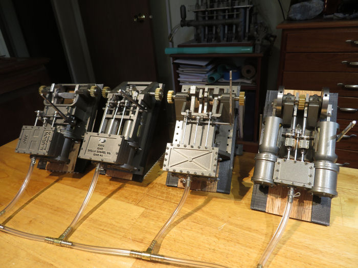

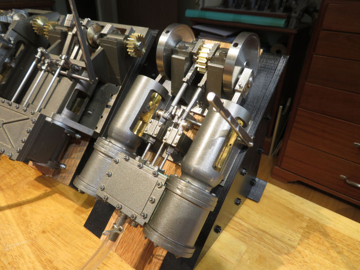

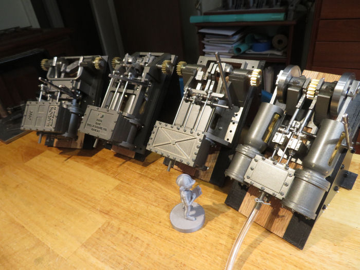

And we are there! Got the drain valves made, just a small turned globe-valve shape with a length of screw loctited in, too small to be practical so they are just dummy valves. Painted them, touched up a few scrapes here and there, and got them plumbed up with a common air line. I can run them on my compressor all at once for a little under a minute before the pressure drops too much. The compressor cannot keep up with refilling the tank with all four going, and I had to take the needle valve out of the air line since even wide open it was restricting the flow too much.
First some videos of them all running:
<a href="https://www.youtube.com/watch?v=sE1n4puVqiE" target="_blank">http://www.youtube.com/watch?v=sE1n4puVqiE</a>
<a href="https://www.youtube.com/watch?v=lPA-_UWsC4k" target="_blank">http://www.youtube.com/watch?v=lPA-_UWsC4k</a>
And pictures of them all:

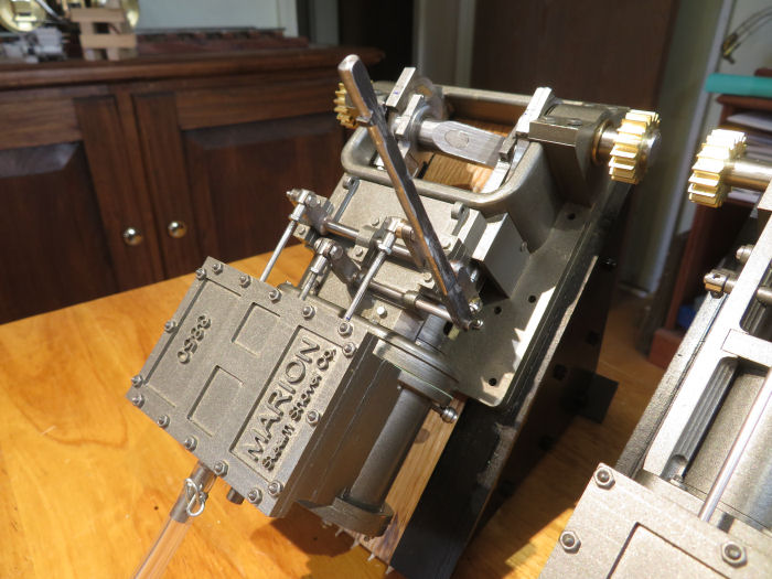

Marion:

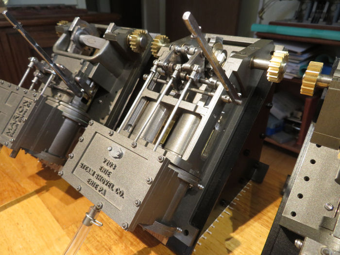

Erie:

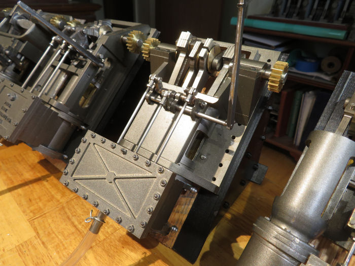

Bucyrus:
And the Thew:
That completes this build. Been a really fun one! I need to decide where they will go on the display cabinets. Either in front or above the Marion steam shovel in the shop, or somewhere in the Engine Room. Not sure yet.
