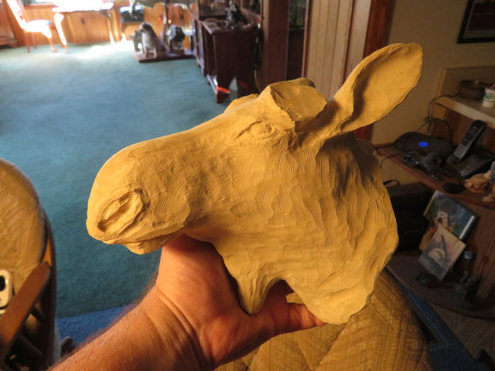

The last couple few (now that I check dates on the previous picture of it) weeks I have been cleaning out and rearranging the basement, which is where my woodcarving station is, so I have not had a chance to do any more on the mooshead carving. That is all pretty much done, just taking loads of scrap lumber out a load at a time for the trash collection. This afternoon finally got some time to refine the face of the moose, started out at the lips/nose and worked my way back to the eyes and around the head. Different shape burs with the Foredom flex shaft machine for each area, smaller ones around the lips and eyes, larger shapes for the rest of the face and neck. Here is where its at now:
Looking a lot more moose-y now! Still a bit more fine detailing to go, and it will be ready for woodburning in the fur. Still need to carve the antlers, they will get attached last so there is plenty of angles to access it for the woodburning pens.

That's a good-looking moose, Chris!   :popcorn: :ThumbsUp: :popcorn:

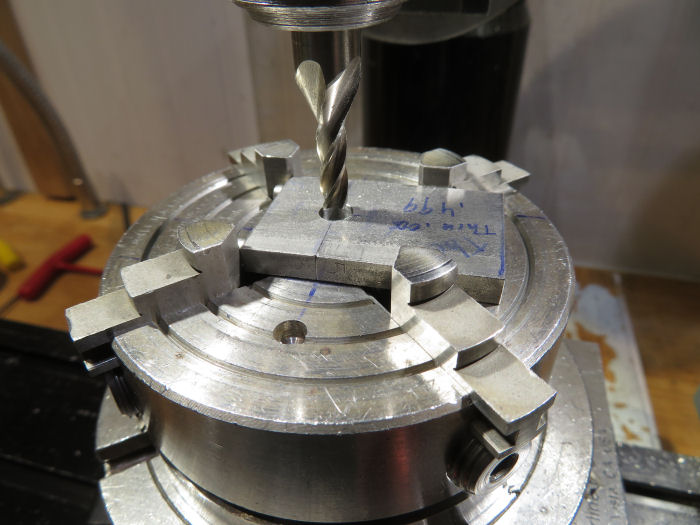

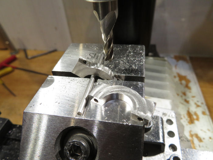

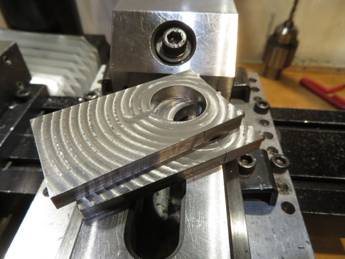

The Erie eccentric straps have been bored out and thinned to size,
and have started on the last set, for the Thew:
After they are bored out, I can start shaping the caps...

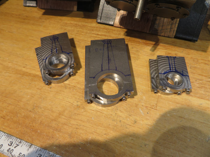

Today has been Cap Day, shaping the caps for the eccentric straps...
So far 3 of the 4 pairs are shaped...

Those are some nice caps there!  :ThumbsUp: :popcorn:
