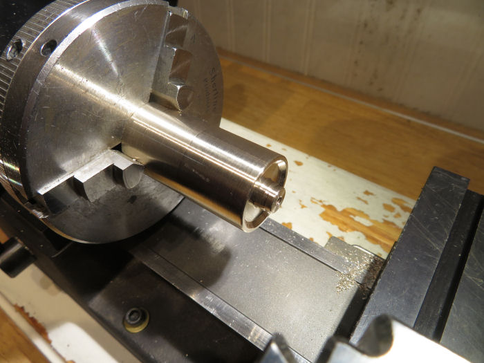

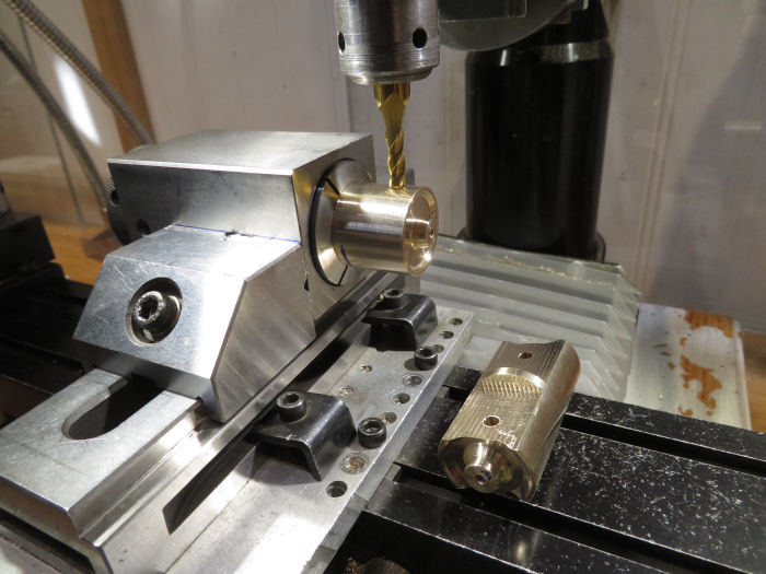

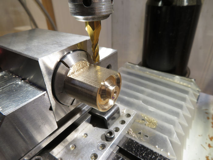

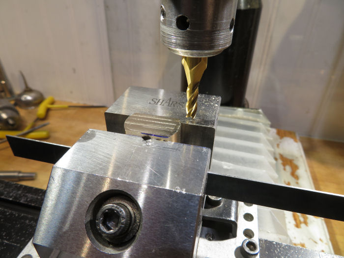

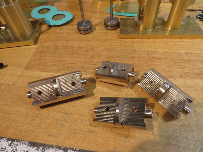

The rest of the crossheads have been shaped just like the ones yesterday...

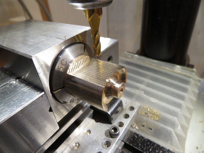

and have started milling the flat sides of them. A collet in a square block makes it easy to do one side of the bar,
then the other by flipping the block over in the vise

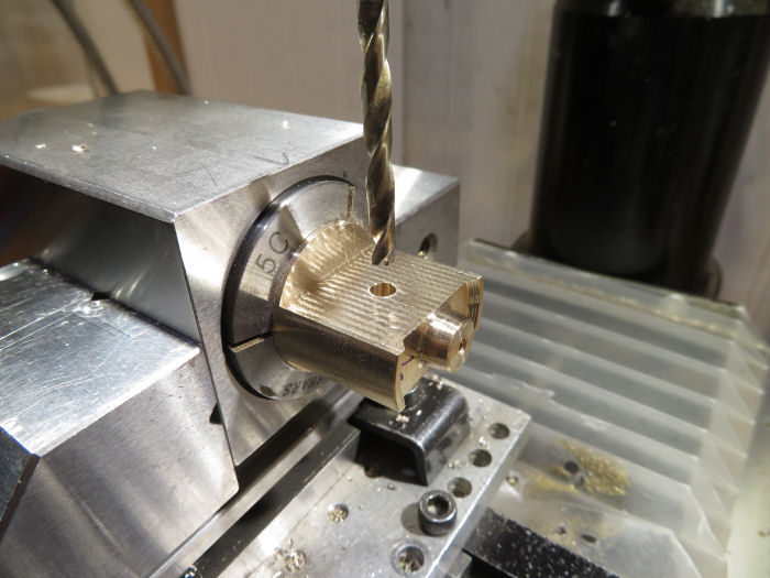

I'll drill the hole for the wrist pin before removing the bar from the collet to ensure that it is perpendicular to the flats, then flip the bar around in the collet to do the same on the other end, finally cutting the bar in half to separate the two crossheads for shaping the last end...

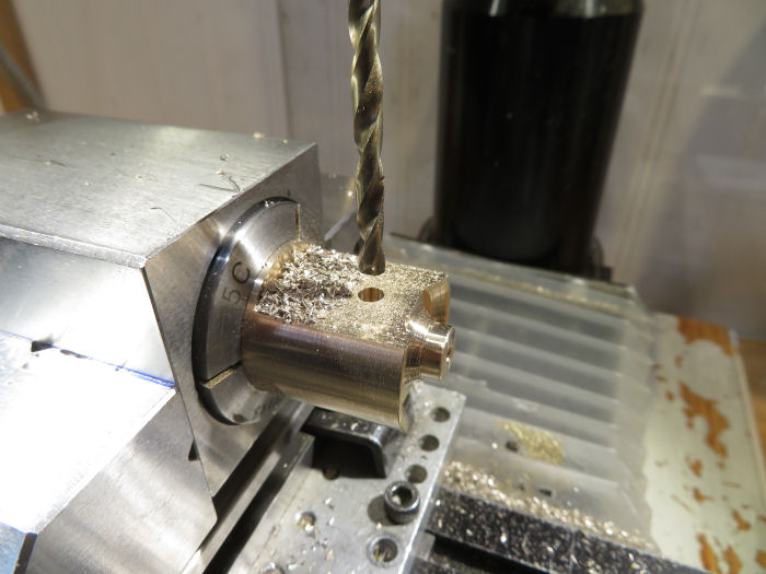

After lunch, drilled the wrt pin hole in the first end and got the other end of the Marion crosshead bar shaped down and drilled its hole...
So thats one pair down, three to go. Next up is the Thew, since its got the same OD crosshead as the Marion did so same collet...

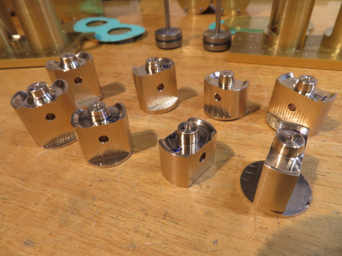

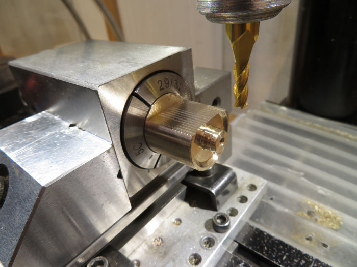

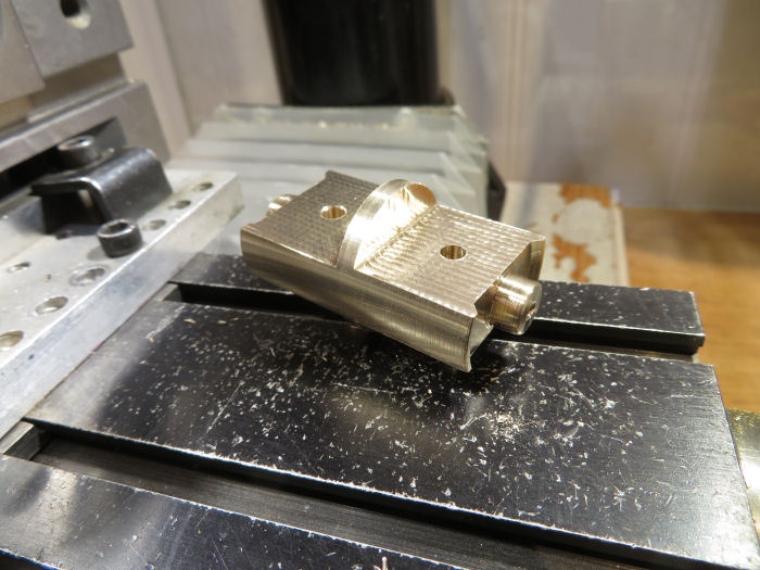

« Reply #354 on: February 05, 2026, 02:16:57 PM »
The Thew crossheads have been milled flat/drilled just like the Marion ones were, though you can see the Thew ones have a thinner profile:
Swapped collets for the smaller OD Bucyrus crossheads, and have started shaping them...

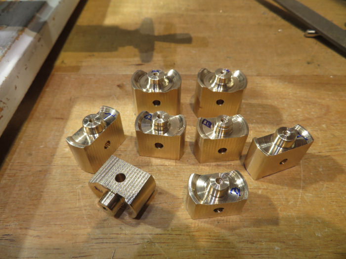

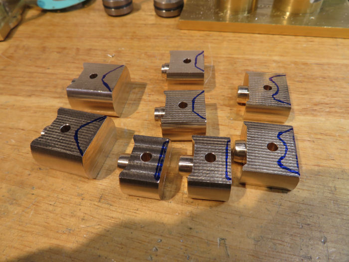

  • Posts: 22540
« Reply #358 on: February 06, 2026, 03:16:44 PM »
All of the crosshead bars have been flattened on the sides:
so they were sawn apart
then trimmed to length
giving a herd of partially completed crossheads:
Still remaining is to cut the hollow in the ends for the con-rods, and shape the bases to final profile. I was going to do the hollow ends first, but without cutting the profiles, the cuts would be too deep for small/narrow end mills. So, I'll at least have to rough in the profiles on the longer ones first. To that end, I sketeched on the shapes that need to be cut in for the profiles, different for every manufacturer:
The Erie ones, bottom/center, just need a shallow notch, the others get a more complex shape. They did this to save metal on the castings, and reduce the moving mass.
