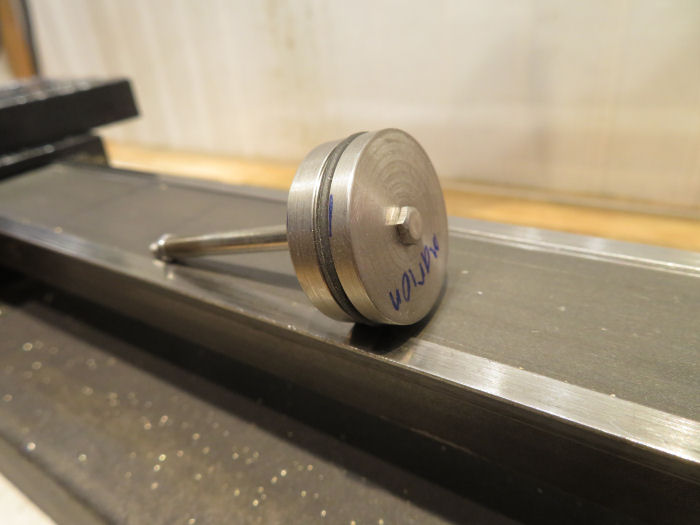

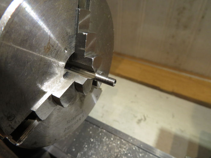

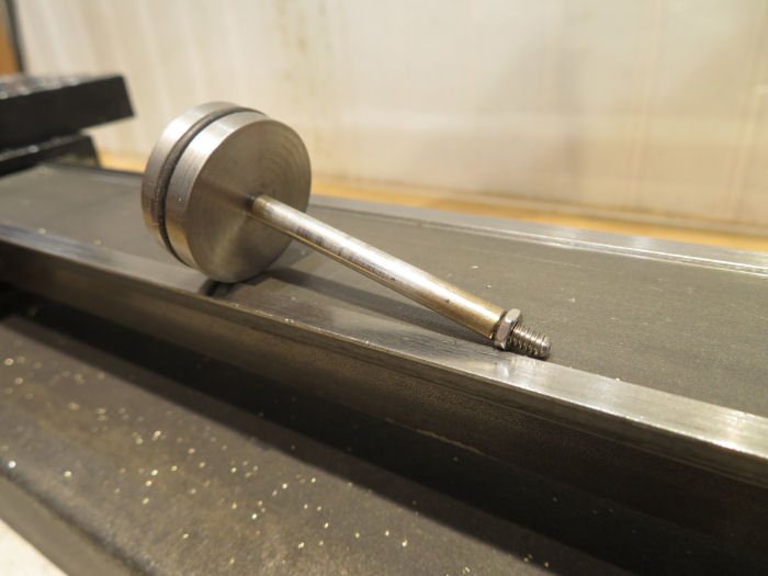

The shop elves got the blanks for the piston rods cut to length this morning, and made me up a chart of lengths of end steps for each one. Then we started in turning the ends of the first pair of rods, for the Marion engine. The ends were drilled/tapped for a retaining screw, and the outer end turned down for a post to be a close fit into the piston. Hard to see the step in the picture once scaled down for the forum, but its there. The step and the screw will capture the piston in position and keep it aligned. On final assembly I'll add some loctite to that joint.

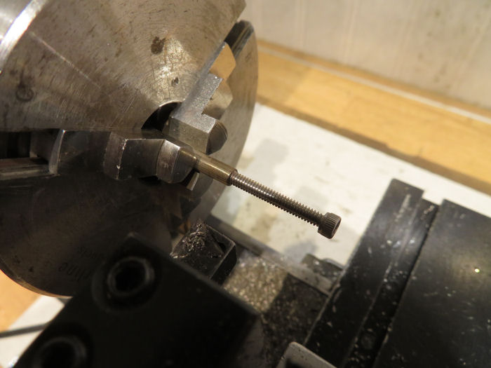

Then turned each one around in the chuck and drilled/tapped the crosshead end, and loctited in a screw that will go into the end of the crosshead.
The screw was then cut off, the burr from cutting filed off, and a nut run on to check the threads. I like doing threaded ends like this since it gives clean threads right up to the shoulder with no undercutting required like if it was cut with a die. Also it takes less force to tap for the screw than to thread the end of a post, reducing the likelyhood of the thin round part spinning in the chuck.
This angle shows a hex head screw run in to hold the piston end together.
So far two pistons done, six more to go...

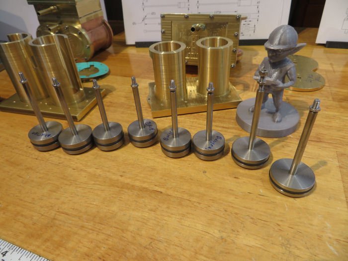

Thanks guys!  Just finished the second pair of piston rods, for the Erie engine. Miss Bucyrus is up next...

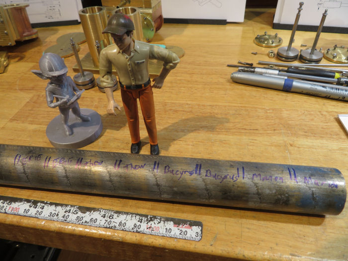

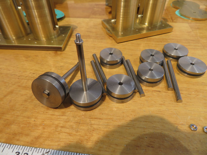

This morning I got the rest of the flock of piston rods made:

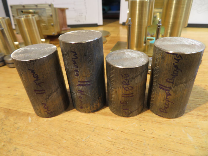

So, up next will be the crossheads. The elves makred out the lengths needed on a piece of bearing bronze rod:
before taking it to their pet metal-eating goat, Bea Andsaaw (say the name fast, you'll get it  :Jester: ) to cut it into shorter lengths. Each is long enough for two parts, so I can use one end to hold in the chuck/collet/vise while working on the other end.

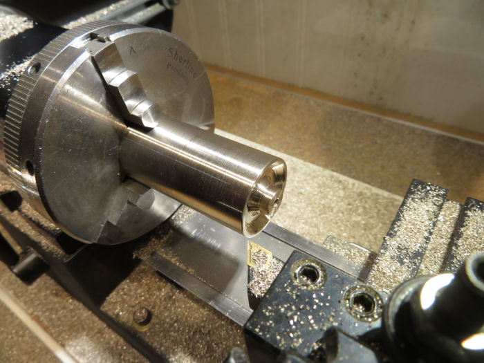

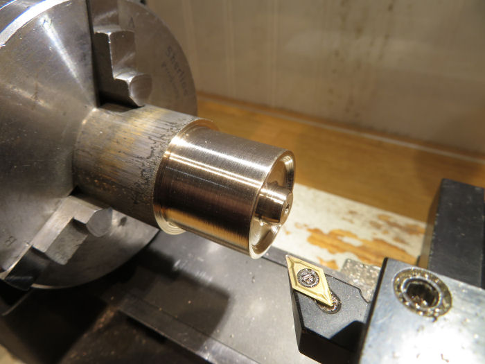

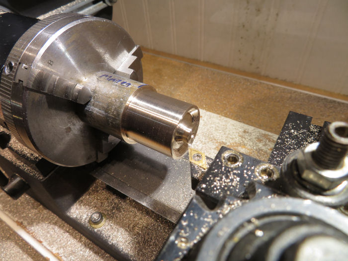

Started in shaping the crossheads. First up were the ones for the Marion engine. The first end of the bearing bronze bar was trued up at the end, drilled/tapped for the piston rod, then the OD taken down to be a sliding fit into the guide tube, and finished off with shaping in the end that will be towards the cylinder. Took several tools to do that end shaping.
The bearing bronze cuts like warm butter, even smoother than brass, but with finer chips. Nice stuff. The blank was then turned around and the same done on the other end for the second crosshead:
I'll leave the two parts together for now - that will let me hold the bar in a collet block on the mill to flatten both sides and drill the wrist pin hole. Once that is done on both ends, it will be cut apart and shaping on the crankshaft end of each can start. For now though, on to the same steps on the Thew crossheads. They are same OD, but with a different shape on the end and overall will be shorter.
