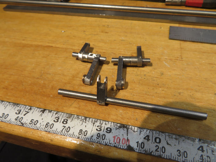

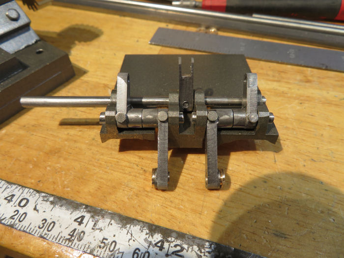

Got the levers for the Bucyrus engine fixed this morning, and made up the new throttle lever. Here they are:
They were all located on the shafts, then drilled/tapped for some 2-56 screws to lock them to the shafts. Here they are assembled on the engine top plate. Still need to make the longer hand lever for controlling the throttle, it will go out on the end of the long shaft sticking out on the left in the picture.

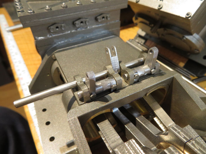

And here they are in place on the engine. The lower end pivots are not connected to the ends of the eccentric strap arms yet.
Installing the bolts on the lower pivots to the eccentric arms will be next. going to take a break and tackle that this afternoon - likely will have to take apart a few things back by the crankshaft to be able to get a wrench in to run in the bolts. On the full size engine, they could just reach in the opening. Tried getting the elves to do it, but they were out partying with the moose last night, and they keep dropping the screws and wrenches.   :shrug:
