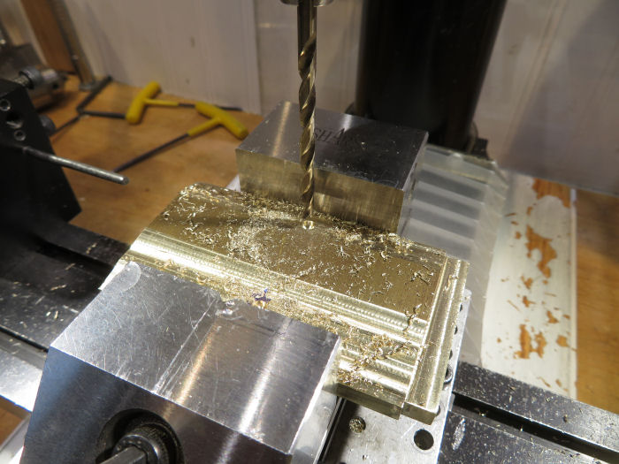

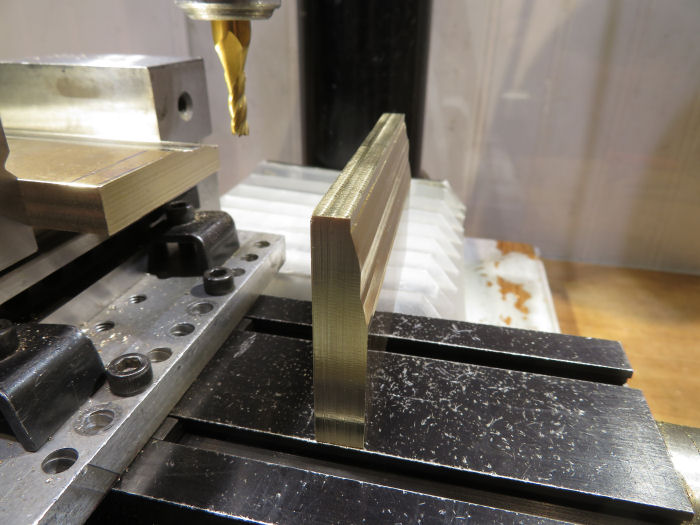

More shaping on the side panels. The lower corners were given a reverse-curve shape, by taking several passes with the lower edge blocked up to different heights to change the angle.
Here is the shape after 5 different angle/height settings. Each side was cut the same at each setting before moving on to the next angle so they came out the same.

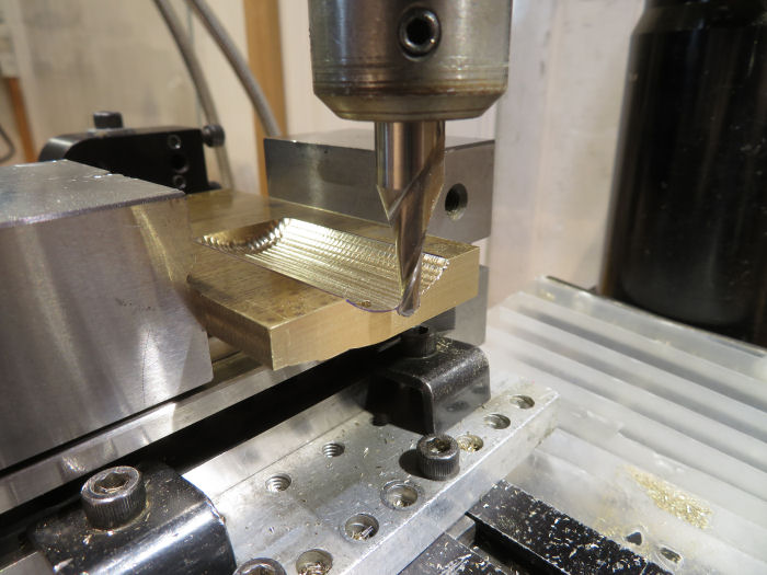

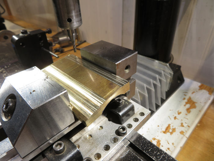

The inside faces also had to be shaped to fit around the crosshead tubes, taking a series of cuts with a ball end mill. A line was traced off the end of the tube to mark out the shape needed. This curve will be covered by the tubes, so a very smooth surface was not needed.

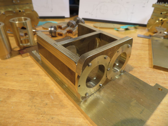

Test fit of the parts so far...

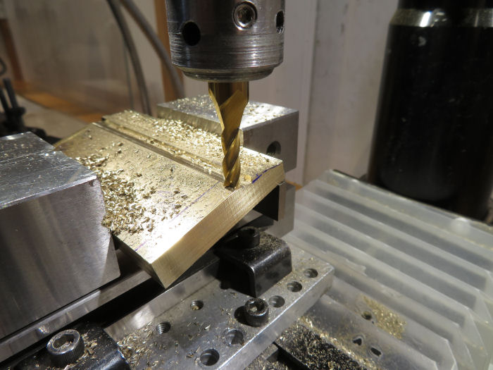

Then cut down the top corners of the side panels:
The top of the rear bulkhead was trimmed down to match the height of the side panels, and the top corners of the front bulkhead were tapered/rounded on the belt sander:

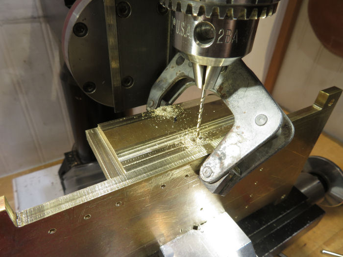

At this point the holes for screws to hold the panels together were drilled, starting with the ones for the rear bulkhead. The holes were countersunk in for socket head screws, these holes will be plugged later.
With everything clamped together, the holes in the side panels were used as drill guides to drill/tap into the rear bulkhead:
With those screws in to hold the rear bulkhead, the holes for the front bulkhead were then drilled/tapped

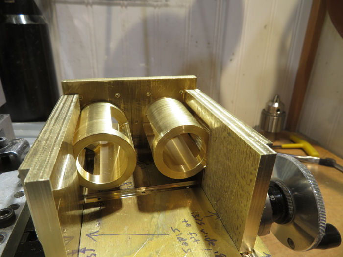

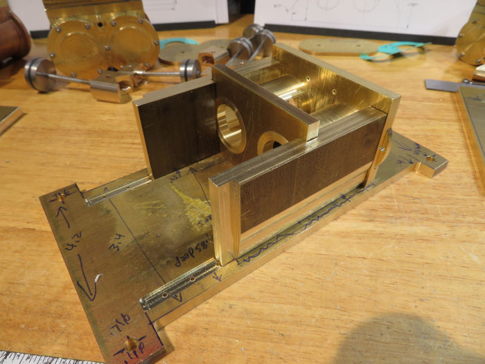

The parts so far. Not quite ready for assembly though. The tops of the side panels need to be thinned down with a ball mill on the inside corners, the windows through the side need to be cut, and the mounting holes through the base into the panels need to be drilled. But, good time to show where its heading:
At the rear, the right hand side of the previous photo, another set of blocks will be made later to become the crankshaft bearing holders. This one is also looking more engine-y now!

They were generating a lot of torque on the output shaft, and took shock loads as the bucket hit rocks, so I imagine they built them sturdy.  The model is getting hefty too!

I assume when assembled, the cylinders will pull up tight to the crosshead guides, so there won't be that little gap there?
  • Posts: 22717
« Reply #430 on: February 14, 2026, 06:36:58 PM »
That's looking great, Chris!  :ThumbsUp: :popcorn: :popcorn:
Correct. For now there are temporary  screws holding the crosshead guides to the plates, the heads are keeping the cylinder out. I have tapped the screw holes at both the cylinder flange and and also the end plate end to facilitate  this. The last thing to do before final assembly is to drill half of them out to clearance  size. Some at the cylinder end, some at the guide end, depending  on which way the studs can go in. The steam chests are in the way on the upper ones, so those go in from next to the guide tubes. Lots to keep track of!

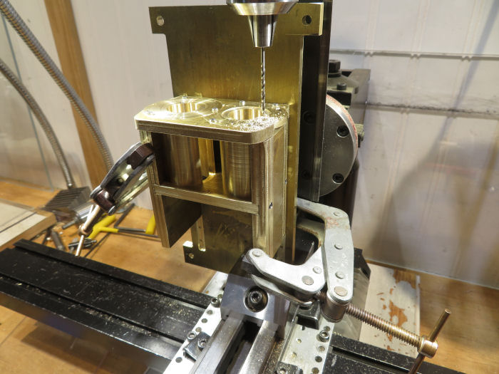

Close to assembling the Erie parts. Got the holes tapped in the frame and the ones in the base plate drilled out to clearance size to attach the crosshead guide parts:
and cut the windows in the side frames. Used the clamping arbor again to hold them to cut the end radii after marking out the locations from the tubes, and drilled a hole in the centers of the arcs.
