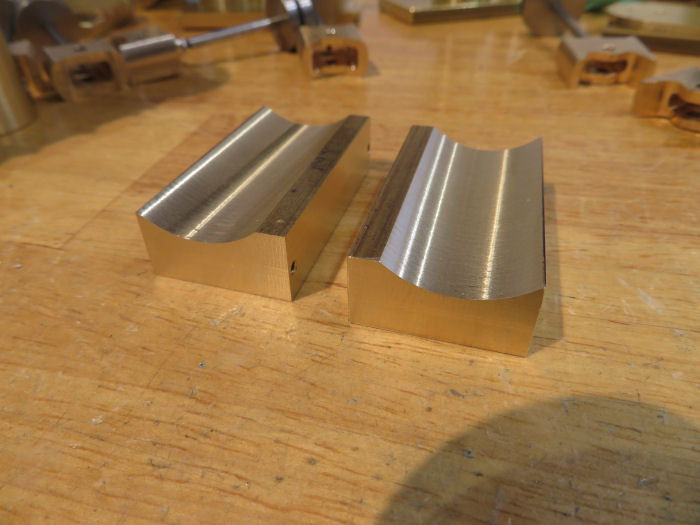

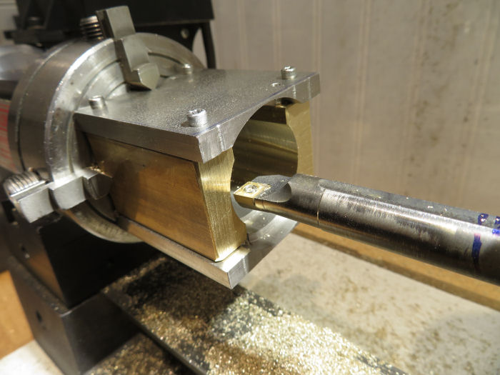

Yesterday I worked out what bar stock to use for what engine, and rough cut some of the pieces for the main frames. I am going to start shaping with the Thew engine, and get the base plate and engine supports done on that one before moving on to the next engine since all the engines have such different frames that there is no point in the mass production methods. The Thew frame is unique among this set in that the crosshead guides themselves make up a larger part, with the tubes connected in to the base plate - on the original, they were likely cast as part of the base. So, I need a pair of blocks with circular recesses to hold the tubes. I got out the same steel plates that I used earlier in the build to turn the recesses:
After turning, the sides/ends of the blocks were trimmed to final size, note how one side next to the recess is milled away. That will be the outside edge, the center between the blocks will get more pieces.
Here is how the crosshead gudies sit in them...

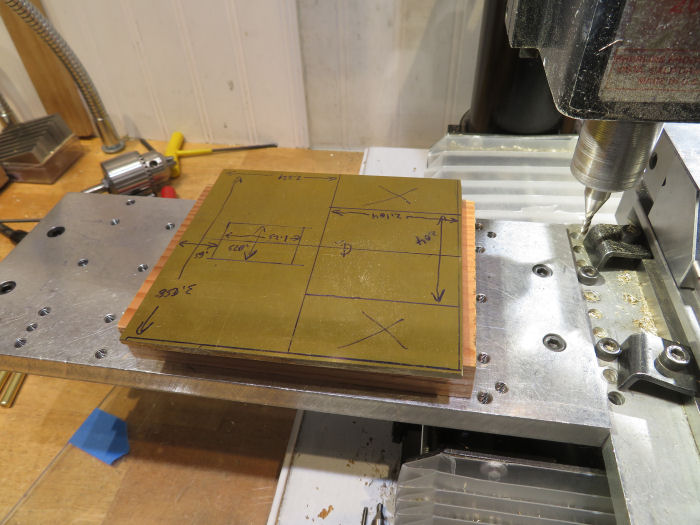

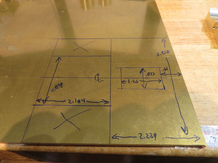

Next laid out the base plate on some brass plate left from a clock project. This is C353 brass, the good stuff!
Here is how it will be arranged - there will be blocks holding the crankshaft on the narrow section on the left:
The piece was rough sawn from the sheet, and is ready for milling the profile:

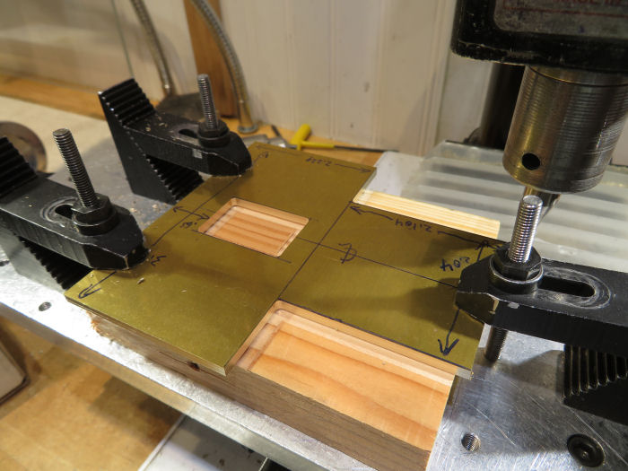

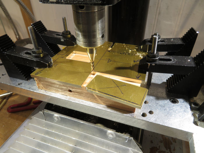

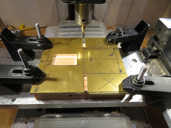

This afternoon, with the shop elves back from their faux-tropical vacation, we got more done on the Thew frame baseplate. With the blank squared up on the fixture plate and clamped in place, milling started on the outer edges. Here the right end and the near-left end have been trimmed to size from the rough-sawn cuts, then did the opening on the left center, and cut the two slots in the middle to start removing the two corners.
Then, with the front/right clamp moved into the middle, that corner was trimmed out:
then removed the back/right clamp to do that corner as well. Keeping the plate clamped in place during all this ensured that all the edges are perpendicular to each other.

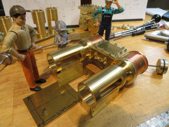

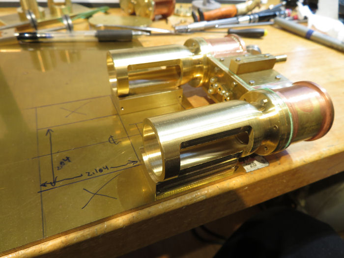

Here is the base plate set in place under the other engine parts:

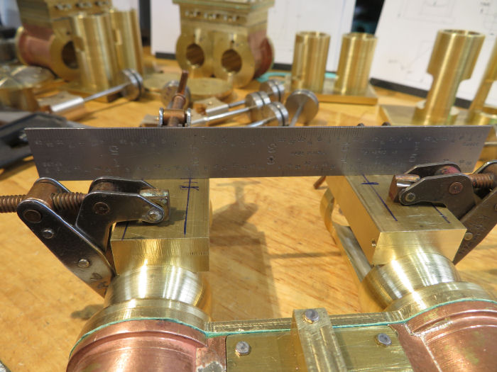

Then some planning time. You can see two vertical lines drawn on the crosshead guide support block at the lower center in the previous picture. Those lines represent the distance in from the sides that I can drill/tap for some screws to hold the block to the guide tube, while staying outside of the path of the crosshead itself. The tube is pretty thin, so drilling partway through and tapping the shallow holes would only give a thread or two at most, not enough since this joint will be supporting all the forces on the pistons/cylinders. So, moving them outboard of the crosshead will let me drill through from underneath, and tap the full thickness of the tube, and trim off the end of the screw inside the tube.

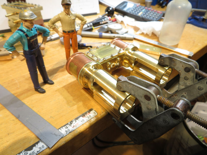

That brings up the next challenge - holding the blocks to the tubes, in proper alignment, to drill the screw holes. Went back and forth with the elves on that one, and settled on this approach. I clamped the blocks to the tubes from the outside with a large pair of welding clamps that have V grooves in the jaw faces to grip on the top of the tube. They were clamped with the base plate underneath to align the bottom faces of the blocks to each other, but the clamps were not on the base plate itself.

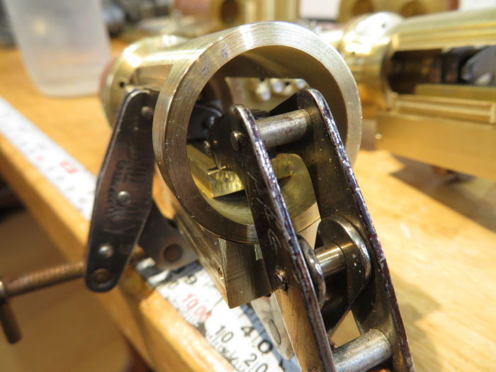

With the large clamps holding things, I then put on a pair of smaller clamps on each tube, with a brass flat bar inside the tube to prevent the clamps from marring the surface that the guide slides on. The larger clamps were removed.
A view showing the flat bar inside the tube:
And yet another check of the alignment of the blocks with a straightedge:
So, all ready to drill/tap for the screws. First, I put a drop of wicking grade locktite on the joints between the blocks and the tubes, just to ensure nothing moves from the pressure of the drilling. This is a key alignment to the engine, so better to take the extra time to 'glue' the parts together. I'll let that set up overnight before drilling.  After these parts are screwed together, I can clamp the whole assembly to the base plate and drill for screws to hold the blocks to the baseplate.

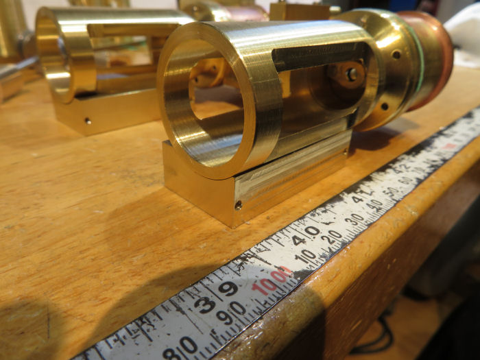

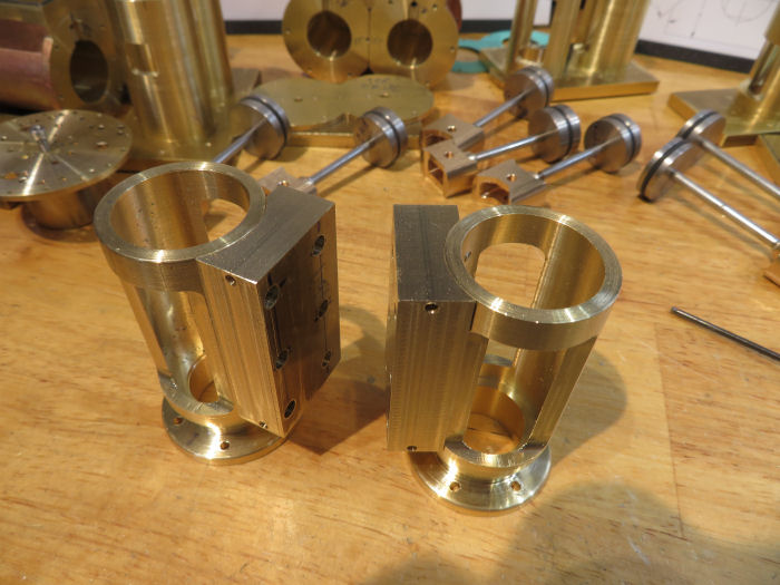

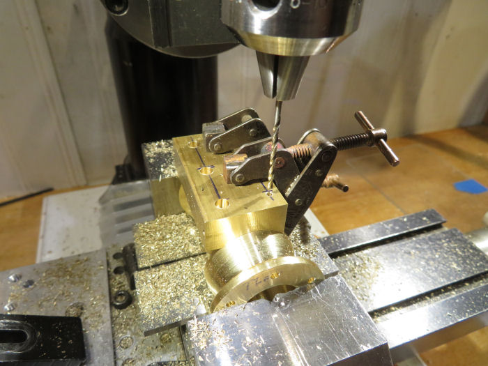

Got the holes drilled/counterbored/tapped in the crosshead guide base blocks:
Here they are ready to reassemble back on the cylinders so I can lay out the holes to hold the blocks to the base plate:
But first, I got the cylinder assembly sealed up with some jb weld on the center block edges and all bolted back together. I'll let that cure overnight before putting the guides back on. Close to the point where I can put in the pistons and seal up the cylinders for good!
