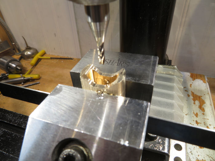

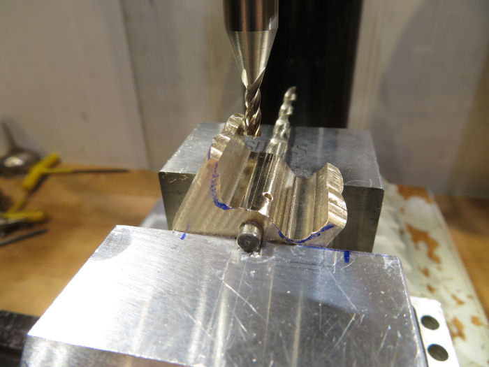

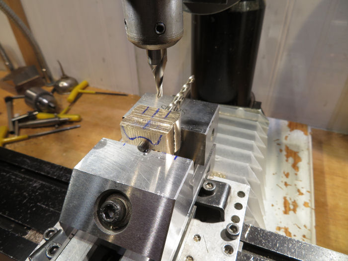

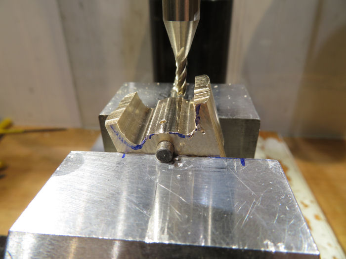

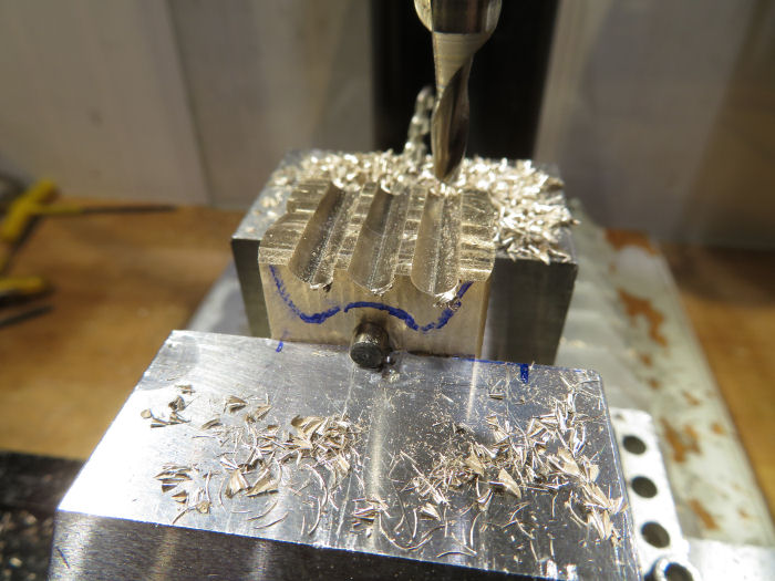

More work on the crossheads. I got the Marion, Erie, and Bucyrus parts profiled first, they were simple recesses. The Thew profile is more extreme, so will show more detail on them. The two parts were slipped onto a drill shank to align them, and a drop of Loctite Wicking Grade applied to keep them together and prevent them from rotating separately. With the pair in the mill vise,
used a ball end mill to start shaping down the end
The outer cuts went down to the deeper position, while the center stopped where the radius will be (the blue sketched on line was just a guide to help figure things out, it was not used to mill to!). Took a few extra cuts across the middle to make it easier for the next step...

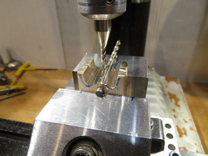

Switched to a square end mill, and set the depth to match the flat in the center, and smoothed that over since the ball mill left ridges

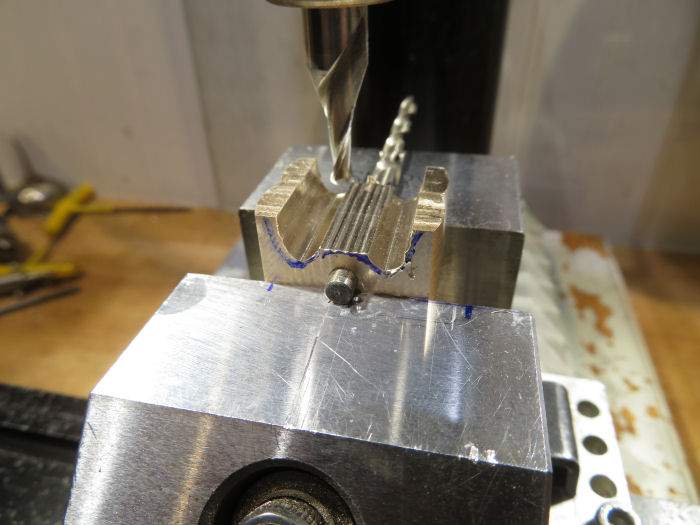

From there it was the same process I use for making the curve on top of bearing caps, use the drill rod as a pivot, and rock the part over a bit between each pass to make a series of small flats along the radius
farther each time...

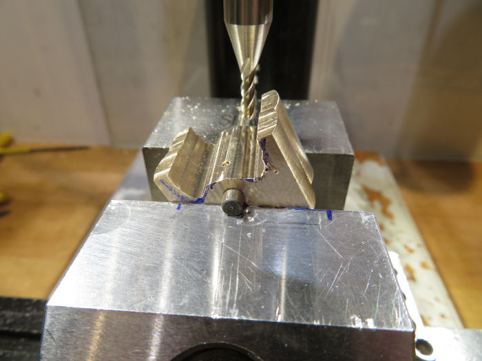

ensuring the rod is kept flat on the top of the vise, until the flats went tangent to the concave surface left by the ball mill at the side

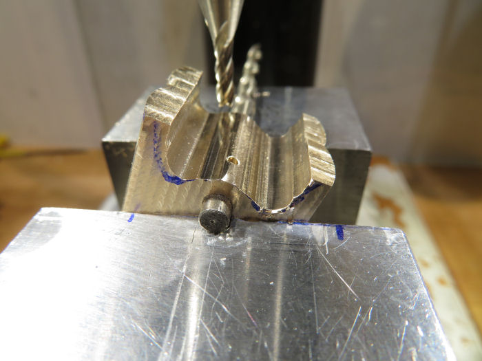

Then same steps on the other side...

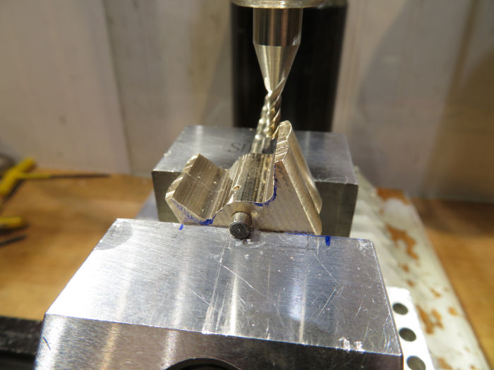

Then two more cuts, to flare out the outer edges to be tangent to the other side of the concave side trenches
same on the other side to complete the shaping

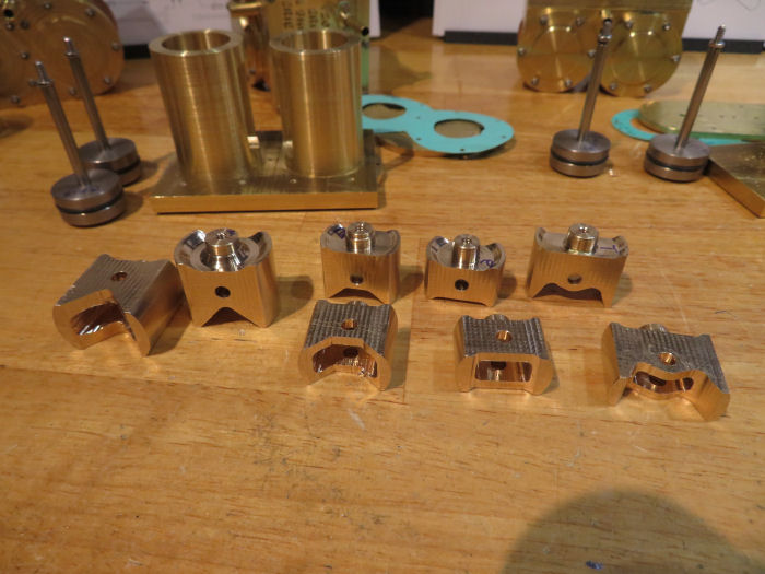

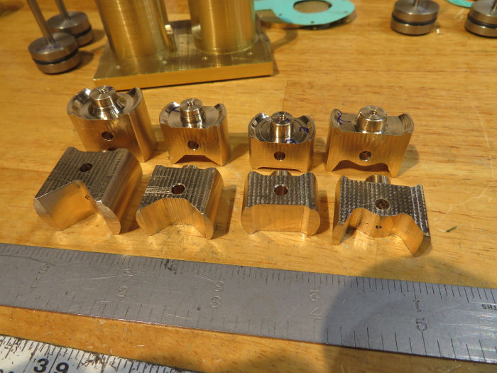

Then popped apart the two pieces and filed off the loctite residue. Here are all eight crossheads ready to mill in the openings in the ends. All different shapes and sizes, according to how the manufacturers made them - very different styles!

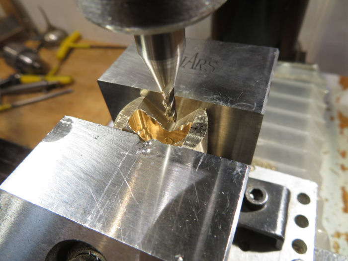

and have started milling in the openings in the ends for the con-rods. Each opening is centered on the end, long enough for the con rod to rock as the crank goes around, just over the width of the con-rods, and deep enough to let the end of the con-rods clear when the wrist pins are inserted. Started with the Marion,

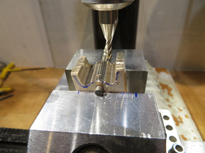

then the Bucyrus,
which leaves two more pairs to cut...  Its REALLY cold/windy out this weekend, so more time than usual in the shop where its warm!

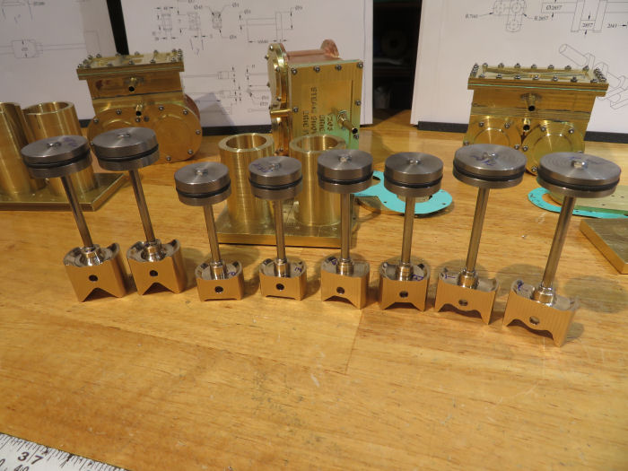

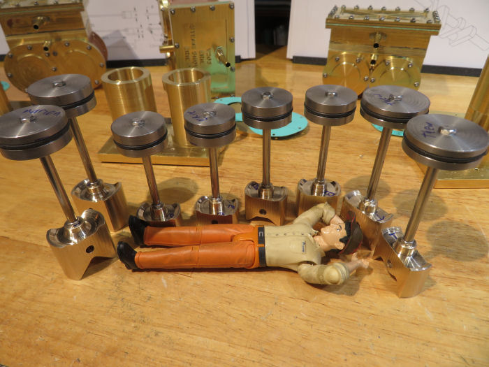

Since its so stinking cold, a good afternoon to stay next to a nice warm milling machine! Got the rest of the crossheads hollowed out:
and couldn't resist planting all the piston rods into them:
The shop elves have been demanding a vacation, so I did a little hypnosis on them and convinced them the piston assemblies were palm trees, and they were relaxing in sunny Palm Bench!   :lolb:
