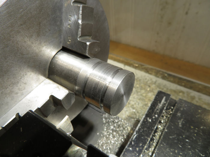

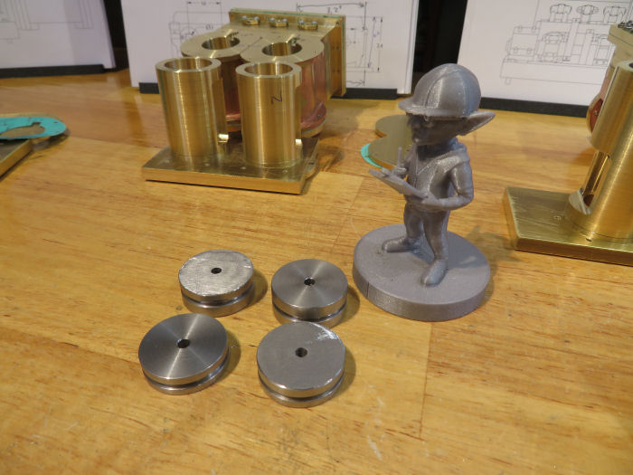

This morning started in on the pistons - at last some moving parts!  Two of the engines have 1" pistons, two have 0.9" pistons, so I'm making them up in pairs. That lets me sneak up on the depth/width of the grooves for the o-rings on one, then repeat the handwheel movements on the other three. My parting tool is slightly narrower than the Viton o rings I'm using, so it takes pairs of cuts to get the slot just wider than the ring, to give it room to squish a little. Here are the first to pistons with the slots cut...

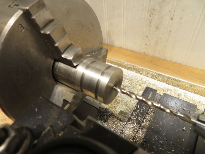

and drilled for the piston rod in the same chucking:

Chris what kind of tool do you use to make the ring slots, a parting tool?
  • Posts: 22717
« Reply #324 on: January 31, 2026, 01:30:43 AM »
Yes, one of the type that is about 1/16"  thick, 3/4" tall, and has a concave top all down the length, rather than being just ground on the end of a square bar. Not sure what this style is called, got it at Little Machine Shop I think, several years ago. Every couple uses I take it to a fine grit grinding wheel to freshen the end, and take off where wear makes the end narrower. Have a holder for the quick change toolpost that lets me set how much overhang it has. I like that style. For each marerial and diameter it takes a little experimenting to  find a good motor and feed speed, a bit slower on my Sherline than normal turning. It has to be set parallel to the  face of the chuck and have the tip ground dead square or it pulls to the side.

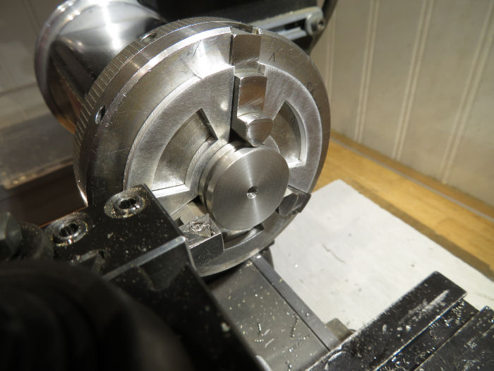

  • Posts: 22717
« Reply #325 on: January 31, 2026, 01:41:02 AM »
This picture from an older post shows the parting tool...

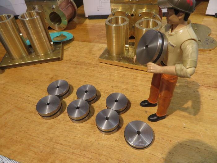

This morning I made up the other four pistons, and got all eight trimmed/trued on the sawn flat faces:
The shop elves keep trying to take them for their Elflympic Curling team...
