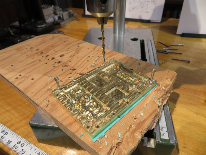

Started in on the gaskets, first the steam chest covers. Used the cover of each as a drill guide into the gasket material, over a piece of scrap plywood. Drilled the holes in opposite corvers first and pushed in screws to keep the gasket sheet aligned, then went around the rest of the holes:

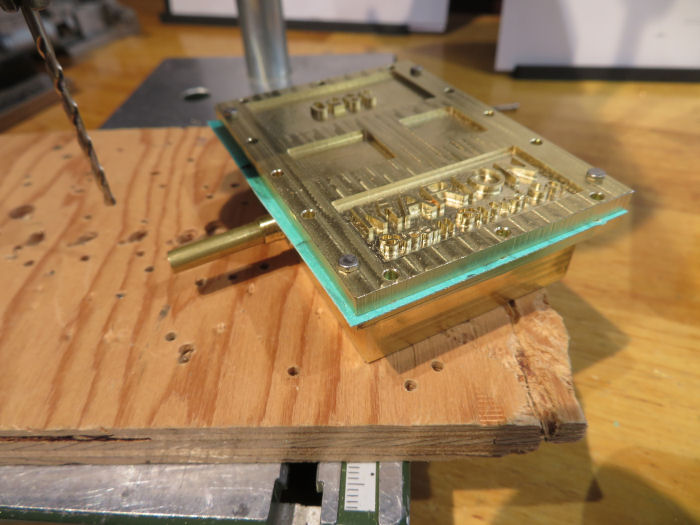

Quick and easy, no special punches or anything needed. Then assembled onto the steam chest and trimmed around the outside/inside edges:
leaving a finished gasket, and on to the next one...
Then started in on the cylinder caps using the same method. After those are done, will make them for the steam/exhaust glands...

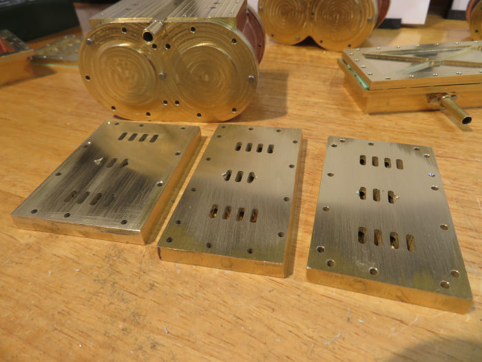

This morning I got the valve plates on all four engines lapped smooth using a diamond grit plate and then some finer grit paper stuck to a flat glass plate. Both use water as lubricant so not messy, and easy to clean out the openings.
After drying them with a hair dryer mixed up some JB Weld and applied a very thin layer around the ports on the undersides of the plates, and around the bottom of the steam chest sides. then bolted them down with long socket head screws down through the top flanges of the chests (where the covers will hide them). The screws were tightened enough to  seat the parts into the epoxy, there was just enough there to start to squeeze out around the edges. A few of the passage holes down to the cylinder plates got some squeeze out, but after it has cured I can run a small drill down through the ports and from the cylinder ends to clear them out easily.
The squeeze out around the perimeter of the plates can also be cleaned up after it has set up, probably can scrape it off with a x-acto knife.

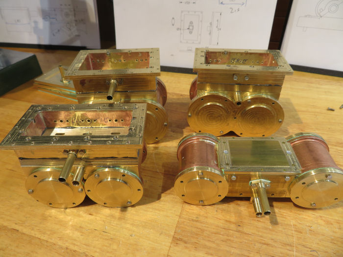

So, getting close to done with the cylinder blocks! All that is left is to make a pile of 2-56 studs for all the covers. I have some lengths of 2-56 threaded rod and a bin full of small pattern nuts, will cut the rod into the short lengths, debur the cuts on the belt sander, and loctite on the nuts. That way they can be installed just like a normal hex head screw, but will have the appearance of separate studs and nuts.
