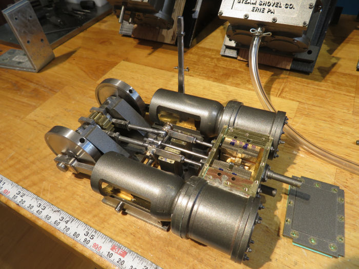

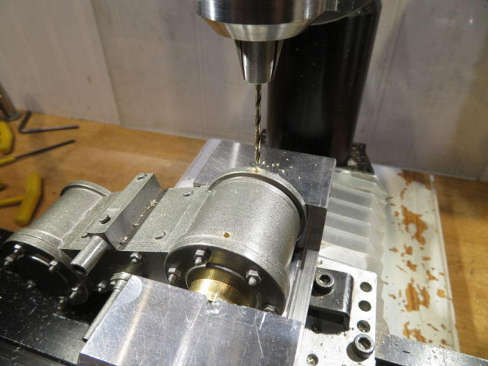

This morning I got the cylinders removed from the Thew engine, and drilled/tapped for the cylinder drains.
Wish I had done these when making the parts in the first place, getting all the screws holding the cylinder out/back in was a pain on this engine since they had to be done mostly with a 1/8" open end wrench - very slow. All back together now though! I did make a new gasket for the steam chest cover too. When I made it originally, I trimmed it a bit too close to the holes, and it tore during handling a while back. Very quick to make a new one, drilled through the gasket sheet using the cover as a drill guide then trimmed around the outside with scissors. This time I left the center solid rather than cutting out the center - will be much sturdier this way.

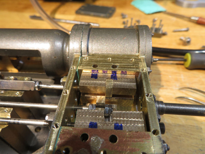

Here is a picture of the inside of the steam chest to show the orientation of the ports for the cylinders. Unlike the other three engines, the valve ports are vertical on the sides of the cylinders, while the throttle valve is horizontal between them. Will all work the same, just a little tighter quarters for getting at things.
I have the eccentric arms disconnected from the valve rods, and the rods pulled back to allow inserting the valves. So far I have the blanks for the valves milled to overall dimensions, ready to cut the slots for the valve rod/nut, and then the ports. Since the valve rod is fairly close to the valve face, there is less room to drill the connecting passages in the valve. I'm thinking I'll make the adjusting nut stop short of one side, to leave room for the passages. Will start on the shaping of the valves this afternoon or tomorrow morning. :cheers:

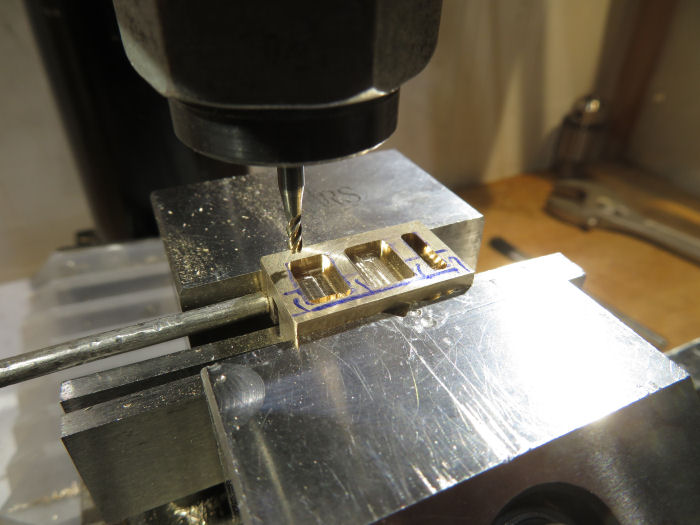

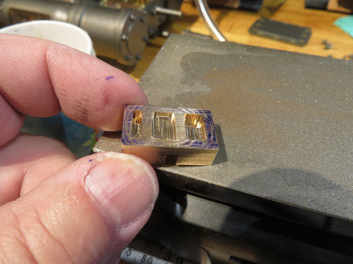

This morning I got the valves for the Thew engine finished up. Drilled the passage hole to connect the end chambers, then milled the chambers themselves:

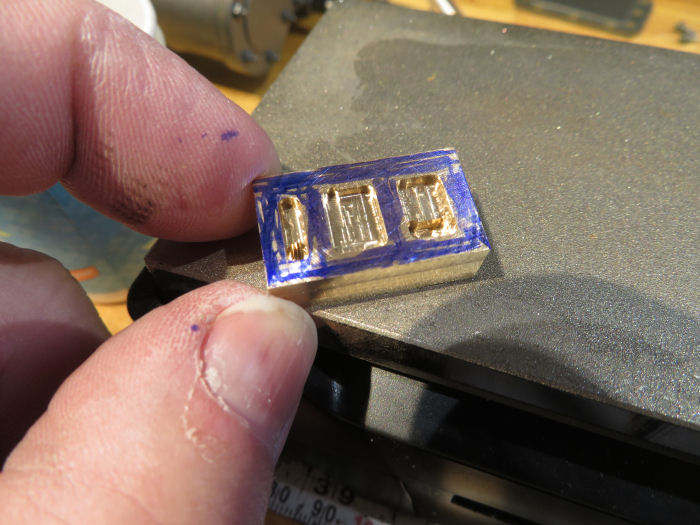

Then lapped the bottom faces of the valves. Before lapping, I took a picture of the bottom face after marking it blue to show the difference that lapping can make on a valve face that was just milled flat:
Then after the first couple swipes on a diamond sharpening/lapping plate:
You can see how the tool marks from the end mill are still there and some areas have been taken down by the plate more than others. All those blue stripes would be places where air/steam could blow past the valve and into the exhaust and both ends of the cylinder. I then kept wiping it on the plate (the one I am using is designed for use with water, others use oil or some solvent - after use I flush the surface with clean water to clean away any fine bronze particles). Then switched to a finer grit plate to finish it off to a nice smooth surface.

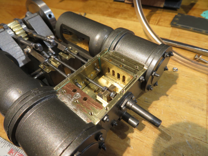

The sides of the valves were marked to show where the walls between the chambers are, and also drew blocks to show where the ports are on the valve face. I used those marks to do the initial centering of the valve travel:
Here is the engine ready to close up and start the eccentric timing. Will do that after lunch, might have it running this afternoon. Or not - never know how long that process might take. For now I have left the caps off the guide posts for the valve rods, where the square section of the rods are. I'll do the initial test to see if the centering is good, with the drain plugs still out, then put the caps on when happy with the centering. With the caps off, the rods have just enough flex so I can rotate the rods to adjust the center position. The rest of the timing will be done after that by adjusting the eccentrics on the crankshaft.
