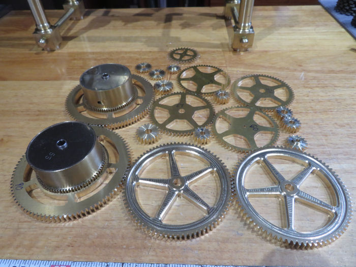

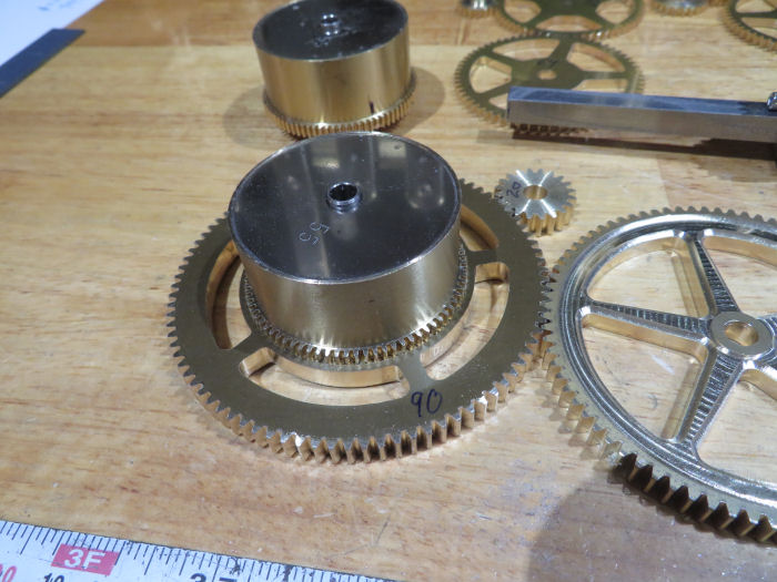

Got first one of the spring drum gears cut - these are the largest at 90 teeth.
and this morning cut the second one. Here is the growing herd of gears so far:
Two more to cut - the 72 tooth gears that go on the taller holder up to the escape wheel. I skipped over to the largest ones since the 72 tooth gears need a different arbor, with a smaller center screw.

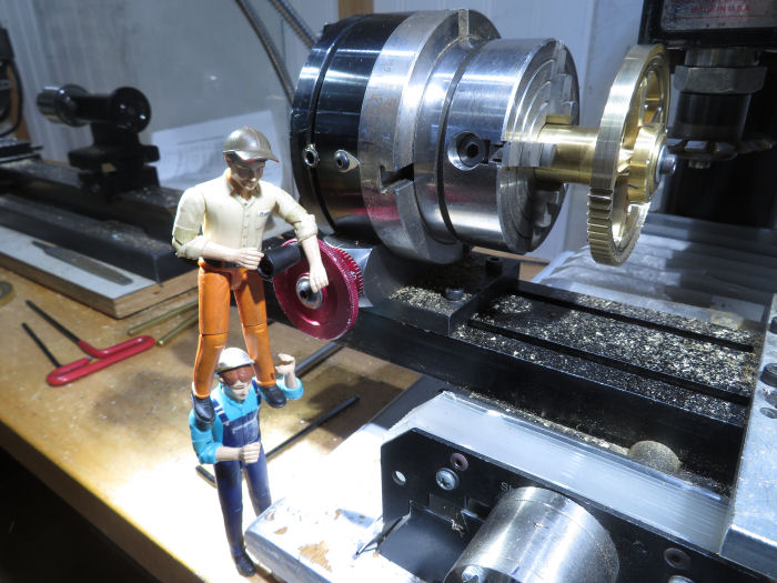

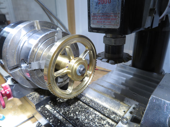

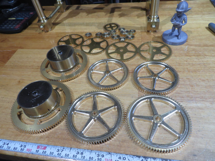

Down to the final two gears!  (well, so I thought, read on)  The 72 tooth ones are the easiest of the set to do, since at 5 degrees per tooth the rotary table advance was just one full turn, 0 to 0, for each tooth. No tracking the sequence, checking off each cut as I went.
Even the shop elves got in for a 'turn' at the handwheel...
Here is the full set of gears:
WEEEELLLLL, not quite.  There is a whoops in the spreadsheet! There is one more 15 tooth gear needed, for the shaft with the escape wheel.   :facepalm:   Found that out when I laid out the gears in order, on the shaft locations they go on. And it didn't add up! Went back and looked at the CAD model, and counted up the pinion gears, and realized that there are FIVE 15 tooth gears, not four.  Apparently the shop gnomes are getting REALLY good at stealing small shiny parts - they got this one on the computer before I even made it!   :Lol:   Easy fix since the setup was still in place on the mill - just had to swap back in the arbor and make a new small blank, swap back to the #2 cutter, and make the passes for the 15 tooth pinion.
So, next steps? I need to broach some 1/16" keyways in the gears that go on the 1/4" shafts, they will be under the most pressure so keys are a good safeguard over solder or loctite. Then I can start making all the pivot shafts. Some of them get other fittings, like the spring drum ratchet, and the minute shaft slip spring pieces to allow setting the time. It may look like the clock is almost done, but there are a LOT more parts to make - lots more fun in the shop!
