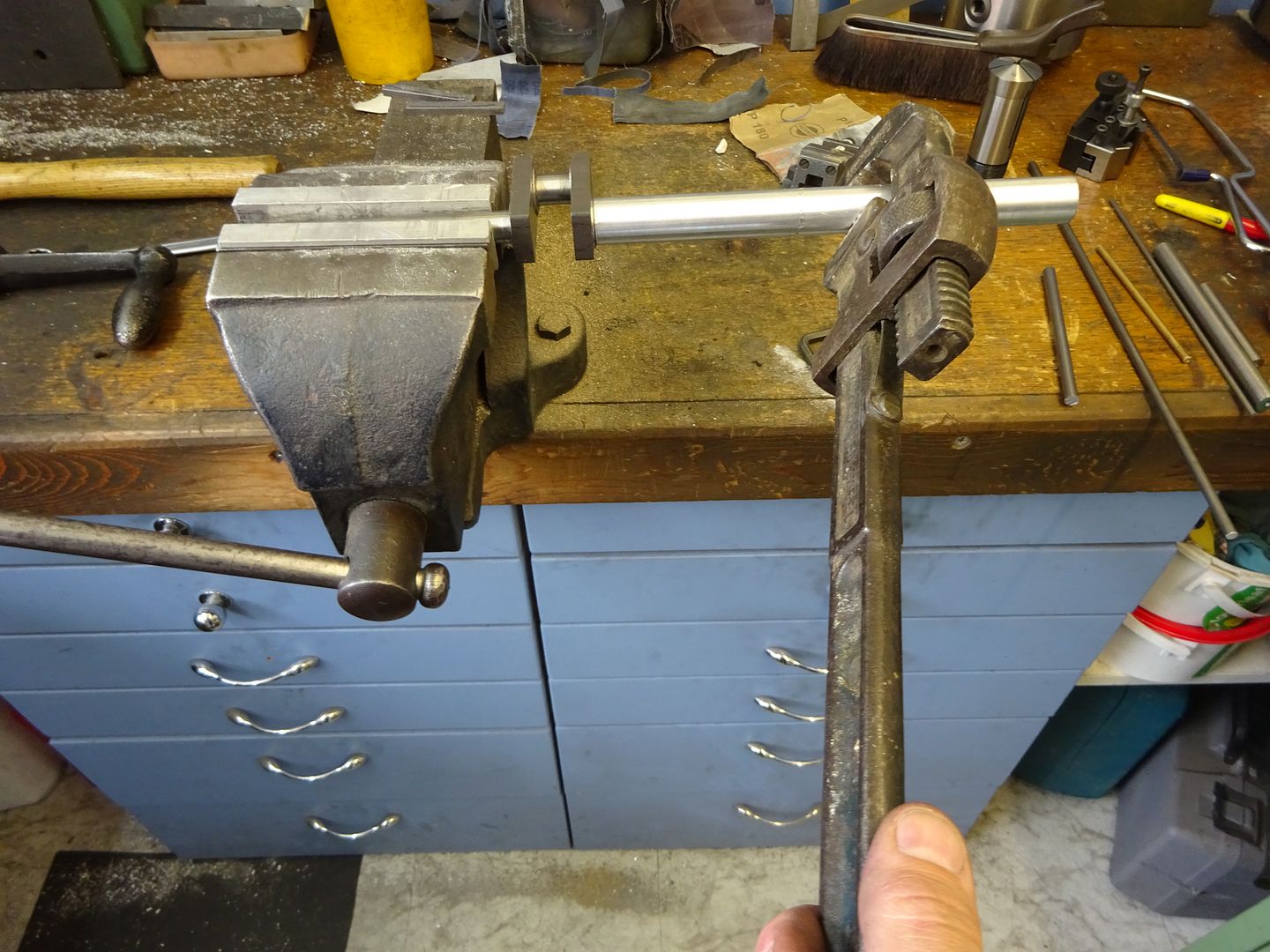

I tend to use precision ground mild steel if it is a built up crankshaft though you may not get it small enough for your engines so silver steel will be on size and a better fit in reamed holes. If cutting from solid then either Black EN3 flat bar or black EN1A round bar does for me on most engines, certainly steam and hot air. Sometimes go upto EN8 on IC engines
Like Chris if I'm not scaling then I go by what looks right, bigger flywheel or distance between bearings and I'll up the diameter. But for your size engines 3 to 4mm is about right
I once took on the completion of two hit and miss engines, the original builder made a big point of the crankshafts being cut from solid EN24. Worst cranks I had ever seen, bent and a terible finish and he was a well respected model and full size engineer.

Thanks for this. I've used silver steel for all but one of the engines I've built this year in 3-6mm diameters with reamed holes. Sometimes there's a tiny bit of play between shaft and hole which I find annoying! The silver steel always seems to measure a fraction under the stated size but maybe that's just my vernier. I'm not sure I could get such a good finish by turning down mild steel but it would probably be good enough. Anyway, I'll look into the other steel materials as I know nothing about them atm.
That's a dinky little bent crankshaft in your photo  :Lol:
