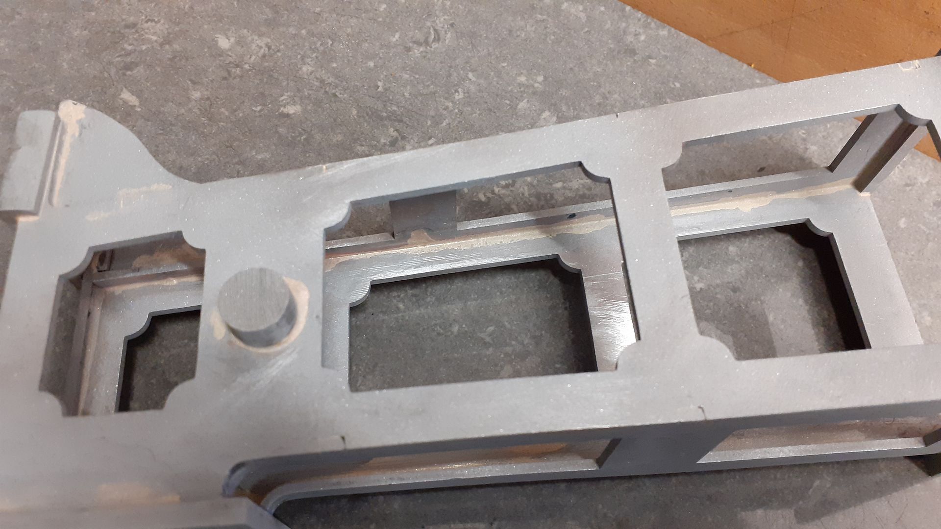

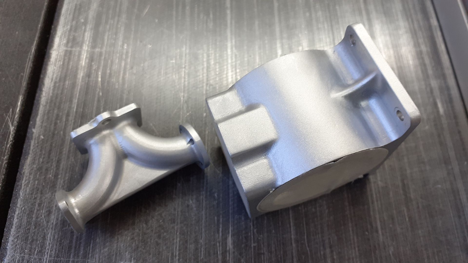

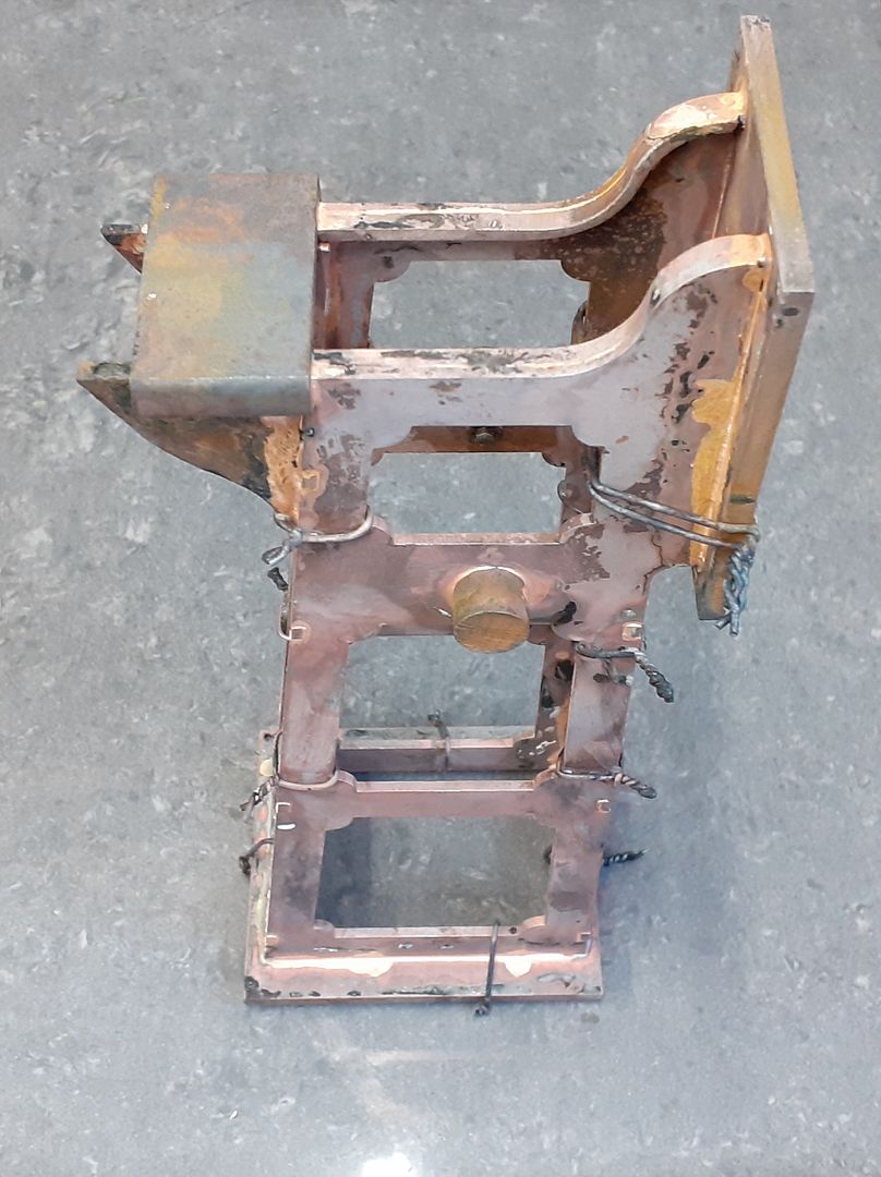

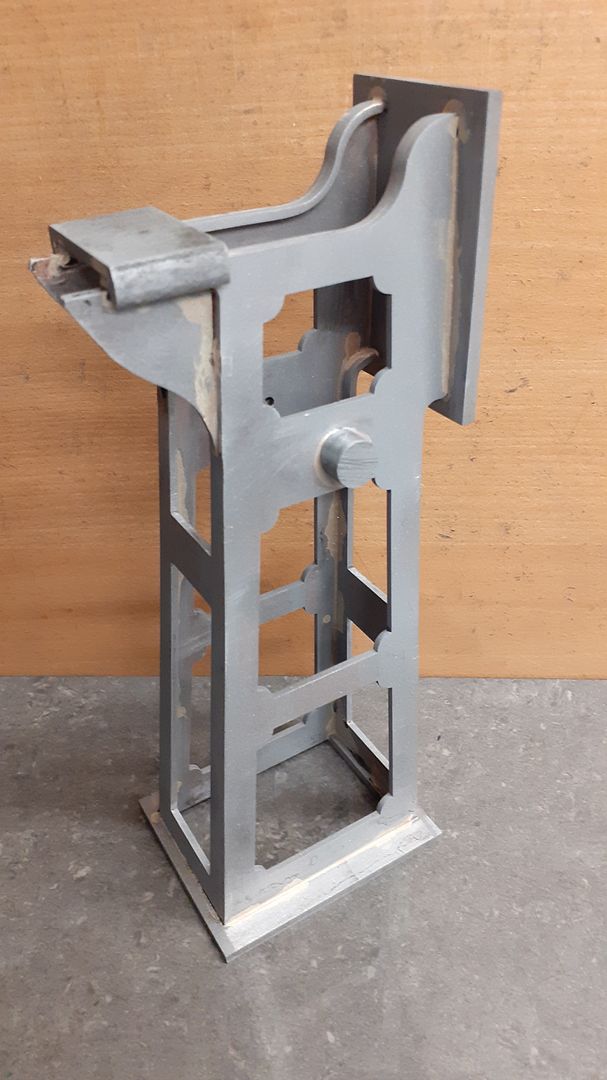

I've only got a 2HP compressor and use it with a cheap Lidl spot blaster and it does model parts OK.
This was after pickle, part is about 200mm long
And after
This is larger than one of your cylinder jugs will be.
Those were with grit but with glass beads it leave sa nice finish on non ferrous to remove machining and abrasive marks.
