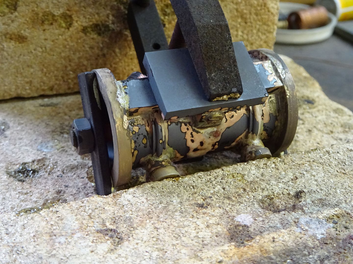

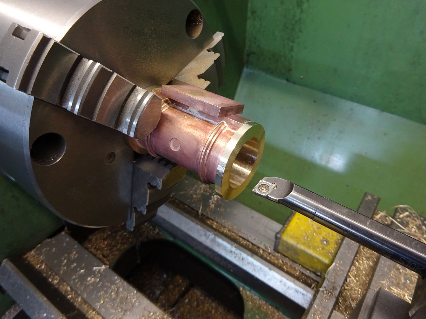

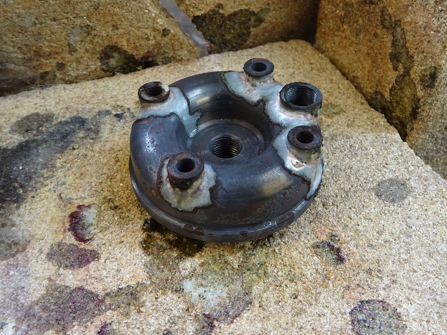

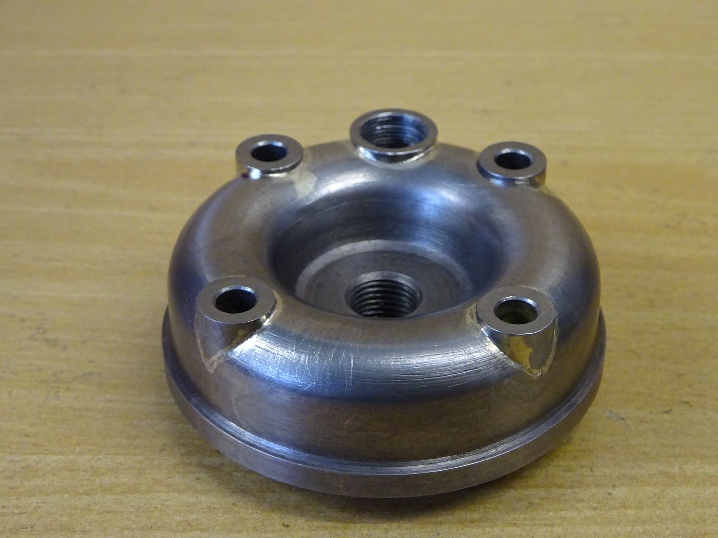

I use a stronger acid that not only removes any flux but also any black scale that may form on steel parts. Sold here as brick cleaner it is a dilute hydrochloric acid. Use outside and rinse well.
Couple of before and after shots. Any slight pink/copper colour is due to the acid getting a bit old but that does come of easily. All where HT flux and dipped for about 30mins
Brass & bronze
Steel
For things like fabricated castings then a sandblast after the acid also works well but keep it off any shafts or finished holes.

Thanks for comments. I did hear that elevating the temp of citric acid solution helps. My little dunk batch was already quite warm because it got some prior dips from the freshly soldered part so I think I simulated that. But it was not an extended soak time, I was after the so called shock effect. I do recall leaving a brazed steel piece in overnight by accident & it was rouge/rusty looking next morning, although that did come off easier than the black. I was sure I had done this before but remembered those parts were 303 stainless.
Jason, I'd be thrilled if my parts came out like that. One of my many teenager summer jobs was setting ceramic tile. We used a diluted hydrochloric acid solution to clean tiles & particularly stubborn grout stains, both new & old. I will look for an off the shelf HCA product & give that a try. Just to confirm - are all your pics without sand/bead blasting?

Those were all just the acid no sand blasting
