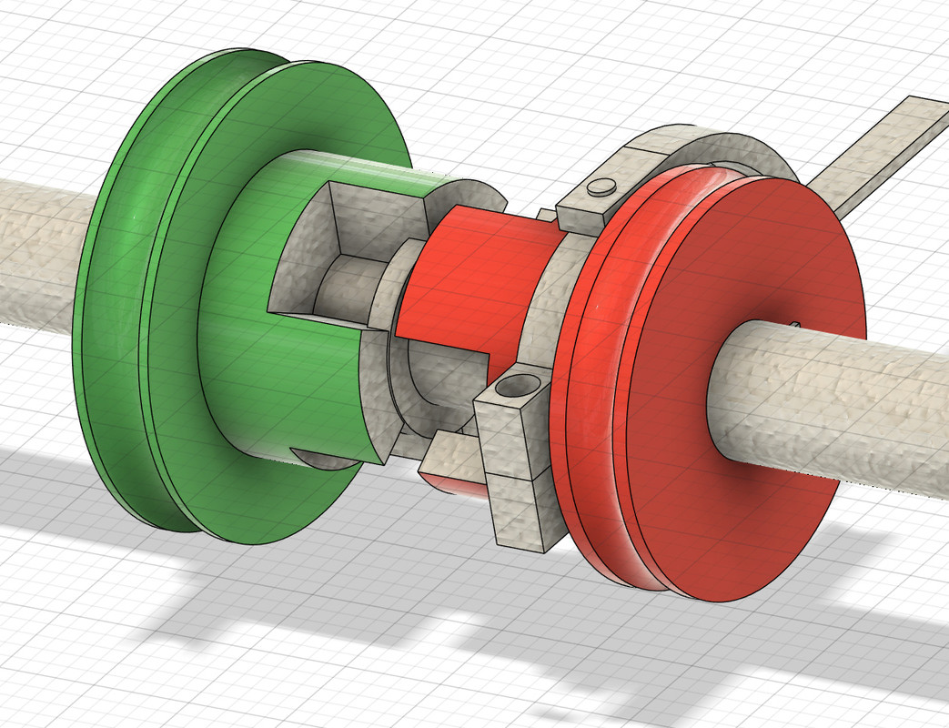

crueby:
A dog clutch is a simple way to go - one half is attached to the driven shaft, other half free wheels with another pulley on it. When moved into engagement, the freewheeling half and its pulley get turned. In this picture, the green pulley and clutch half are fixed to the shaft. The red ones ferewheel on the shaft until pushed sideways into the other clutches teeth. The clutches can be made with two, three, four teeth, whatever is easiest, and the lever to move the free one back and forth could be a simple fork.
