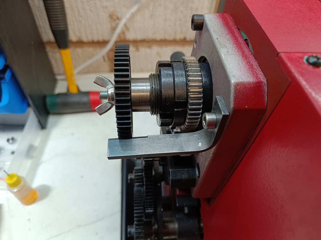

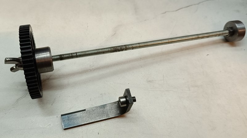

I've ordered the Seig one from Arc. Looking at the gear at the end of the leadscrew I noticed it has a hex socket, so I shortened a spare allen key and made a little handle - no greasy fingers and a bit further from any moving parts.
While I was at it I decided to make a simple detent/dividing attachment using a 60 tooth wheel for 3/4/6 divisions. Made a short slug to go in the chuck end (should ideally be tapered but parallel will do) and a tight fitting boss for the wheel. Just need to make a slightly tapered 'stopper' to go behind the wheel and a bracket which can be fixed using that convenient M5 hole  :) I plan on drilling small holes on the side of the gear 10, 15 and 20 teeth apart and filling them with dots of different coloured paint.
  • Posts: 1400
Re: Small Vertical Slide
« Reply #13 on: September 20, 2025, 03:51:58 pm »
I've wandered miles off the original post but here's the almost finished super simple detent.
Made the tapered stopper and put a slight bevel on the chuck ends so as not to scratch inside the spindle. Made a bracket from annealed 1/2"x1/8" steel and filed part of one side to fit within the teeth. JUst need to make the marks on the wheel and it's done. I suppose it would be more accurate to leave the bracket in place between each point and have a separate sliding part on top of it to engage in the gear but I doubt it'll make more than a tiny fraction of difference doing it this way. Just need to put the dots on the wheel and it's done.
Assembled:
Parts:
