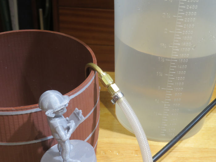

Then switched over to pumping a full barrel (1.5 liters) into a graduated pitcher and timed it to see what kind of flow rate its producing. It took just 30 seconds to empty the barrel!

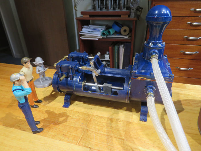

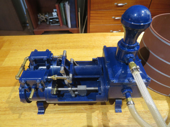

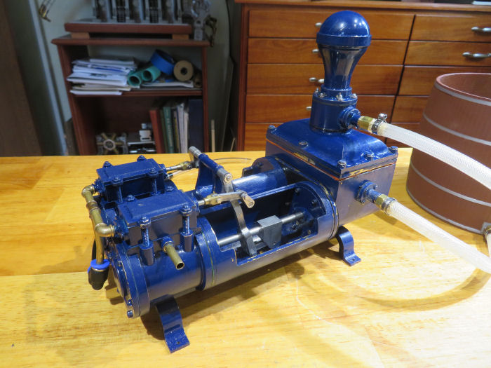

Needless to say, QUITE pleased with how it has come out. Right now, going to get some lunch, then do a little touch up painting on some of the corners where paint got scraped off during all the disassembly/re-assembly sessions the last couple days while working on the seals. In the meantime, a couple pictures as is:

I must have miscalculated when I estimated a pint a minute early on, its more like .8 of a gallon.  The plungers in the pump section are 3/4" diameter, so a lot!

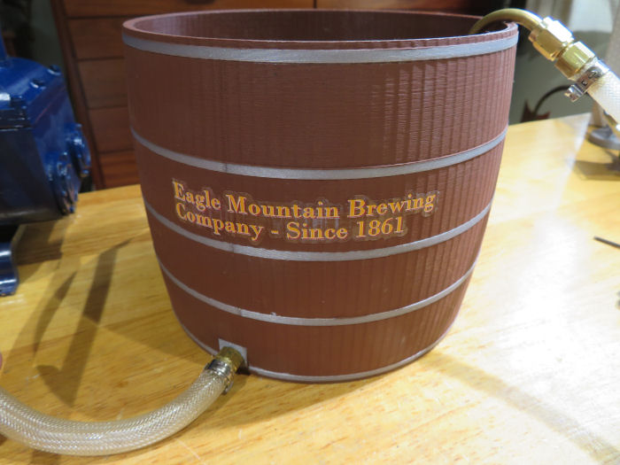

I realized that I forgot to get the brewery name on the side of the mash tun!   :wallbang:
I had a number of these made up back when I made the Mann Steam Wagon, vinyl letters with a self adhesive backing on them.
And got the paint touched up...
