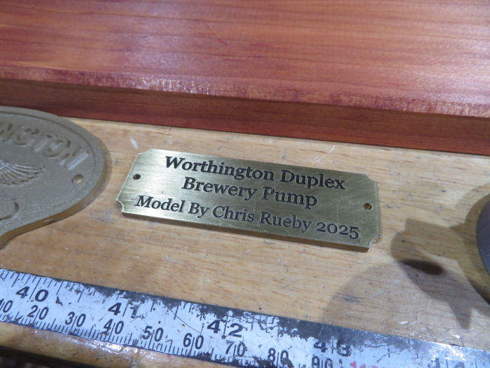

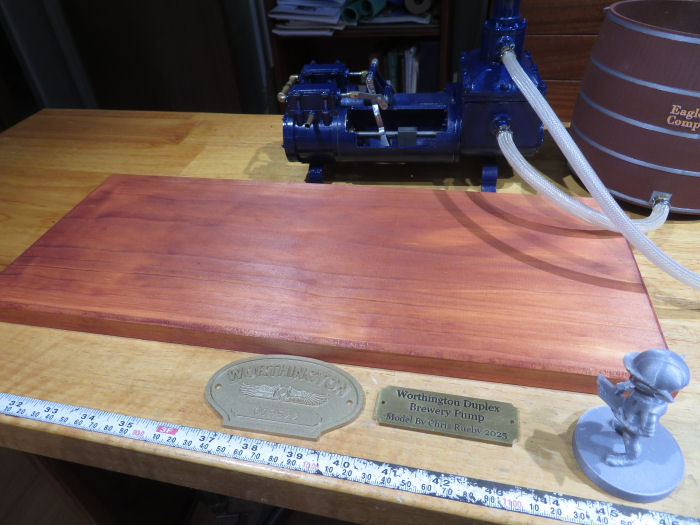

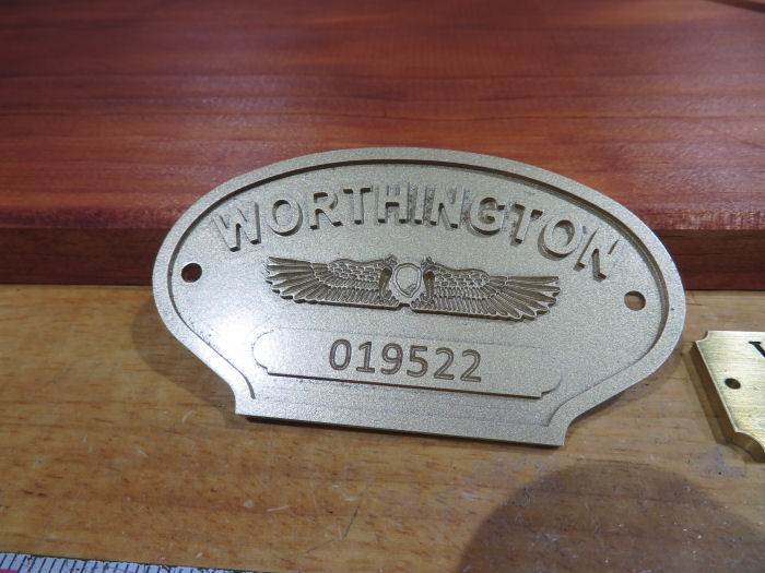

Todays shop playtime was dedicated to getting the display base and nameplates made:
Milled up the nameplate on the CNC machine, outlined ends and V-groove engraved letters on a length of brass bar stock, then used brass-black to darken the letters, and polished off the top with a scotch-brite pad, then sprayed it clear.
Also was a good opportunity to learn more of the tools for the CNC, designed up a copy of one of the Worthington serial number plates. This one was milled into a piece of plexiglass then sprayed gold colored. I used one of their original logos to get the outlines for the winged emblem. They would have had one of these on each pump. Could have 3D printed one, but with a filament printer the details of the logo would not have come out well at all.
I was able to find a real antique bronze plate, similar style, from a seller in Australia/ebay. Its on its way, waiting for the flight from Melbourne. Should make a nice companion piece to the model.
So, just about done, will be getting the base all together and take some more pictures, then will post a 'done' thread over in the showcase. This winter I need to write this one up for the magazine, the editor has already asked for a build article with all the plans. He has built some beautiful Westinghouse style single cylinder pumps himself.
