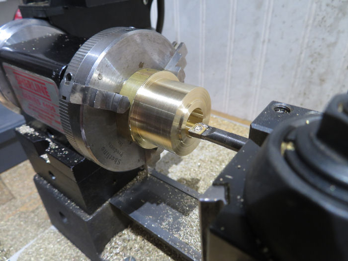

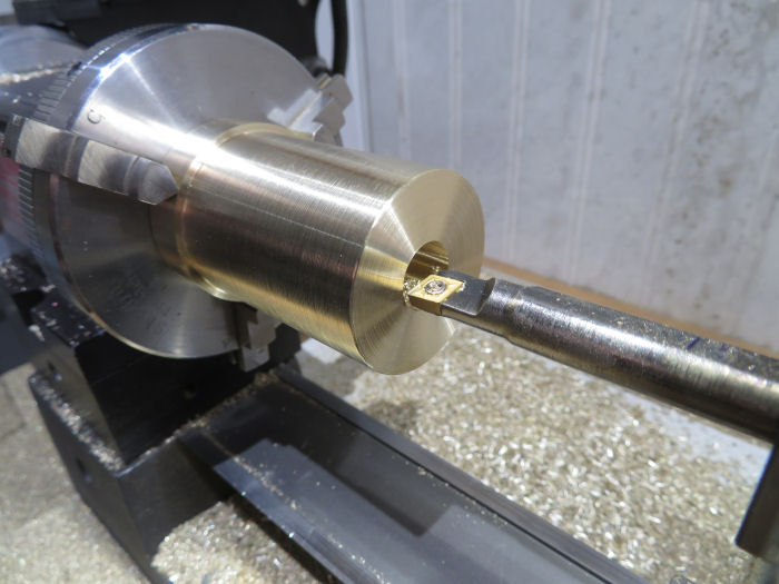

After lunch got the blanks for the next parts cut on the bandsaw, and started turning on the lathe. Ahhhh... Nice to be back turning the cranks myself!   :)

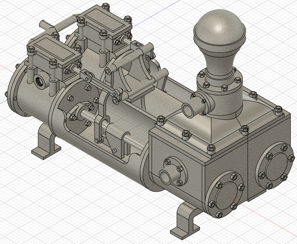

Started with the pipe flange/spacer that goes between the top cover and the force chamber - as shown in this drawing, on the right hand end with the pipe sticking out to the left:
Got the shell turned to size and bored out, it still needs to have the hole for the pipe drilled in the side and the bolt holes drilled. Going to wait on the bolt holes till the lower end of the force chamber is done so I can drill all three parts together in one setup.
So, on to the force chamber!
Going to make it in two parts, the lower 3/4's of it, and the top hemisphere. I want to hollow it out like the original is, so I'll bore from the upper end down through the part. I've got the blank trued up on the ends, left long enough to grip in the chuck now and part off later. I've turned the outside down to the diameter at the top end, and bored the center out to the diameter at the lower/narrow end.
Next will be to bore out the inside to the curved shape to follow what the outside will be. Before starting that I need to spend a little time in Fusion to generate a stepover chart of handwheel moves to bore the shape inside and out - don't want to freehand wing it and wind up breaking through the shell when turning the inside.

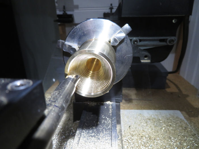

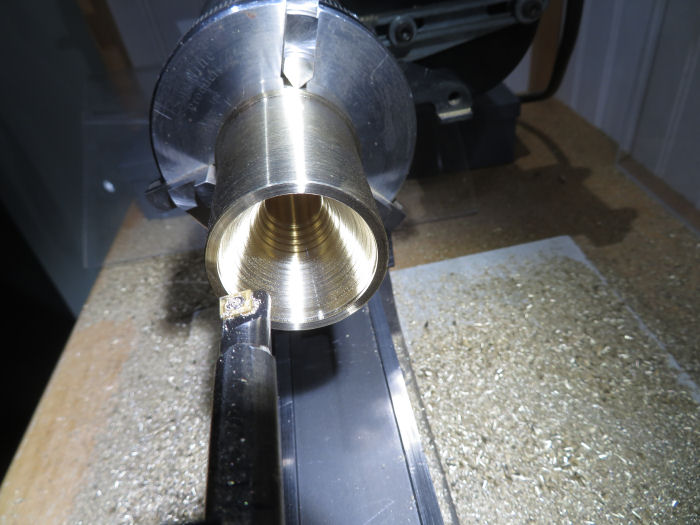

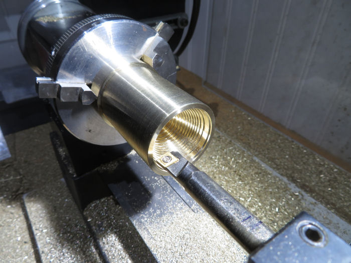

Got the step chart made up, and it was too cold and rainy out to do anything outside so more playtime in the shop. Got the inside cut on the lower force chamber. Started with the initial bore through the part, and did one set of cuts to each length on the chart for each 0.025" increase in diameter. That gave me this bell mouthed but slightly stepped shape:
Another view to show the steps better
Then did one pass from the outside in to trim off the worst of the steps, moving very slow. The .025 steps made it easy, 1/2 turn per step, and I watched carefully as I advnaced the cutter to ensure I was getting to the half turn before the next step started. Since this is on the inside and will never be seen after assembly, the finish is good enough. On the outside, I'll finish off with files.
Next time I'll do similar passes on the outside. For that I'll cut in the other end, and use a right hand tool moving from the chuck end to the outer end to make the steps. I'll put a disc on the end of the live center to support the outer end and keep it from wobbling, since the cut will be pulling away from the chuck. Thats a good place to break for the day though!

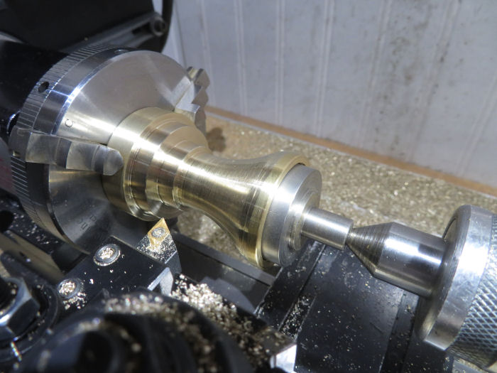

This morning I got the outside of the lower force chamber turned, again using a step chart generated from the CAD model to rough it in, then files and sandpaper to finish off the curve. An old arbor piece was used to let the live center support the outer end:

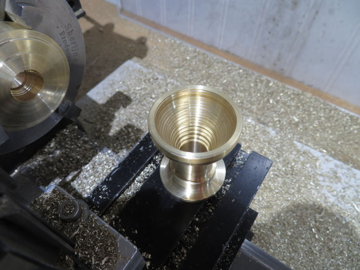

It was then parted off to length, forming a nice goblet for the shop elves. Don't tell them about the hole through the bottom...  :Jester:
A view from higher up, showing the inside profile better:
So, now I can go to the rotary table on the mill and drill the mounting holes in the chamber, pipe flange, and the center of the cover plate. After that can get started on the top dome for the force chamber, which will get pinned and loctited in place.
