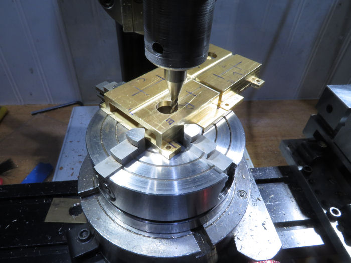

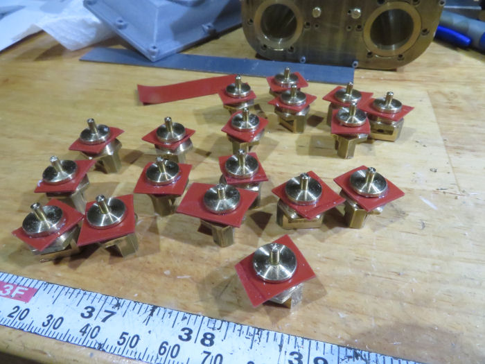

Got started on the check valve seals. Drilled holes in a strip of 1/16" silicon rubber sheet stock, held between two strips of wood to hold it steady. Cut them into squares, and glued each to one end of a valve with some E6000. In this picture they are set on the outside of a check valve just to keep the rubber pads flat, but they are only glued to the valve stem.
After the glue sets up I'll go back with scissors and trim around the disc.

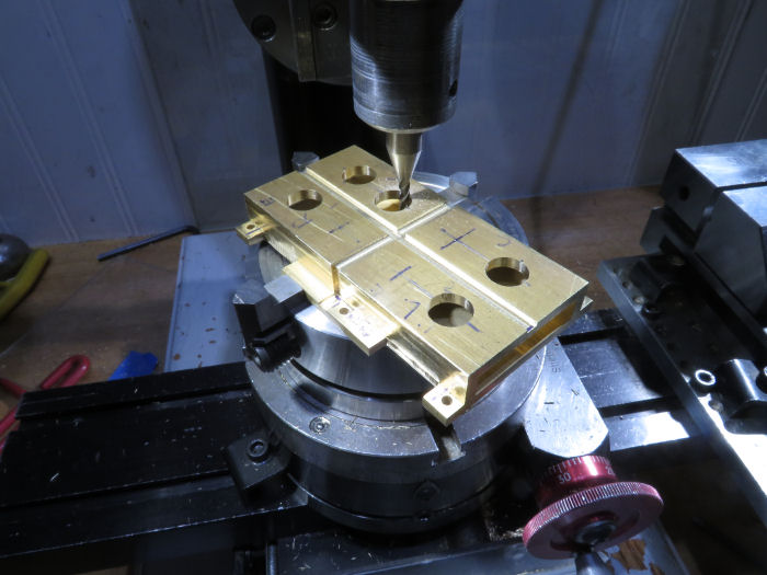

Then got started on all the holes for the valve bodies to screw into. They all are a M11x0.75 thread, which I don't have a proper drill size for, so I am using the rotary table to mill the openings. I could use the lathe and drill/bore, but the upper plate would hang out too far to do the holes in the corners. I'm using a four-jaw chuck to position them quickly, really only clamping with two jaws, third is to position it and fourth removed since it won't reach the end of the plate. I got the table position set by testing with a scrap piece, then did the real holes with a plunge cut and rotating the table around. Once it was positioned for one corner, the opposite corner was the same position, just spun the plate around 180 in the chuck.
I did goof the layout on the first of the inner set, a little too close to the center divider but it will still fit so I don't need to remake it.

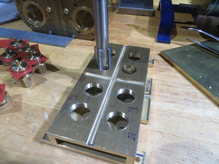

After all drilled did the tapping of the holes...

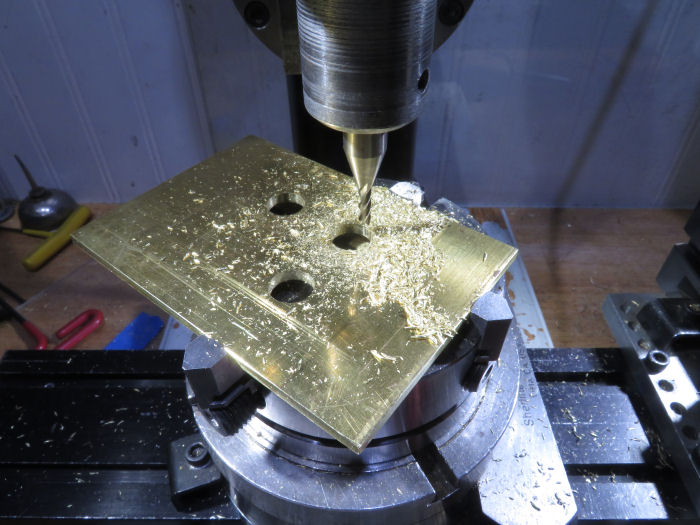

and have started doing a similar pattern in the upper plate. The first one is the intake set, with the water chamber through the middle, the upper plate bolts on top of the pump housing and sends water to the outlet pipe and the force chamber.
You can probably tell this upper plate is a different color - all I had in 1/8" plate was some 206 brass - not my favorite but it works fine for this. The only other 1/8" plate I have on hand is some C353 engravers brass, which I am saving for what may be the next project, a scaled down tower clock I adapted from a book a number of years ago but never got around to. Kim's clock has inspired me to dig out the CAD drawings for it and finish them up... It will likely be one of the next projects, never know till chips fly on it!

Love the herd of valves with their diapers glued on!  Interesting way to cut the valve holes too.   :ThumbsUp: :popcorn:

We have a set of gasket punches and leather punches for making holes in seal rubber...but drill and scissors work well too.  Fingernail scissors for that size might work well?

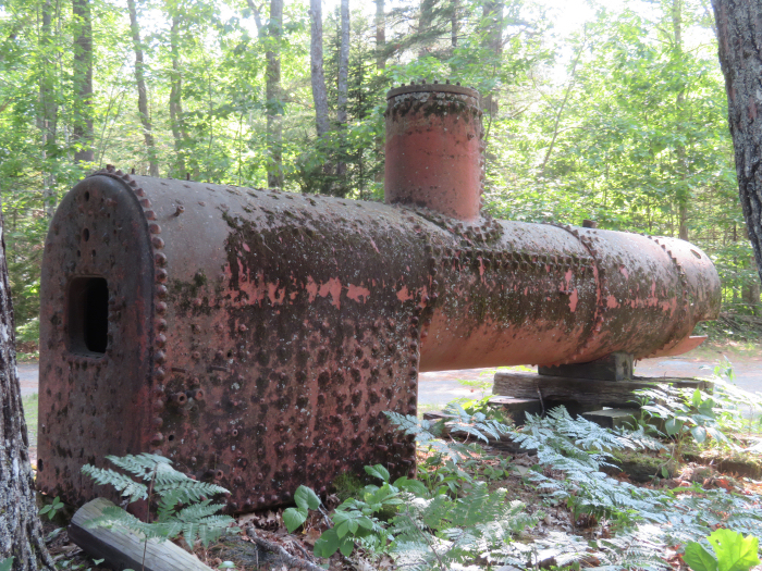

Hi "C"  I noticed that the rivets on the Lombards boiler backplate were quite pointed  rather than semicircular ?? is this common practice in the US ??   looking Good on your build.. :ThumbsUp: :ThumbsUp:

I think it varied with the boiler maker, I've seen both styles. On this particular boiler, those rivets are actually dummies! When they restored the Lombard to working order, the Maine state regulations forbid using the original boiler since it was a lapped seam boiler. Later Lombards used a butt-seam boiler with a doubler plate on the seam, which IS still okay in Maine. So, the museum had a new boiler made with all welded seams, and the company added the dummy rivets to make it look like the original. The original boiler is on display outside the Machinery Hall building, great since it shows all the firetubes/etc. I had to scale down the picture for this post, but in the high res version the points are visible on the rivets.
The second steam Lombard at the museum, on loan from the Crooker family, is a later one that has the butt seam boiler. It is complete, but has not had a formal annual inspection in a number of years. The steam dome in the picture shows how tall it is - so it extends above the top of the saddle tank, and also raises it so water will not get into the pipe on hills.

Hi Chris , thanks for the reply and the pic of the original boiler,   here in the UK the rivets are left one and a half times the diameter proud of the boiler shell and the riveting gun has a semi circular snap and this is pushed in a circular motion to close them up
cheers , willy
