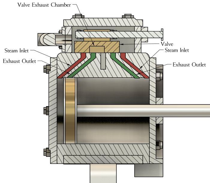

So, the next build will be a Worthington Brewery Pump, which I drew from some of their old catalogs and patents. It is a duplex double-acting pump that was designed for use in breweries, pumping beer in its different stages between tanks. It is very like a boiler feedwater pump that you have seen, just a different ratio of steam piston diameter to pump piston diameter, and the check valves are arranged a little differently.
Here is an animation that I did from the CAD drawing:
<a href="https://www.youtube.com/watch?v=_hctDgcSxO8" target="_blank">http://www.youtube.com/watch?v=_hctDgcSxO8</a>
I really like the actions on this type of pump. As each one nears the end of the stroke, the lever moved by links off the piston rod move the slide valve for the other cylinder and start it moving the other way. I drew up the pump at full scale, then scaled down a copy at 1:12.5 for the model, size mainly picked to match the bar stock and lathe capacity I have. One neat thing about these pumps is the way they did the valves, the slide valve is extra long and there are two sets of ports at each end rather than one port, so the exhaust gets cut off by the piston as it nears the end so that the remaining steam (or air) gets trapped and cushions the piston travel to a soft stop. Here is a cross section showing the valve and passages:
In this picture the piston has neared the left end, covering the green exhaust outlet, and the extra length of the slide valve has covered the upper end of the steam inlet, so the remaining steam is trapped and brings the piston to a soft stop. When the other piston nears the end of its travel, it will move this piston's slide valve to the right, letting steam into the left steam inlet, and the exhaust outlet next to it will be covered by the slide valve. Clever stuff!
For this to work, the piston needs to cross over one port opening, which means that my usual Viton O-ring will not work, it is too narrow and would be cut and worn by the opening. So, this is my chance to experiment with a metal piston ring. I've did some testing last week, and decided on a bearing bronze piston ring in the brass cylinder. This is not a high speed or high temperature engine like an IC engine would be. Also, as the Worthington pumps were made, the piston is a two piece affair, bolting together from each side, so the ring can be assembled into the slot and then the piston end bolted on, which keeps things simple too. I'll post some pics later of the test piston/ring that I have made, it works quite well, passes over the port fine, seals really well, and does not score the cylinder bore. No heat treating will be needed.
Another handy thing is that the pump end of the engine can be made and added on after the center section and cylinder is complete, since the pump end of the center section will support the piston rod. The center section will be cut from some 2" brass pipe so it will not need to be bored out from a solid bar. Overall the cylinder is 1-3/4" long, and 2" diameter, and I already have a length of 2" brass round bar. The pump valves will be made just like the originals, rather than the ball bearings used in a lot of models. Being a double-acting pump (pumps in both directions of the piston movement) and with two cylinders/pumps, this should push a lot of water when running even at slow speeds.

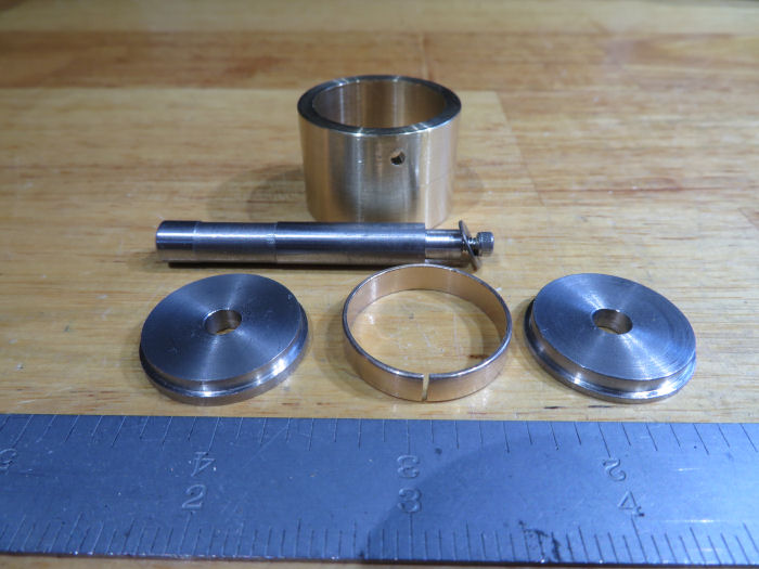

As mentioned in the first post, last week I did some experiments with the piston ring setup for the pump before heading off to Indy for the weekend. I obtained a few off-the-shelf cast iron piston rings, also dug out some scrap bronze and brass pieces to test things with. The iron rings would work, but are too narrow so would have to put two side by side to cover the port properly. Thats do-able, though not as great with the brass cylinder.
Other experiment was with the bearing bronze for the rings. I turned a couple rings to test with, as well as a section of 'cylinder' to fit it to. The bronze was turned to size, guessing at the thickness at first, and trimmed it to the width shown in my CAD model. You can see the 'port' in the cylinder wall for it to pass over, as well as the two piece piston head and the piston rod in this picture:

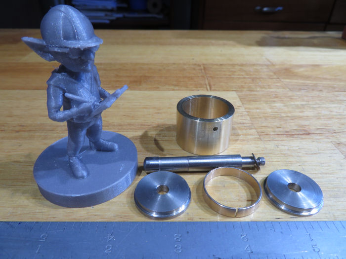

The shop elf trainee took some notes on the dimensions of things, including the ring diameters before and after cutting the ring with a jewelers saw:
His notes:

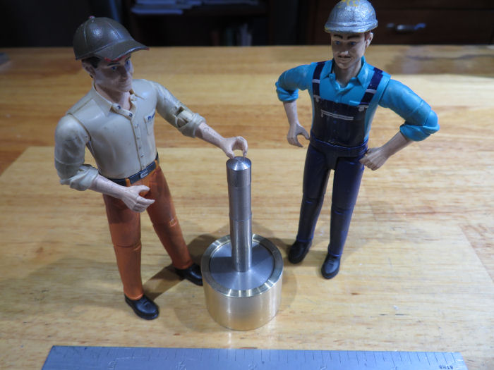

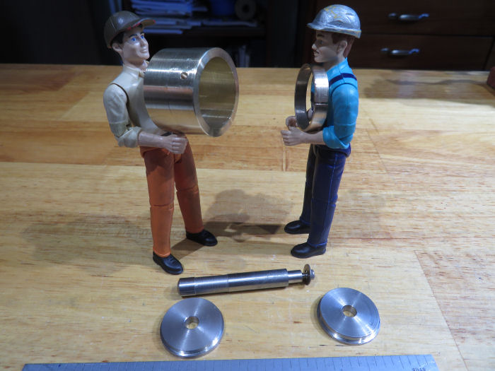

The shop elves took over at that point and got the ring fitted to the cylinder. The ring and bore were trimmed so that the ring would just fit in, with the gap just closed for a good seal.

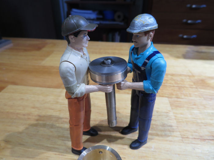

then assembled the piston
and test fit it to the cylinder. Fits well, seals well - I could blow in the open end of the cylinder and move the piston. When covering the port, nothing leaked out there at one-lungpower-psi.
The piston/ring move smoothly, no scraping or galling on the cylinder, so I think I have a setup that will work for this engine when running it off the compressor. The actual piston bore will be larger for the model, but this was a good proof of concept test.

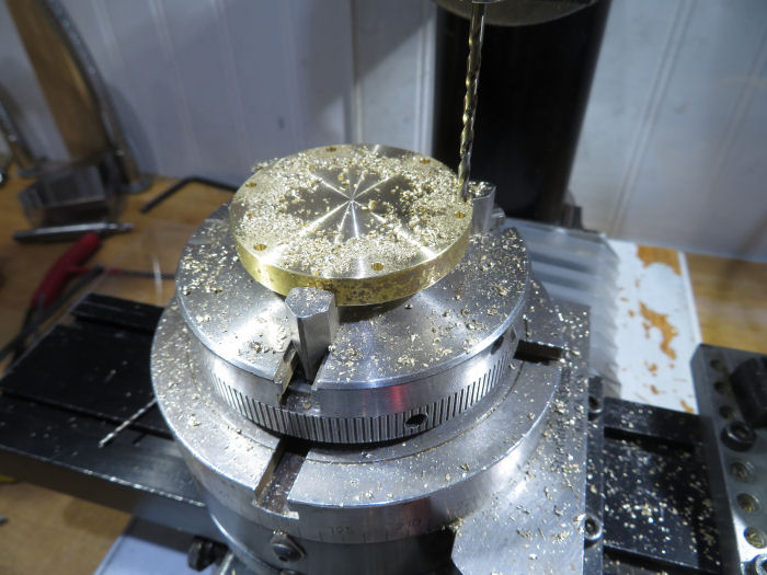

Got a start on the cylinder/center parts, cut the round bar and tubing to rough length. If you turn out some lights and squint hard, you can see the finished engine!   :Lol:
Then cycled them through on the lathe, trimming the end cap and cylinder ends to true the sawn ends. They are still not to final length. Also, drilled/tapped the holes for bolting the outer end caps to the cylinders. The same setup was used to drill holes in a faceplate, which will be used to hold the cylinders for further work.
The outer end caps also need more turning to take them to finished thickness and to put in the shape on the outside face.
