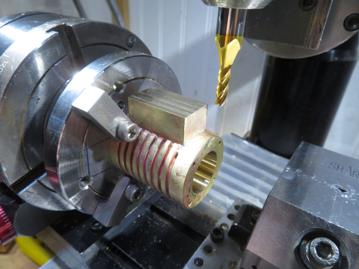

All seven cylinders have been bored out to size (3/4") and the faceplate was moved back over to the mill. First step is to take 0.058" off the tops of the steam chest bases to get them to the final height. This also flattens out the valve faces, which are never that flat on raw bar stock. So far two done, five more to go. The rotary table was still at  the same angle as when milling the recesses for the bases, and a scribe mark on the rotary table before removing the faceplate ensured that it went back on at the same angle as before. The faceplate will be left there until all the drilling/milling steps are done on the valve faces and bases.

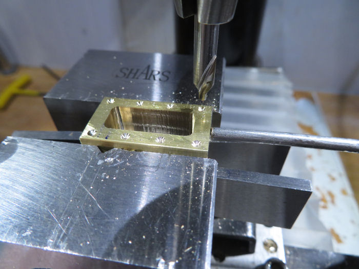

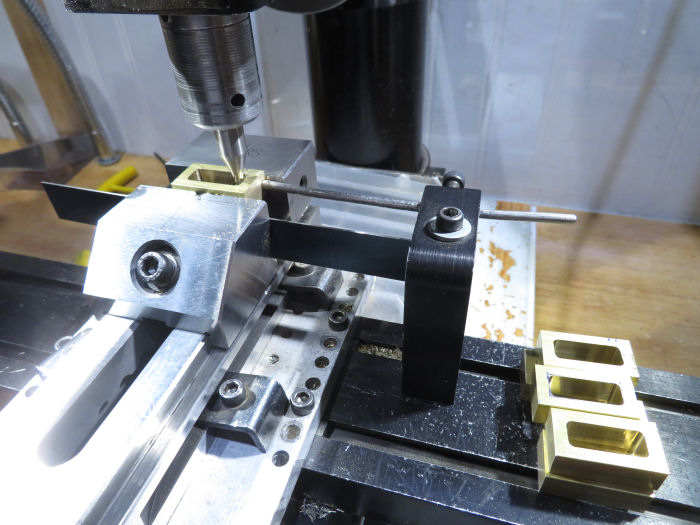

Before drilling the steam chest mounting holes in the bases, I wanted to get the chests themselves finished, just to double check hole spacing/wall thicknesses. So, I milled out the centers of the steam chests. Once the first opening was to size, and notes made on handwheel positions/number of turns, the rest went very quickly (that is my version of CNC - Count Number Cranks).
Then laid out the hole positions from the plans, all looks good so I can start drilling the chests and lids. The work stop gives me an indexable start position, so this will go pretty quickly as well.

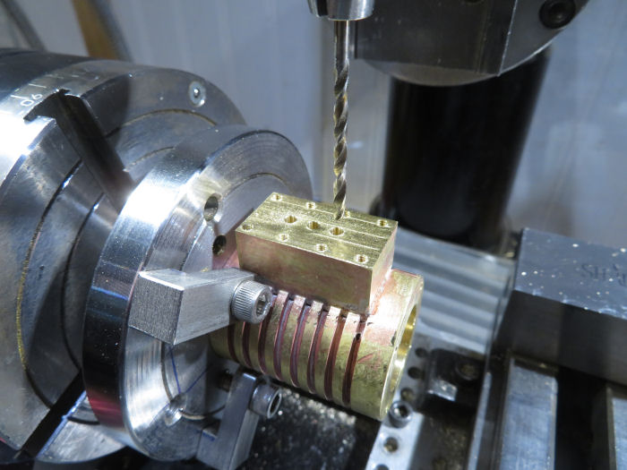

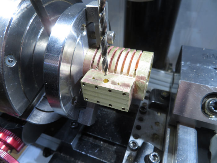

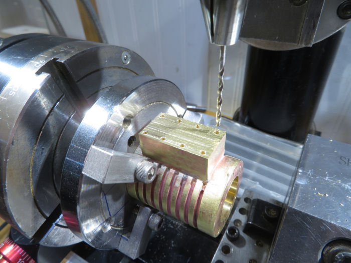

All the holes in the steam chests and covers for mounting them to the cylinder are drilled, then drilled the matching holes in all of the bases were drilled in the same pattern, just needed to establish the starting point in the corner of the bases...
Then turned the rotary table 90 degrees, and have started drilling the mounting holes and exhaust passages into the bases:

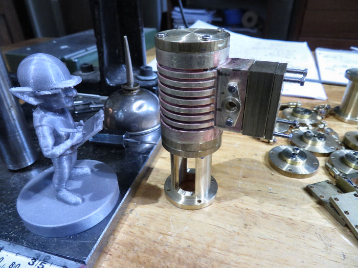

When the first cylinder was to that stage, I tapped all the holes (18 of them) in it, and test assembled everything to make sure it was all lining up. It has passed the elfspection:
so will finish up the exhaust passage/mount holes in the other six cylinders. After that, its on to drilling/tapping the flange/gland holes in the steam chests. Also need to tap all the holes in the rest of the cylinders - that will take a few sessions not to wipe out the fingers/wrists. The tapping stand helps a lot, but its still a lot.

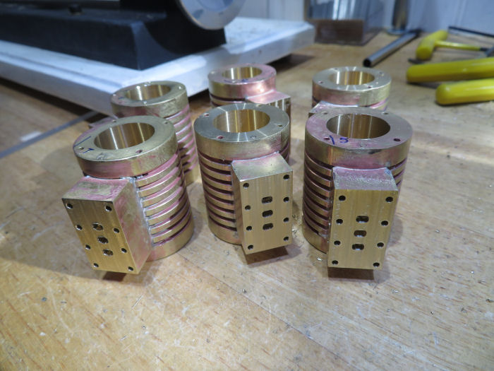

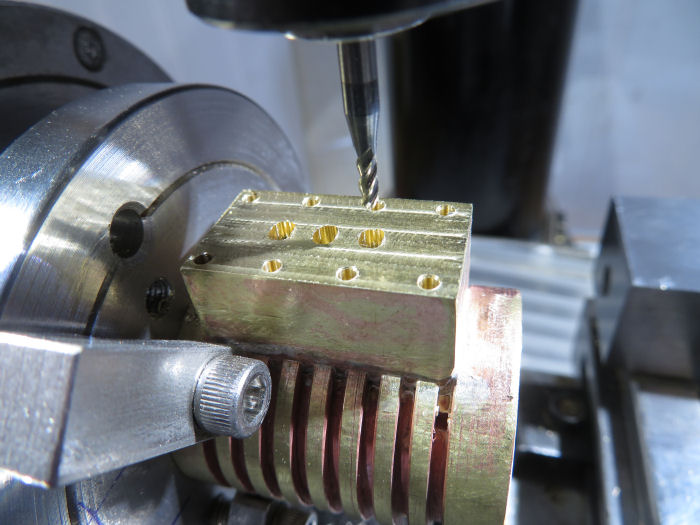

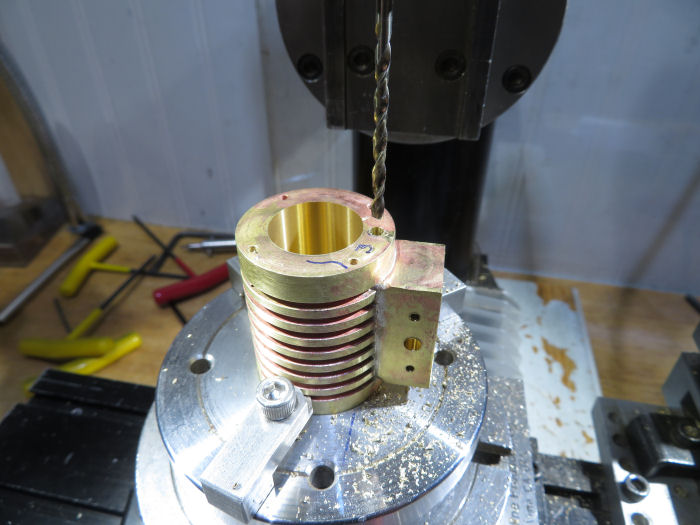

Got the rest of the cylinders drilled for the exhaust passage and pipe flange mounting, then started in on the ports. Got the first one all lined up and drilled starter holes for all three ports, slightly smaller than the finished port width. With this setup, went through and drilled the same holes in the other six cylinders. Seems like a lot, but once its set up and the handwheel advances known, each one only took a few minutes to swap in/drill/swap out.
With the starter holes drilled in all seven (middle port to meet the exhaust passage, end ports down to the level where those passages will be), then set up with a 5/64 end mill and took each one out to dimension, 0.1" tall and 0.15" wide. Again, repeated this operation on each cylinder in turn.
Here is most of the herd so far (last one is on the faceplate still)
Next up is to drill the passages in from the ends of the cylinders to meet the starter holes drilled down from the valve face. So far one cylinder is done.
