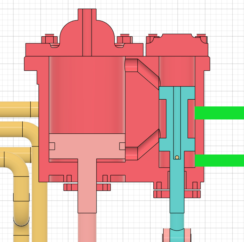

The neat thing about the mechanism is that its one eccentric per cylinder, with a spool valve that is switched between inside admission and outside admission to make it go forward and reverse. The center valve controlled by the operator swaps the steam/exhaust and also acts as the throttle. Really neat setup.

So does this engine use piston valves? to prevent valve lift when reversing the engine ?
The Soule Speedy Twin is the only D-valved engine I am aware of that uses a reversing valve, and the only way it can do this without valve lifting is to have a check valve built into the D-valve.
The Dake also had a reversing valve like that, but its internal construction prevented any valve lifting, since the valves are part of the inner piston.
  • Posts: 21212
Re: hello from London
« Reply #8 on: June 07, 2025, 05:17:43 AM »
Yeah, piston valves can be plumbed so the steam comes in either at the center, inside admission, or at the ends, called outside admission. Swapping between the two makes the engine run the opposite way. As you suspected, doing that with a d valve will cause the valve to lift. ThIs hoist engine has the same setup as the first steering engine I built. The same end result can be done with the double level/four port arrangement  that steam shovel slew/crowd engines used, which is how I am making my current steering engine. Its amazing how many different valve arrangements have been invented over the years.
Just looked back at the drawing in the first post, the valve shown there is the control valve that the operator lever moves. Its also a piston valve, lookes a lot like the cylinder valves.

Chris. I take it that the valve is sectioned along the length of the engine, would I be right in thinking that if sectioned across the engine it would show tow flanges each side so a total of 4 outlets. The top to for outside admission and the lower for inside admission of steam and the pair not feeding steam then carry the exhaust?

Nothing that complex, looks very like a D valve setup as for the passages. Here is a cross section of what my steering engine model was:
The green pipes on the right are the two incoming pipes from the control valve - one would get steam, the other takes the exhaust, depending on how the control valve was moved. The yellow dot at the middle of the spool valve indicates holes in the valve spool so the two ends are connected. If the steam comes in the pipe in the center, its 'center admission', and in this diagram the steap would go to the lower end of the cylinder and make the piston move up. If the steam comes in the other pipe, then its 'outside admission' and in the postions in this diagram the steam would go to the top of the cylinder and push the piston down. Thats how it reverses the engine with just the one eccentric. Hope that helps?

Chris I was enquiring about the central valve that alters direction, not the actual piston valve which is no different to others I have made like the recent A J Weed.
It is the valve off to the right of your image that is connected to the green pipes and then mirrored for the other side of the twin engine.
