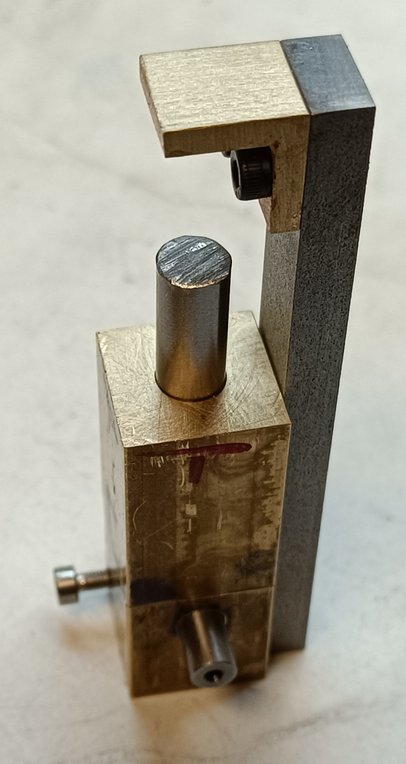

Finished off the guide bracket at the top, except for the 3mm hole - I'm waiting on a reamer for that (temp screws holding it). Faced the cylinder and valve blocks to length and reamed the hole for the valve.

Made the cylinder bore after spending far too long chasing the last 0.001" getting the block centred; every time I got within a gnat's whisker I managed to bump the DTI and had to start over. Ho hum. Anyway, it came out fine so now I can do the valve block spigot and other holes.

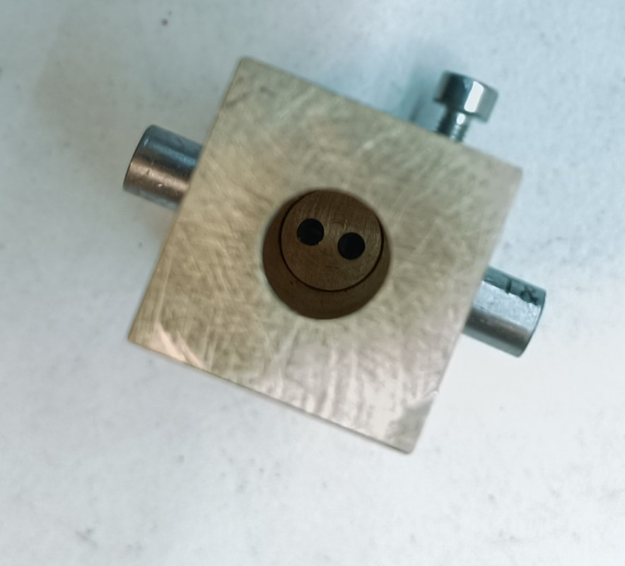

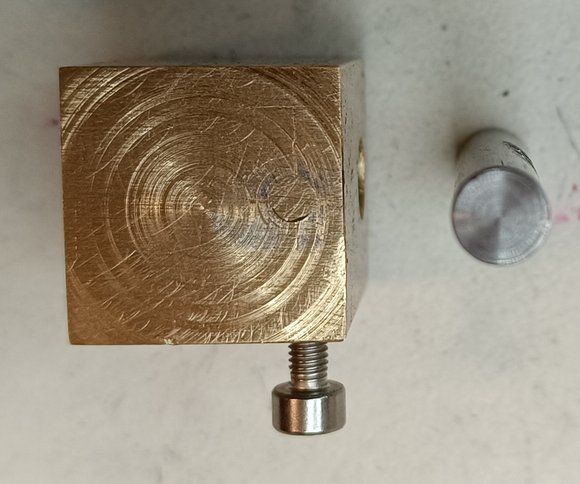

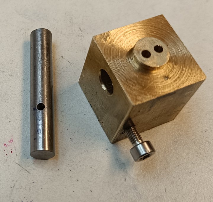

Spent quite a bit of time drilling and plugging the air passages in the valve and valve block this evening. There's little to see as most of it's hidden from view but after all that tedious drilling, dammit I'm going to post some photos  :Lol:
Here's a temporary screw in the air inlet hole with the admission and exhaust holes on top of the block. The hole in the valve is the inlet, there are two on the other side of it that lead to/from the cylinder.
Here's the plugged holes in the bottom of the valve block (easy to see) and in the end of the valve (not so easy to see  :Lol:)
Looking down the cylinder. The two holes are marginally off axis relative to the valve but I don't think it'll make any difference as I used the holes to transfer to the valve so that has the same error.
The bits placed in position showing the exhaust hole in the valve.
